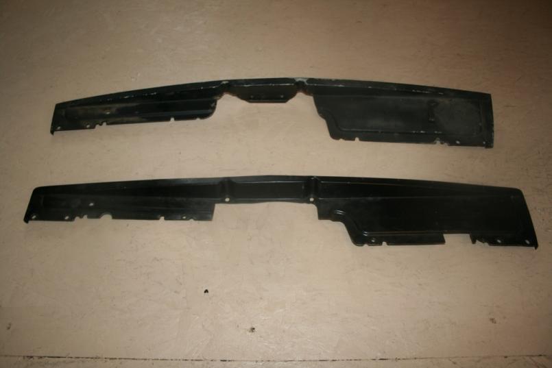

Question 1 - I have these 2 pieces. Both were supposed to be origional 914-6 sheet metal. They differ slightly, mainly in the center section. The length is the same, just looks different due to camera distortion. Whick one should I use?

mepstein 914-6 sheet metal questions Jan 8 2011, 09:48 AM

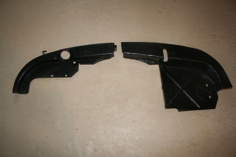

mepstein Question 2- I believe these pieces are not origion... Jan 8 2011, 09:51 AM

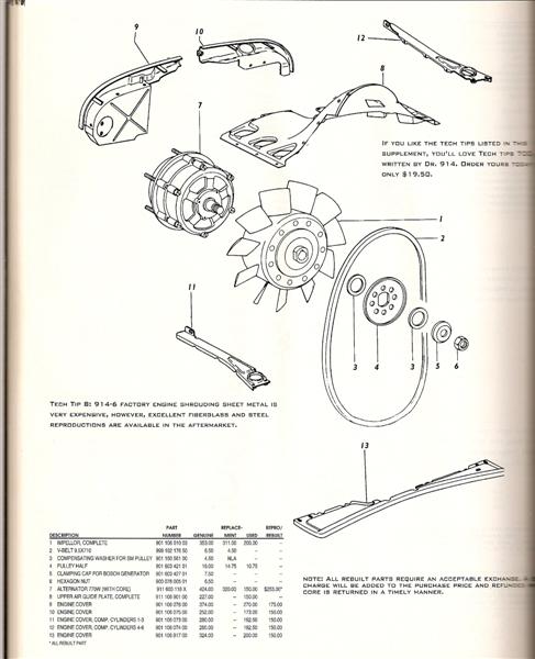

jt914-6 My factory six sheet metal from the rear...best pi... Jan 8 2011, 09:58 AM
jt914-6 The ones in your second post where they are two pi... Jan 8 2011, 10:05 AM
mepstein I think your getting my questions confused. The fi... Jan 8 2011, 10:09 AM
sixnotfour If you have a 72 or later -6 engine use the top lo... Jan 8 2011, 10:23 AM

jt914-6 914-6 sheet metal...rear splits in two pieces....o... Jan 8 2011, 10:26 AM
sixnotfour Also I think youre installing a 3.2 ?
You will h... Jan 8 2011, 10:38 AM

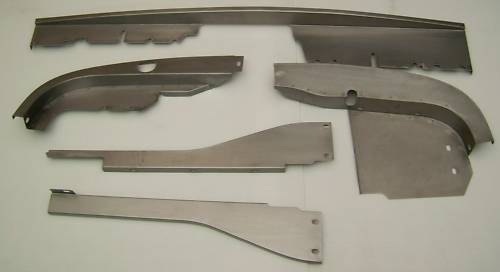

type47 914/6 engine sheet metal pix from ebay
