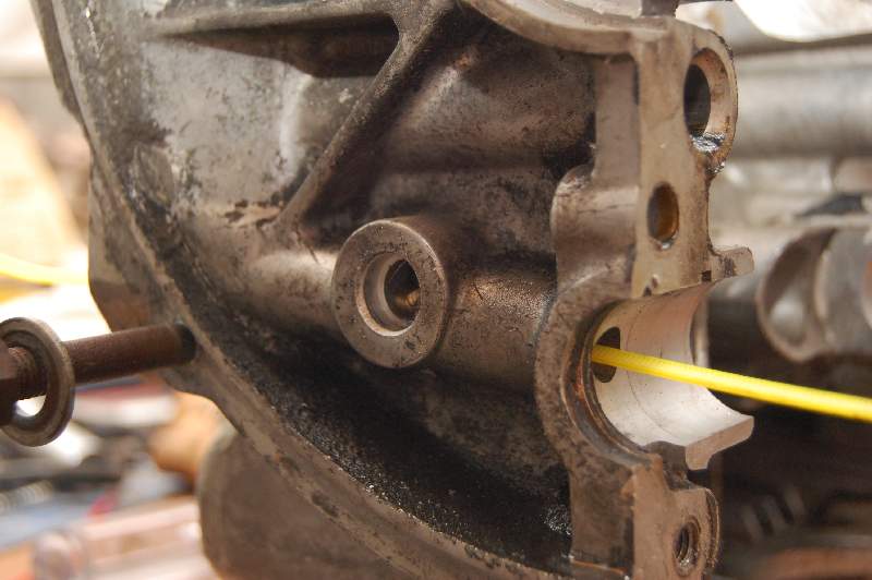

I decided earlier today to use a bus case for my rebuild. I had it laying around, it is a very nice case. I started to take the oil galley plugs out just like I have several times before on 914 cases. I ran into an issue that I hadn't on previous cases.
On the galley plug behind cylinder #1 near the flywheel side, there is a metal tube that runs from the rear cam bearing to the mechanical fuel pump boss. The tube blocks the galley and makes it so I cannot tap the hole. Since I am not running a mechanical fuel pump, can I just drill through the metal tube so that I can tap the galley hole?

You will need to remove the bronze bushing and tap it too.

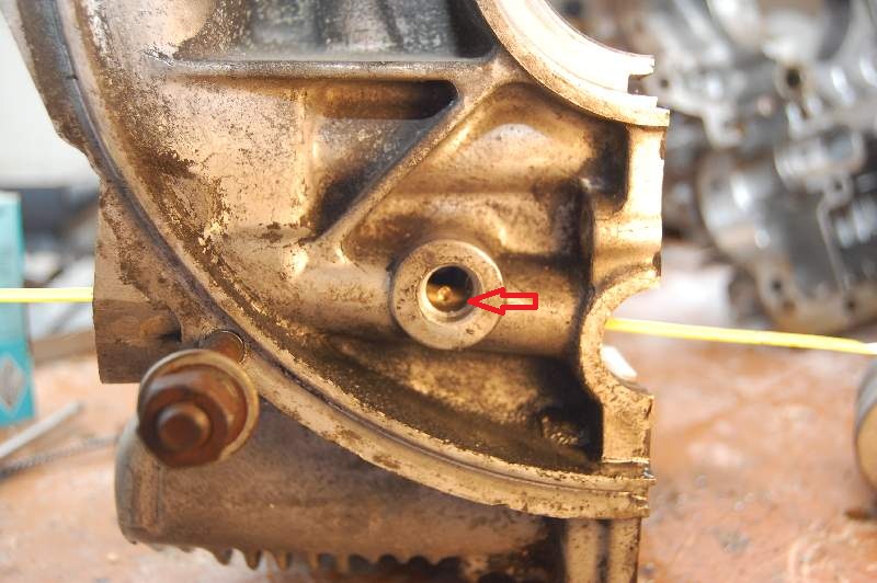

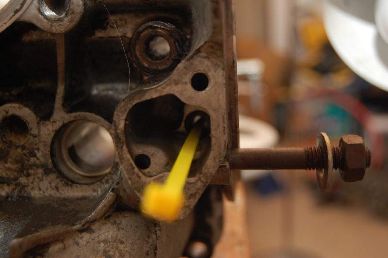

You can just punch the tube out. You have to tap and plug both sides (pic#2 and 3) of the pump rod hole. Then you must make a block off plate for the pump mount.
You also need a block off (on the other end) for the oil fill tube and you'll have to figure out a dipstick.

You should have read my article before you started. That plug didn't need to be removed since uts a fuel pump case.
As Mark states, yu'll have to tap both sides of this galley, else you'll have no oil pressure!
