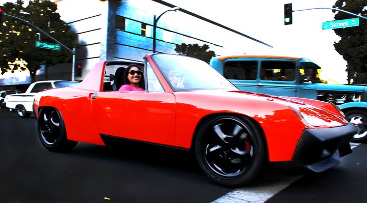

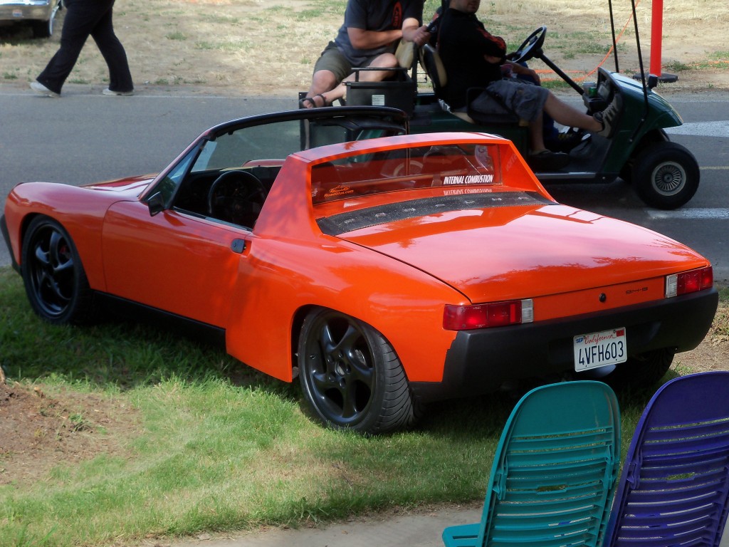

Welcome to my Audi Turbo 914 build thread! This first post has been highly edited for your(and my) ease of navigation.
(IMG:http://www.914world.com/bbs2/uploads/post-172-1428991066.jpg)
The car 1973 Porsche 914 1.7 w/ appearance group package
(IMG:http://www.914world.com/bbs2/uploads/post-172-1429499049.jpg)

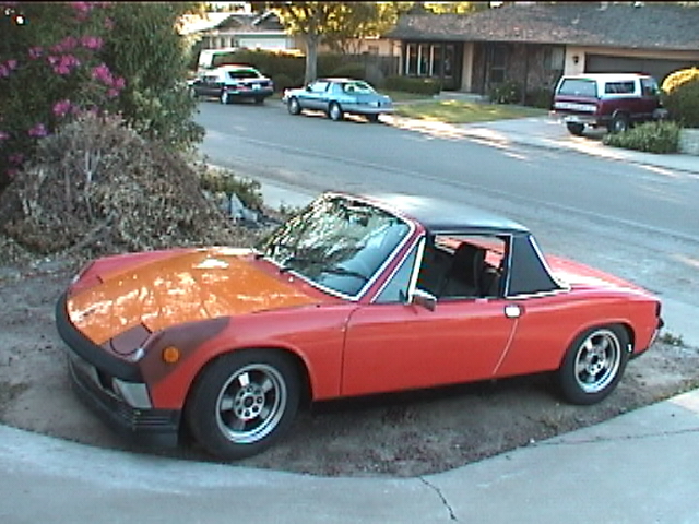

The Story:
I purchased this car when I was 14years old and had bought 2 other 914s with it for a measly $1100, The other 2 914’s were basket cases and one had been in a roll over. The previous owner put the 2.0 from the roll over car in this car. I parted out the other two cars and DID A V8 CONVERSION on mine after I couldn’t figure out how to adjust the valves (It seemed easier..). I do a 5 lug conversion as well as put some fiberglass flares on the car and many other things before I decide to paint the car. That is the start of this thread.
(IMG:http://www.914world.com/bbs2/uploads_offsite/i1210.photobucket.com-172-1295463716.1.jpg)
Next I decide that I don’t like how the v8 drives and how I could never keep it cool so I decide to embark on a journey with an engine I was already more familiar with. The Audi 1.8T.

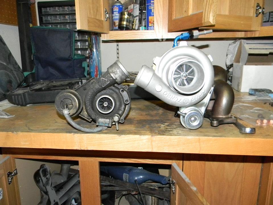

Turbo: Comp Turbo triple ball bearing CTB5356

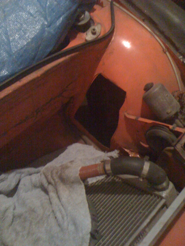

Radiator cutouts in wheel well (And replace hood with stock) ***Completed 1-26-11***

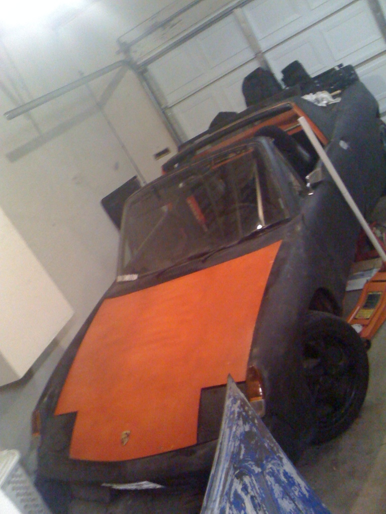

After
(IMG:http://www.914world.com/bbs2/uploads/post-172-1307803321.jpg)
(IMG:http://www.914world.com/bbs2/uploads_offsite/i719.photobucket.com-626-1307840091.1.jpg)
(IMG:http://www.914world.com/bbs2/uploads_offsite/i719.photobucket.com-626-1307840092.3.jpg)
(IMG:http://www.914world.com/bbs2/uploads_offsite/i719.photobucket.com-626-1307840093.4.jpg)

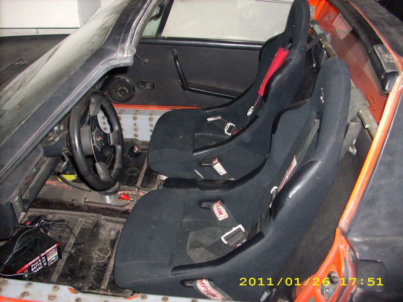

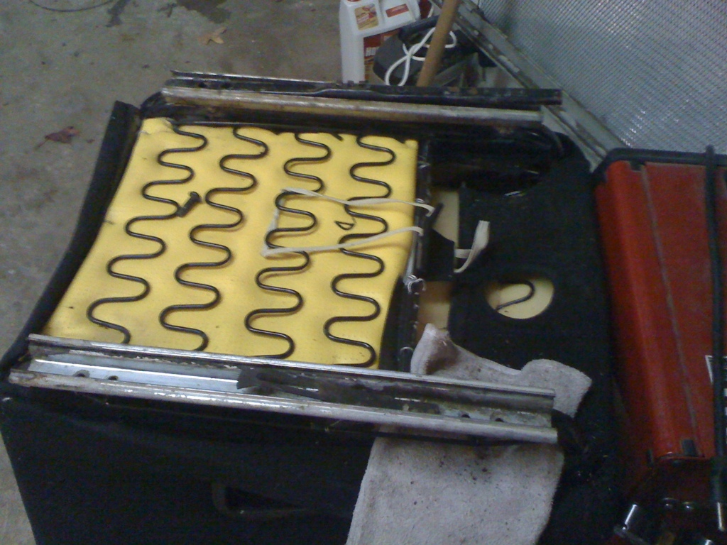

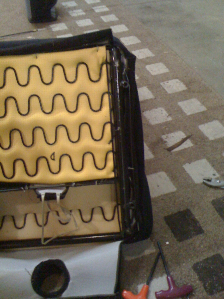

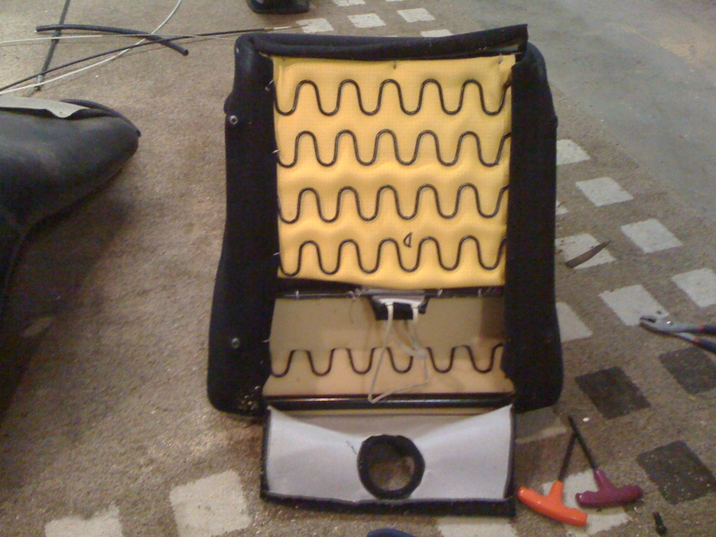

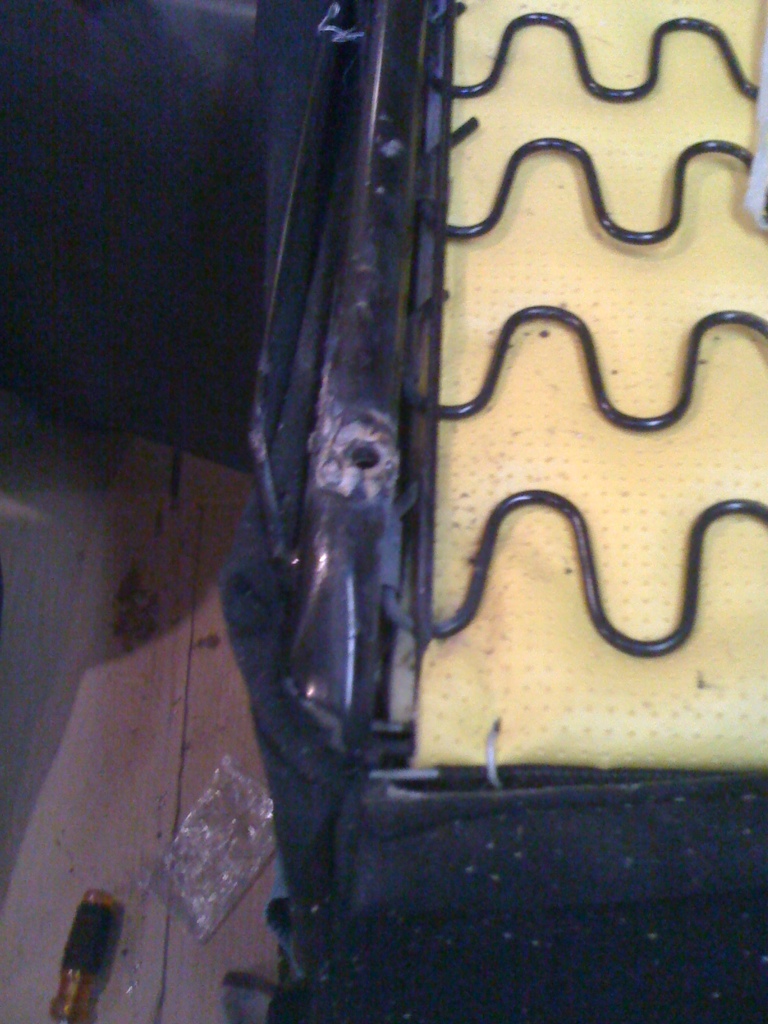

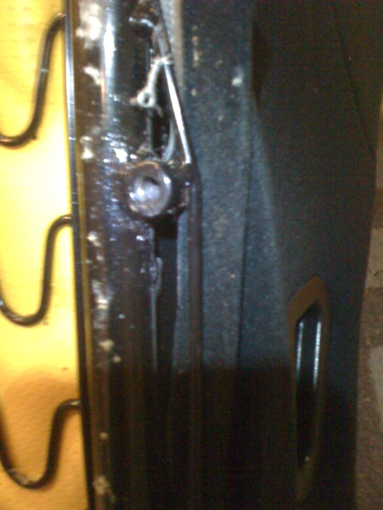

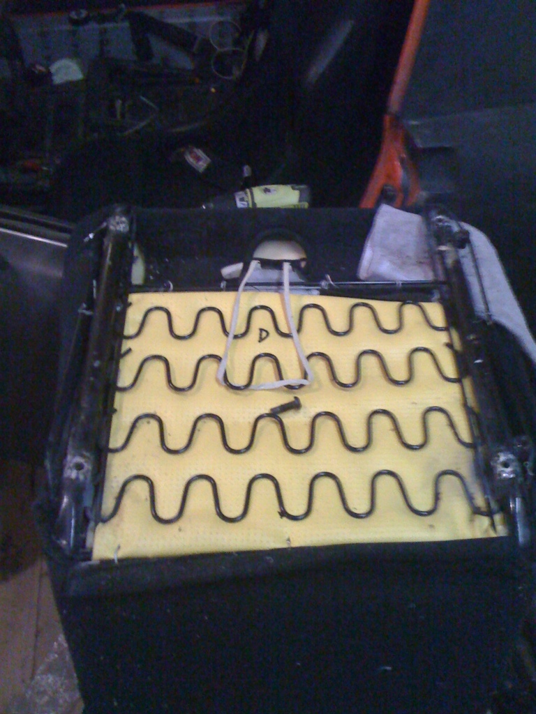

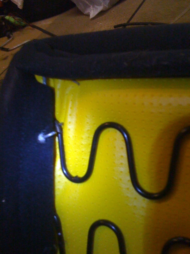

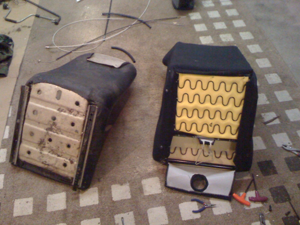

Got some progress done on the Pass side seat.
The drivers side seat I mounted with the provided sliders and removed the 914 bracket alltogether. The passenger seat where height isnt as big of an issue, I customized the seat mount and rewelded the mounting holes to use the 914 seat. Similar to rdauenhauer's in my "Pep Boys Seat" thread (link in first post).
Almost finished the seat, but I couldnt find my step bit for enlarging the holes on the 914 slider, I tried ovaling them out but ran out of time. Tomorrow maybe?
Here is a pic of the results and a link to the pictures.
(IMG:http://www.914world.com/bbs2/uploads_offsite/i1210.photobucket.com-172-1295508287.1.jpg)
(IMG:http://www.914world.com/bbs2/uploads_offsite/i1210.photobucket.com-172-1295508288.2.jpg)
(IMG:http://www.914world.com/bbs2/uploads_offsite/i1210.photobucket.com-172-1295508288.3.jpg)
(IMG:http://www.914world.com/bbs2/uploads_offsite/i1210.photobucket.com-172-1295508289.4.jpg)
(IMG:http://www.914world.com/bbs2/uploads_offsite/i1210.photobucket.com-172-1295508289.5.jpg)
(IMG:http://www.914world.com/bbs2/uploads_offsite/i1210.photobucket.com-172-1295508289.6.jpg)
(IMG:http://www.914world.com/bbs2/uploads_offsite/i1210.photobucket.com-172-1295508290.7.jpg)
(IMG:http://www.914world.com/bbs2/uploads_offsite/i1210.photobucket.com-172-1295508290.8.jpg)
http://s1210.photobucket.com/albums/cc411/...14/914/1-19-11/

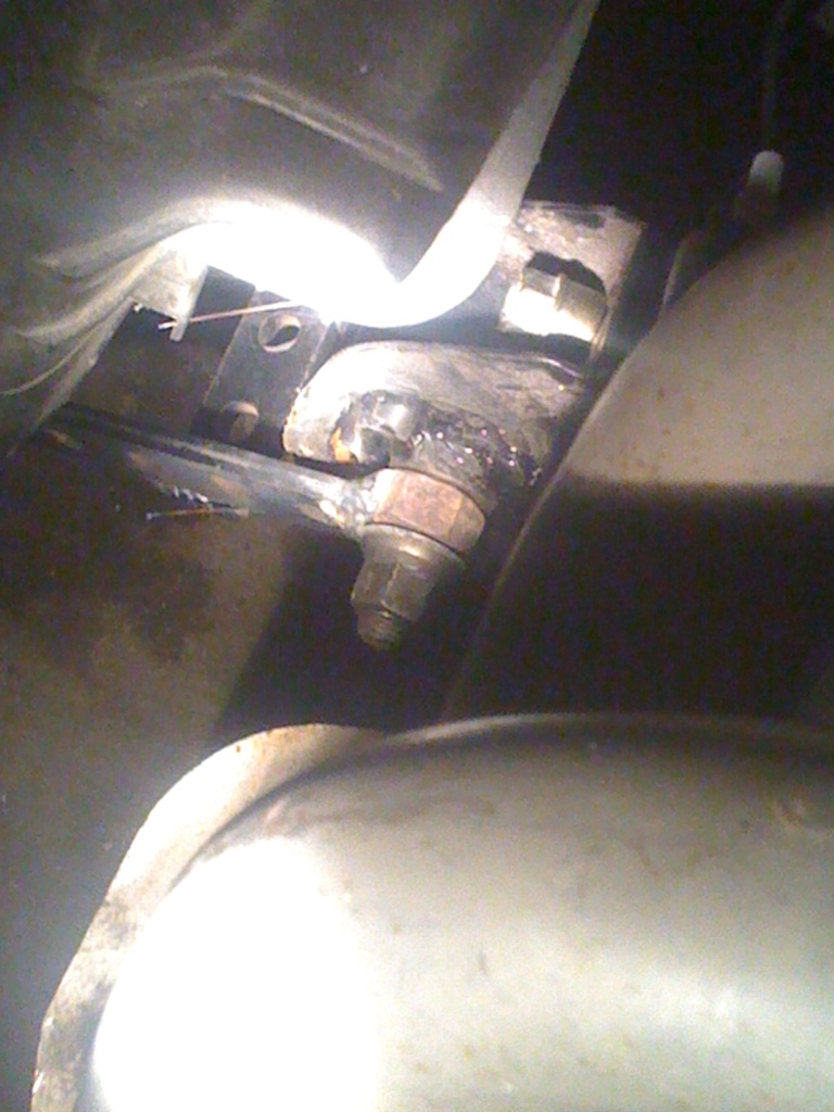

No progress tonight on the 914, however I did spend way to much time installing a front motor mount on the CRX.
The car has traction bars (PO) and the traction bars didnt give any provisions for a front motor mount.
Been driving the car for months without a front motor mount and changed all the other motor mounts, but still the motor clunked around.
I got a front motor mount and have been meaning to install/weld in provisions for it but never got around to it. After installing my garage door a couple weeks ago I just happened to stumble upon some 1" x 3/16 extra bar that I could use. So scouring the bolts and modifying the incorrect front motor mount so it fit, I spent about 3 hours and got it all welded up. (ran out of welding wire as well...)

Finished the seat install!! I actually did most of the remaining fitting and reworking during lunch and got to the point of bolting it on before I had to leave lunch. I bolted it on when I got home and took a gratuitous pic for yall! Interior is starting to come together slightly! Just need to order (or make...) a carpet kit now.
(IMG:http://www.914world.com/bbs2/uploads_offsite/i1210.photobucket.com-172-1296105787.1.jpg)
Next on the list was the water pump came in! So I jacked up the rear and put it on stands. Unfortunately I havent put in a drain petcock in the lowest point of the water system yet.... So I tried to pull one of the hoses off, but I could only get it open just a little bit with a screwdriver and let it drain.. In the meantime Dad brought over my stock hood and we decided to get to cutting the wheel well out. Couldnt find a template or anything to go off of, so I just started cutting (IMG:style_emoticons/default/sawzall-smiley.gif)
(IMG:http://www.914world.com/bbs2/uploads_offsite/i1210.photobucket.com-172-1296105400.2.jpg)
Passenger side is smaller and both sides need finish touch up, but i'll get that finished when i do the bodywork on the hood. We installed the original hood and relined it up the best we could.
