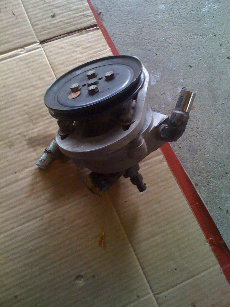

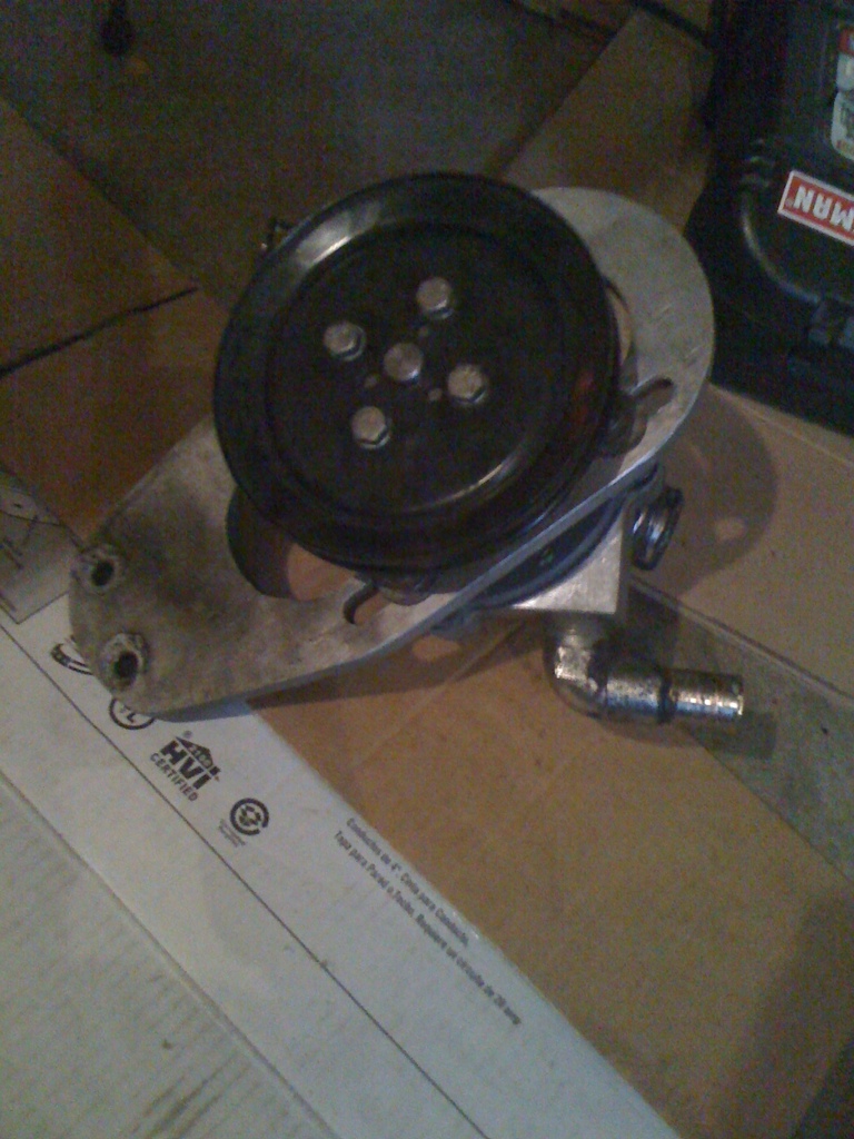

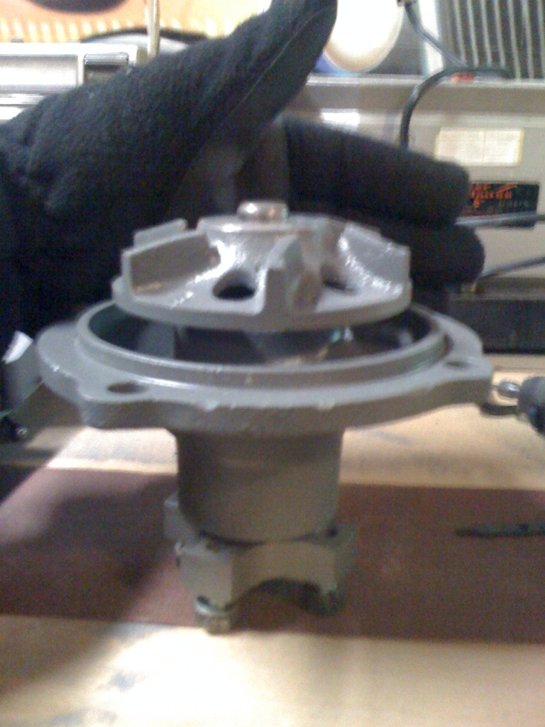

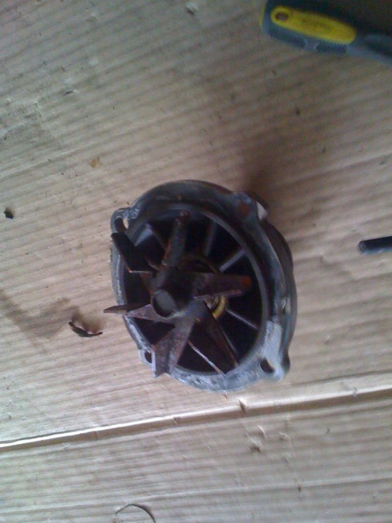

Progress from today!
Finished removing the water pump. Looks like the old one was still pretty good! Oh well, I prefer this other design anyways.
Hopefully i can remember how the housing sits, I cant remember right now... The lines should help me figure it out though.

It looks like nothings wrong with that pump. Most Mopar pump use thinner stamped steel blades. What's the plan with the pump?

Replace it anyways. Its the pump that came with my kit and i was unsure of its condition. Ill just replace it with the cast unit and keep the old unit as a spare.

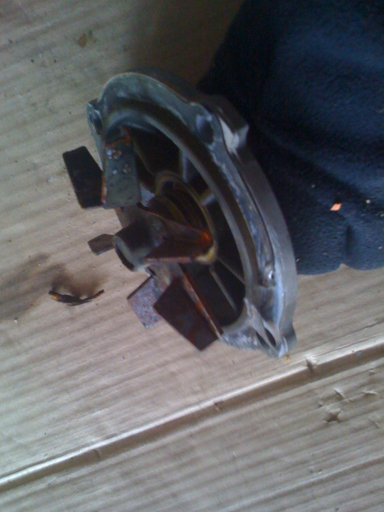

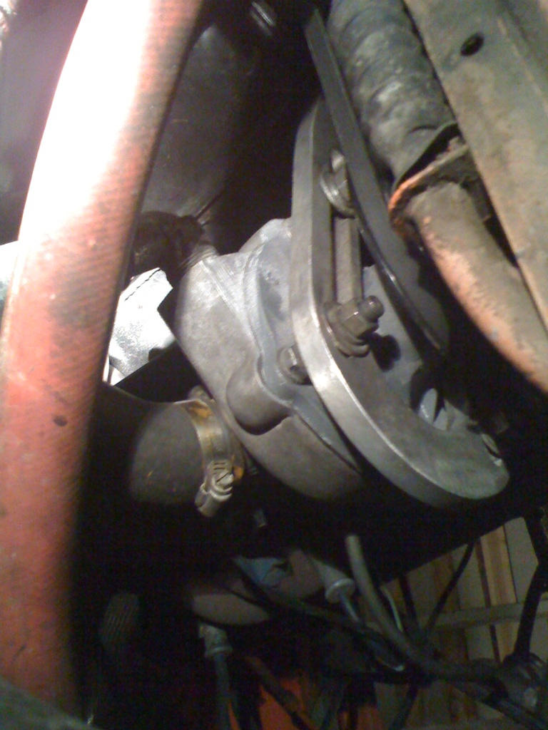

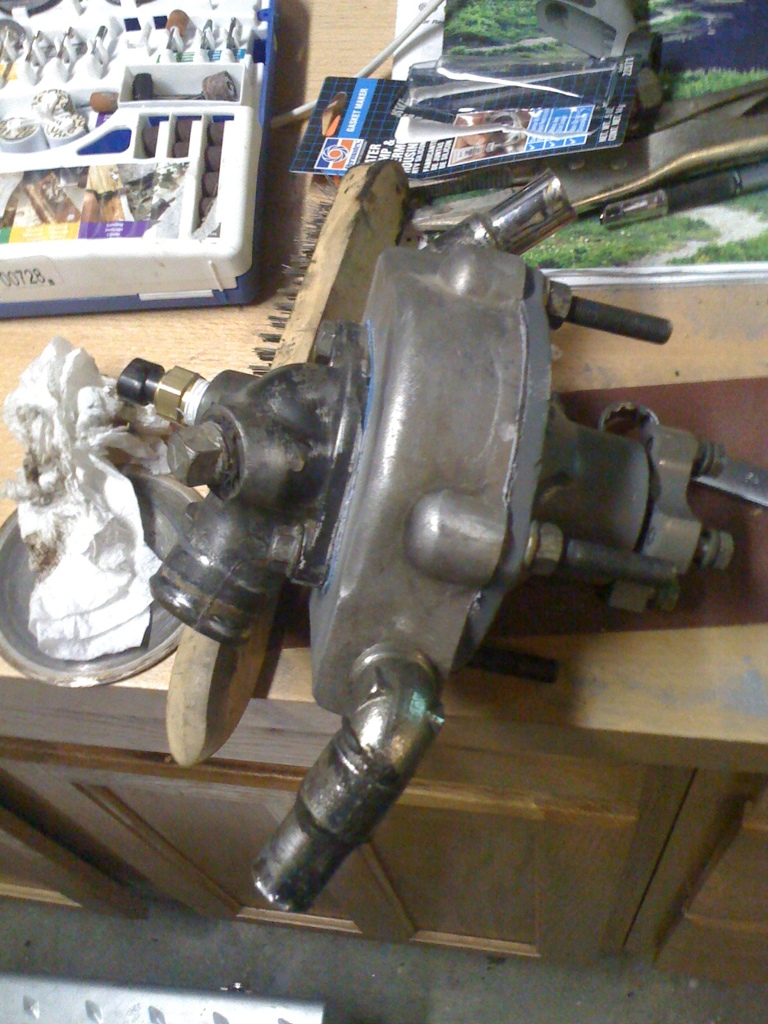

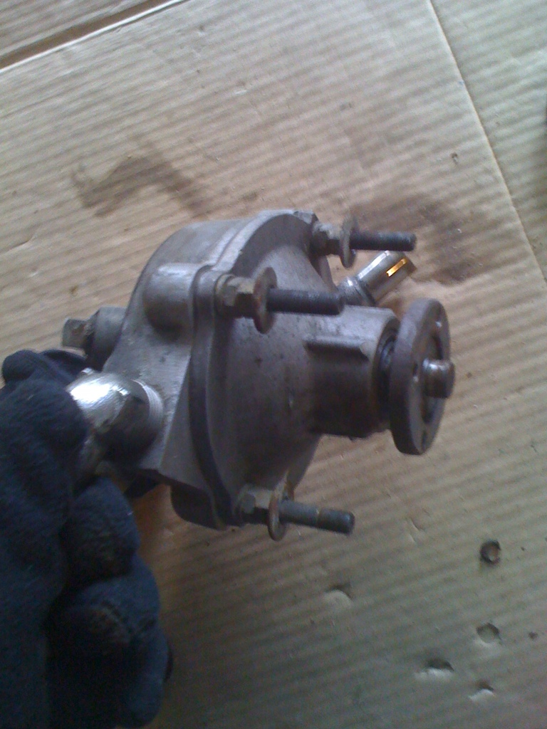

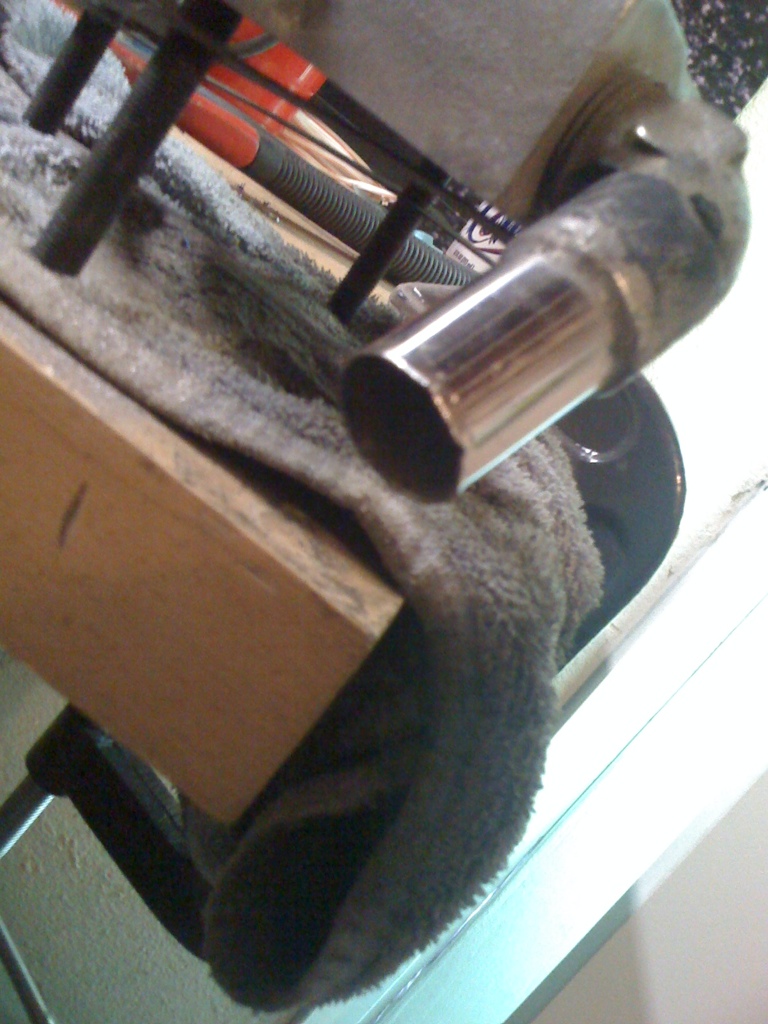

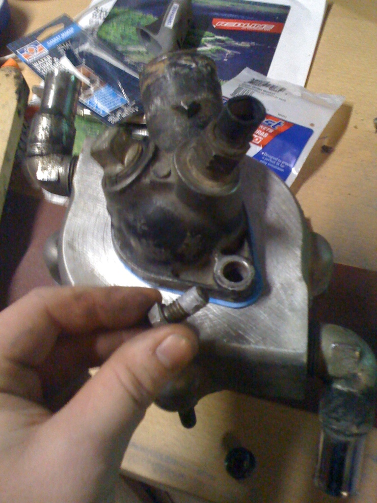

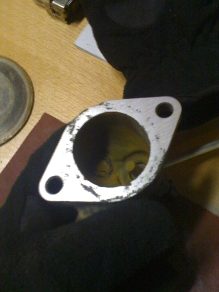

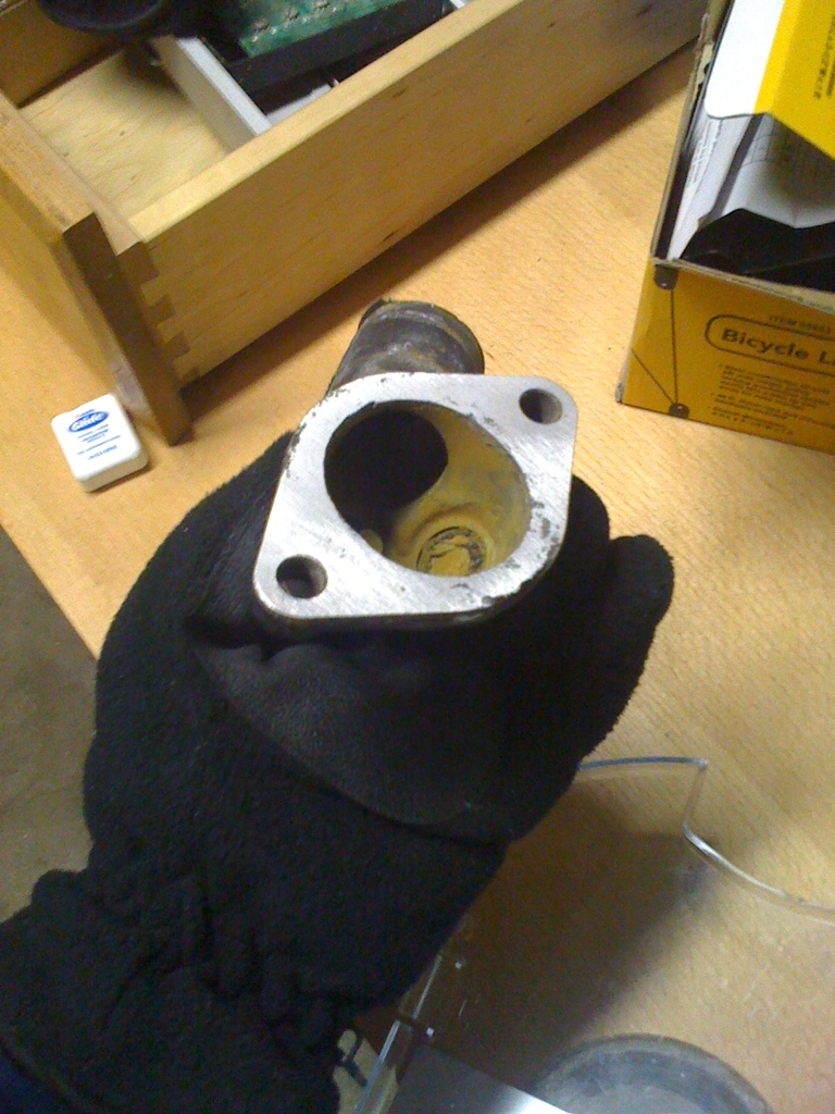

Progress so far today. Been working since 9am, unfortunately things would have gone a lot easier if the water pump wasnt giving me problems the whole time... I shall explain..
(IMG:http://www.914world.com/bbs2/uploads_offsite/i1210.photobucket.com-172-1296353169.1.jpg)
First off I took off every piece so that I could clean everything for reinstall, This piece above was pitted really bad so I took some sand paper on the flat work bench and sanded it down, but as you can see this is about 1/2 way through.
(IMG:http://www.914world.com/bbs2/uploads_offsite/i1210.photobucket.com-172-1296353169.2.jpg)
Here is where I said F~ it, its good enough.
(IMG:http://www.914world.com/bbs2/uploads_offsite/i1210.photobucket.com-172-1296353170.3.jpg)

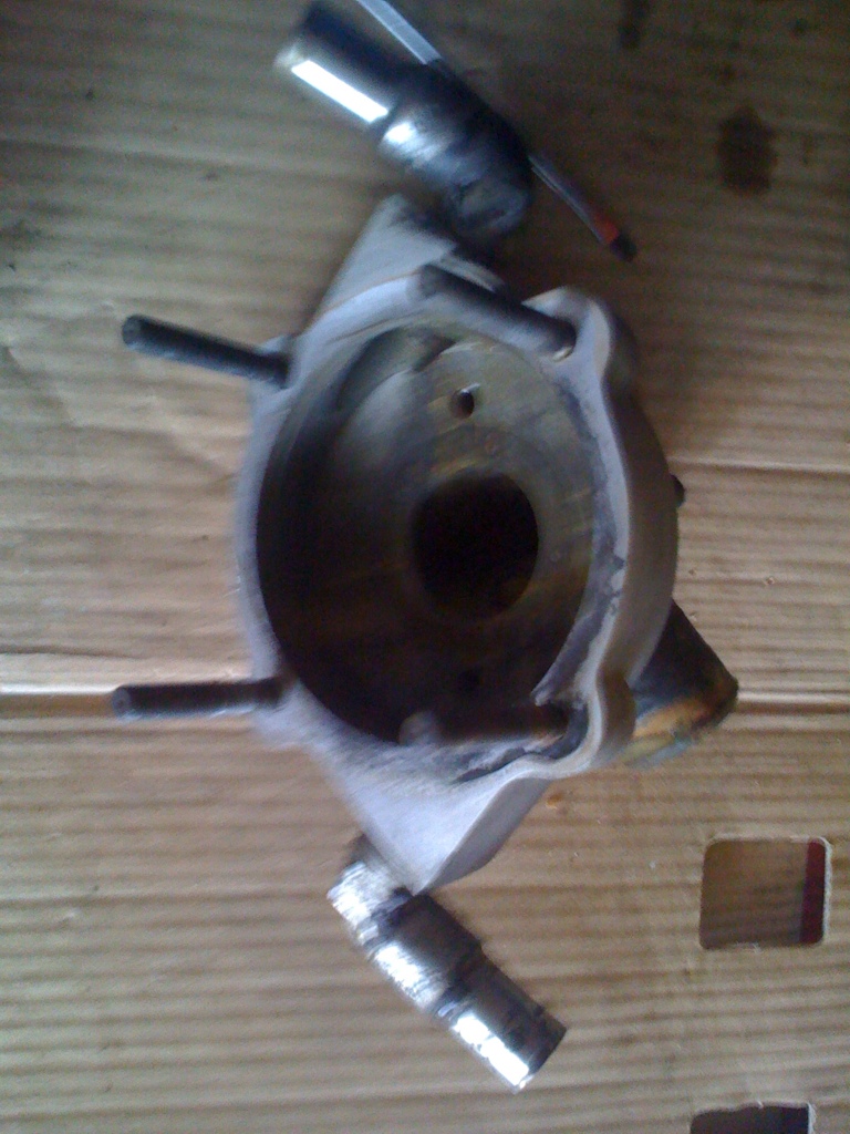

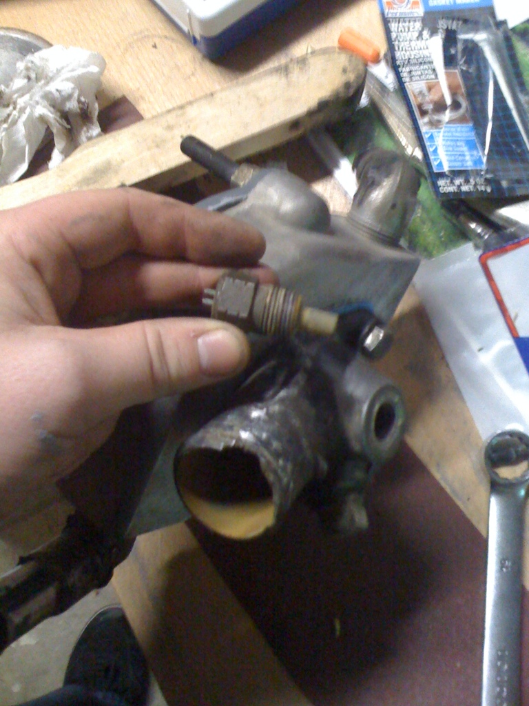

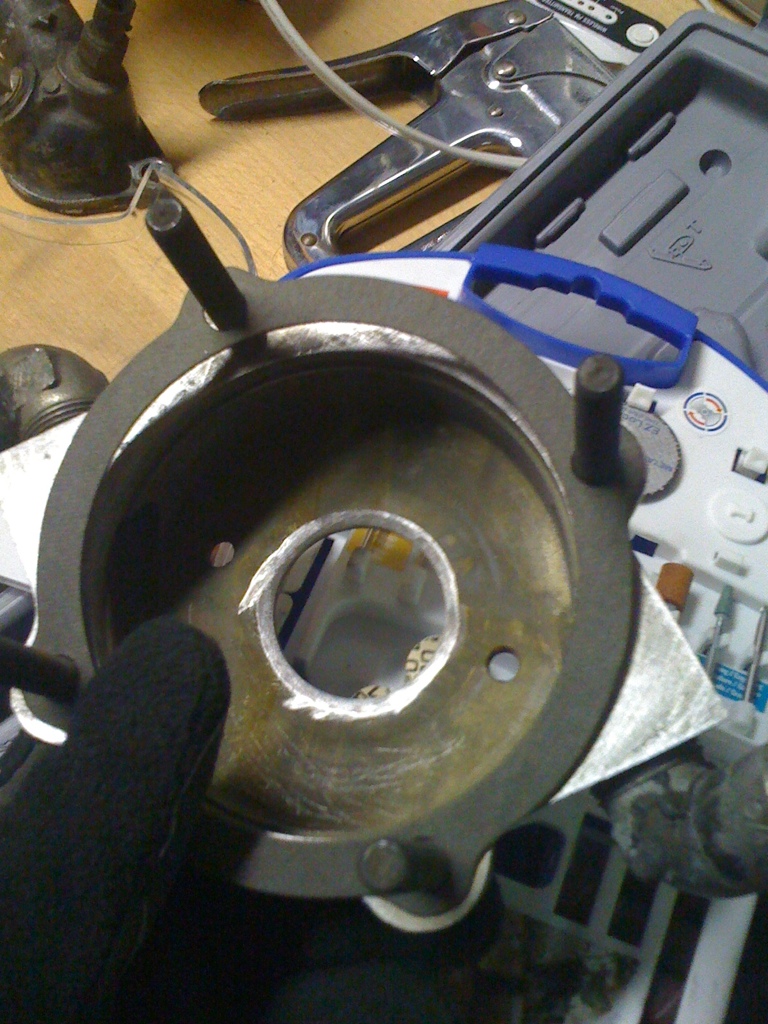

Then I started on the housing, and got it so it flowed a little better..
(IMG:http://www.914world.com/bbs2/uploads_offsite/i1210.photobucket.com-172-1296353170.4.jpg)
I then went and said OK and put sealant and gaskets and buttoned everything up. However I never checked to see if it spun... This would cause me 2 hours searching for another gasket later... Then when I put the pully on I noticed it didnt spin. Shit. Took it apart and noticed that there was a step in the housing and it caused for the impeller to touch the
housing.. So about an hour or more of grinding on the housing and a little of the impeller it finally fit.
(IMG:http://www.914world.com/bbs2/uploads_offsite/i1210.photobucket.com-172-1296353171.5.jpg)

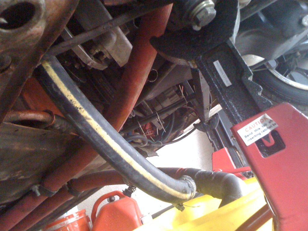

I decided to put a couple of lips on the pipes to prevent slipage. I also took the dremel and ruffed it up as well(not in photo).
(IMG:http://www.914world.com/bbs2/uploads_offsite/i1210.photobucket.com-172-1296353171.6.jpg)
Threw on some silicone on the treads as the bolts go directly into the housing.
(IMG:http://www.914world.com/bbs2/uploads_offsite/i1210.photobucket.com-172-1296353171.7.jpg)
This had silicone on them that had hardened completely (probably 15 years old or more) and needed the impact gun to break loose. Replaced thermostat (ECU thermostat).
So after finding a gasket (2 hours... no one likes MOPARs) I set to get everything back together. Took a couple of tries to get the water pump braket oriented correctly but finally I got it in and installed.
(IMG:http://www.914world.com/bbs2/uploads_offsite/i1210.photobucket.com-172-1296353172.8.jpg)
(IMG:http://www.914world.com/bbs2/uploads_offsite/i1210.photobucket.com-172-1296353172.9.jpg)
Completed unit
(IMG:http://www.914world.com/bbs2/uploads_offsite/i1210.photobucket.com-172-1296353173.10.jpg)
Installed
(IMG:http://www.914world.com/bbs2/uploads_offsite/i1210.photobucket.com-172-1296353173.11.jpg)

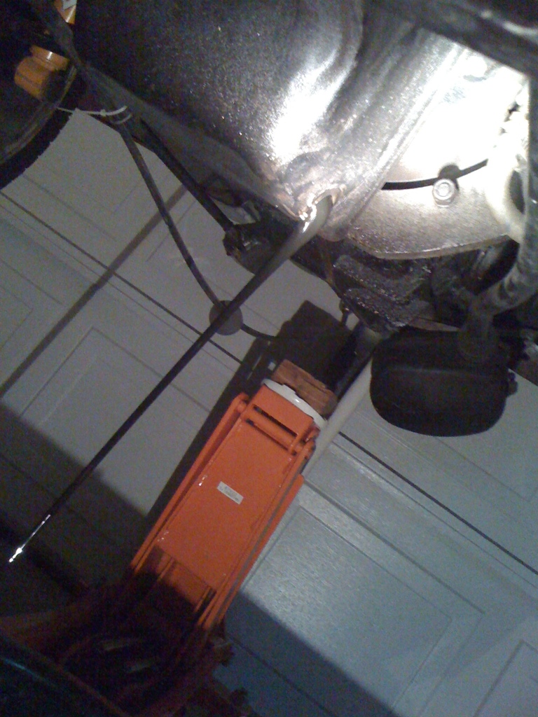

Oil changed (Left out drain plug... lost about 3 quarts... yay)
What to do next? I have all night.....

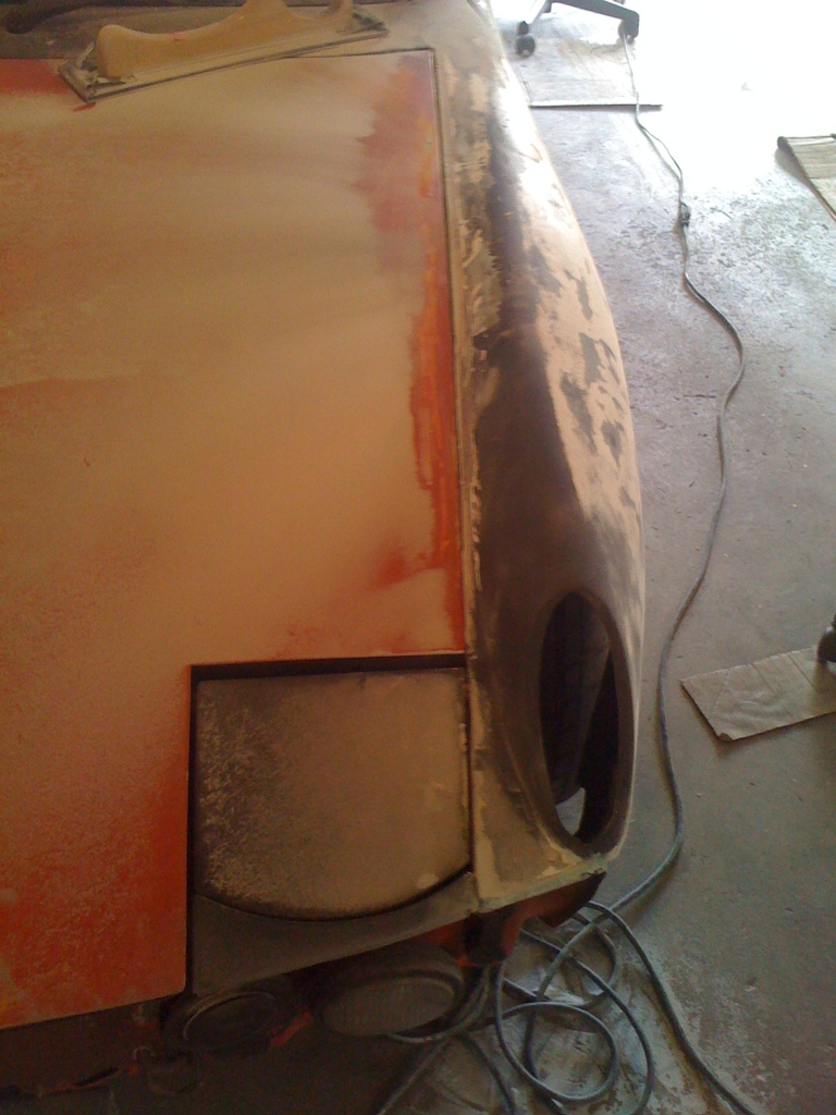

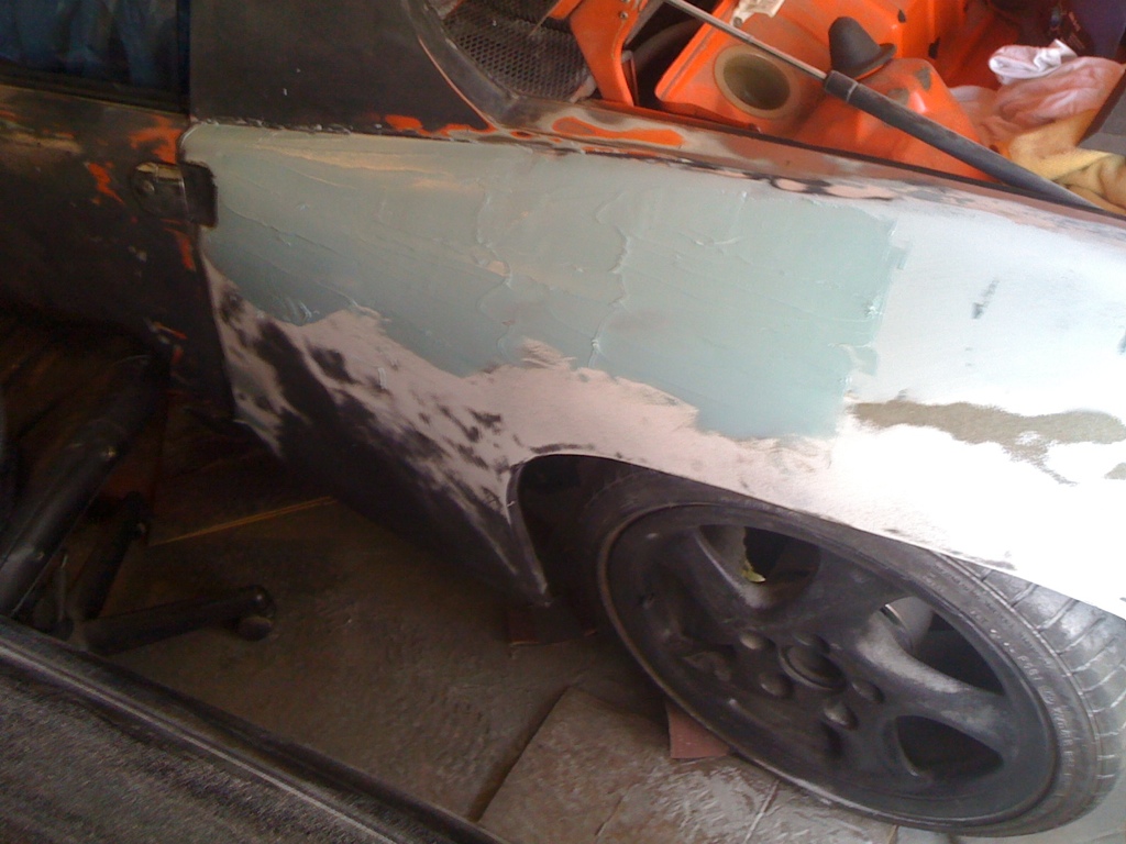

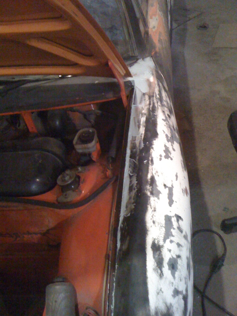

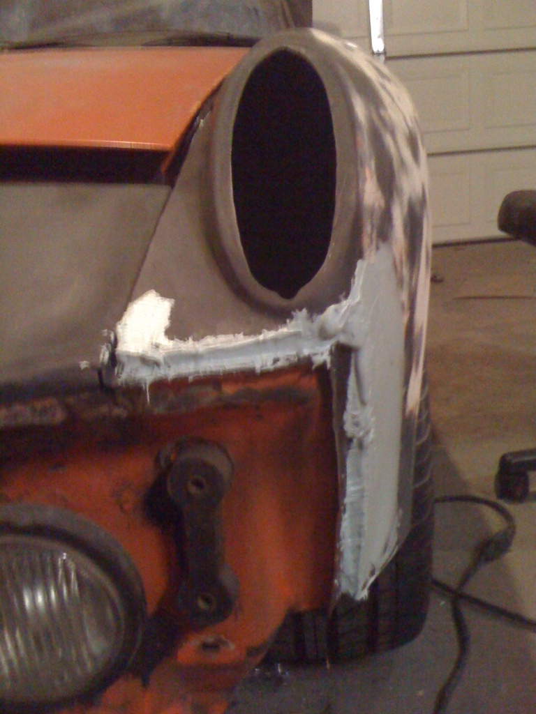

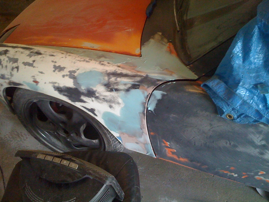

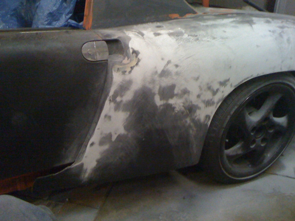

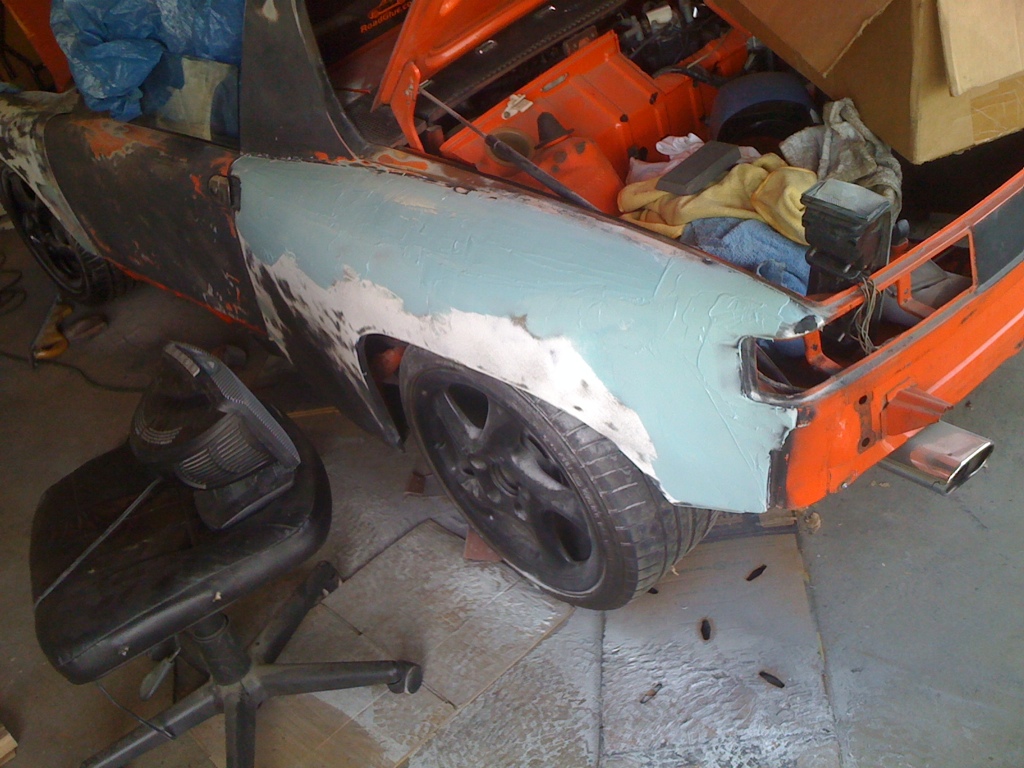

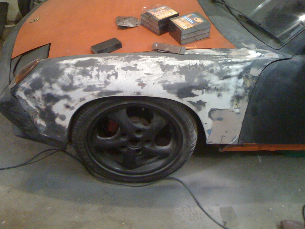

Bit the bullet.
Started ~ 8 finished ~ 11.
(IMG:http://www.914world.com/bbs2/uploads_offsite/i1210.photobucket.com-172-1296374877.1.jpg)
Needs some more bondo, really just needs a skim of glaze puddy.
(IMG:http://www.914world.com/bbs2/uploads_offsite/i1210.photobucket.com-172-1296374877.2.jpg)
Start
(IMG:http://www.914world.com/bbs2/uploads_offsite/i1210.photobucket.com-172-1296374878.3.jpg)

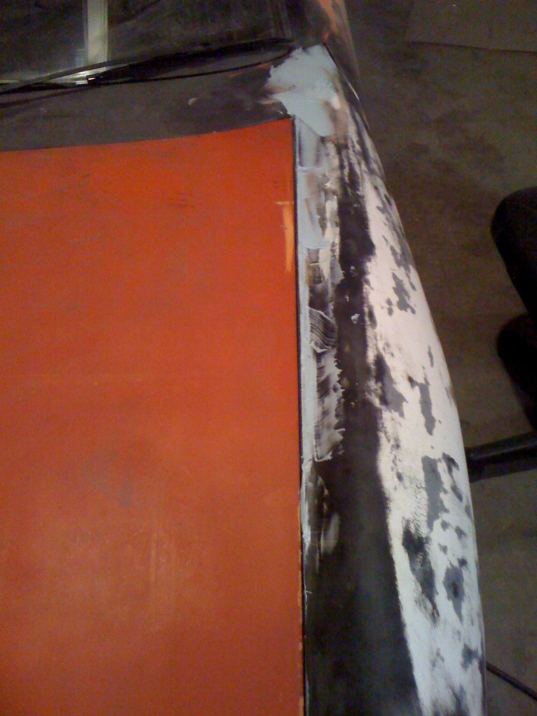

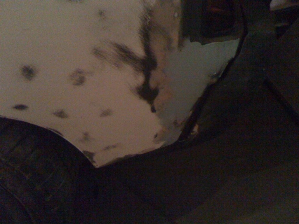

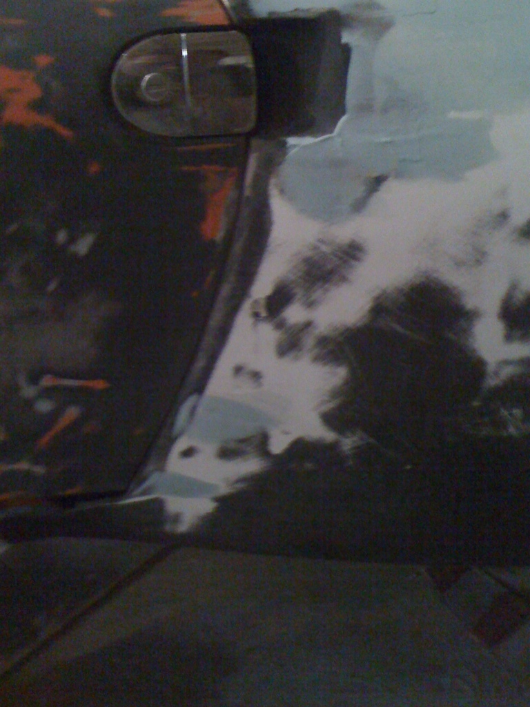

Fiberglass low area's poking through, time for primer filler then another run with the sanding block.
(IMG:http://www.914world.com/bbs2/uploads_offsite/i1210.photobucket.com-172-1296374879.4.jpg)

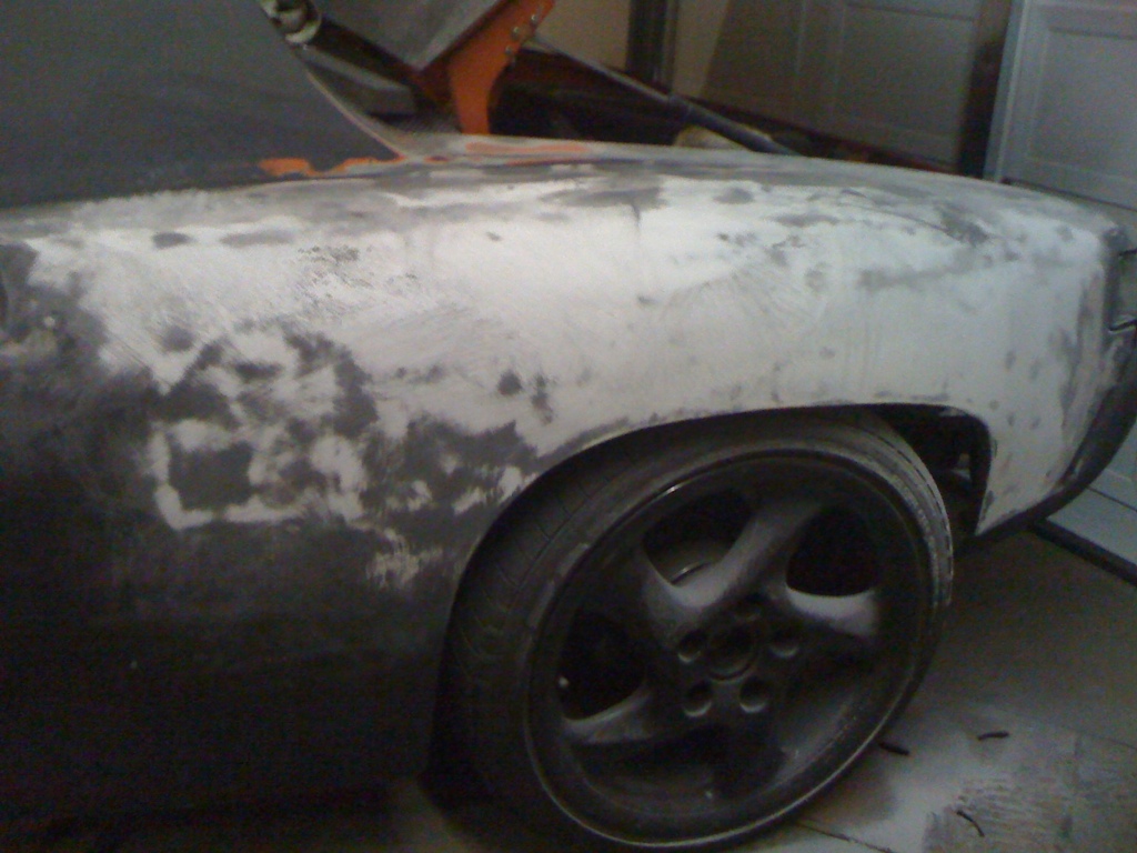

Getting better..
(IMG:http://www.914world.com/bbs2/uploads_offsite/i1210.photobucket.com-172-1296374879.5.jpg)

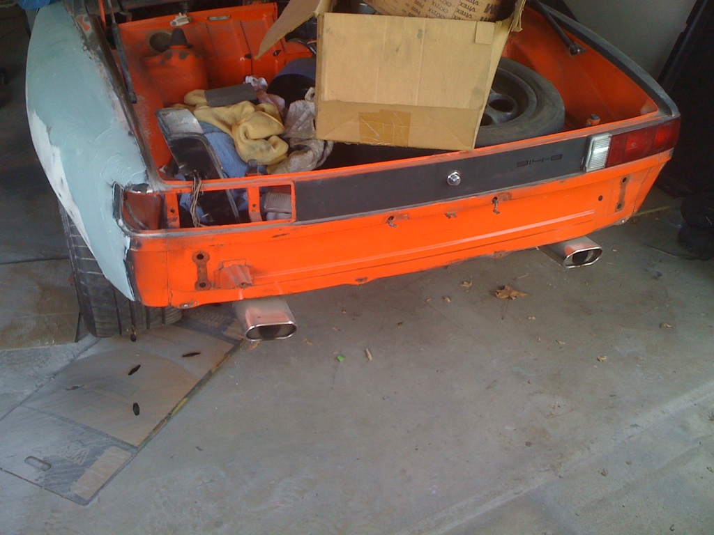

Need to reinforce the fender before I tackle more of this area, It should be pretty flat though.
(IMG:http://www.914world.com/bbs2/uploads_offsite/i1210.photobucket.com-172-1296374880.6.jpg)

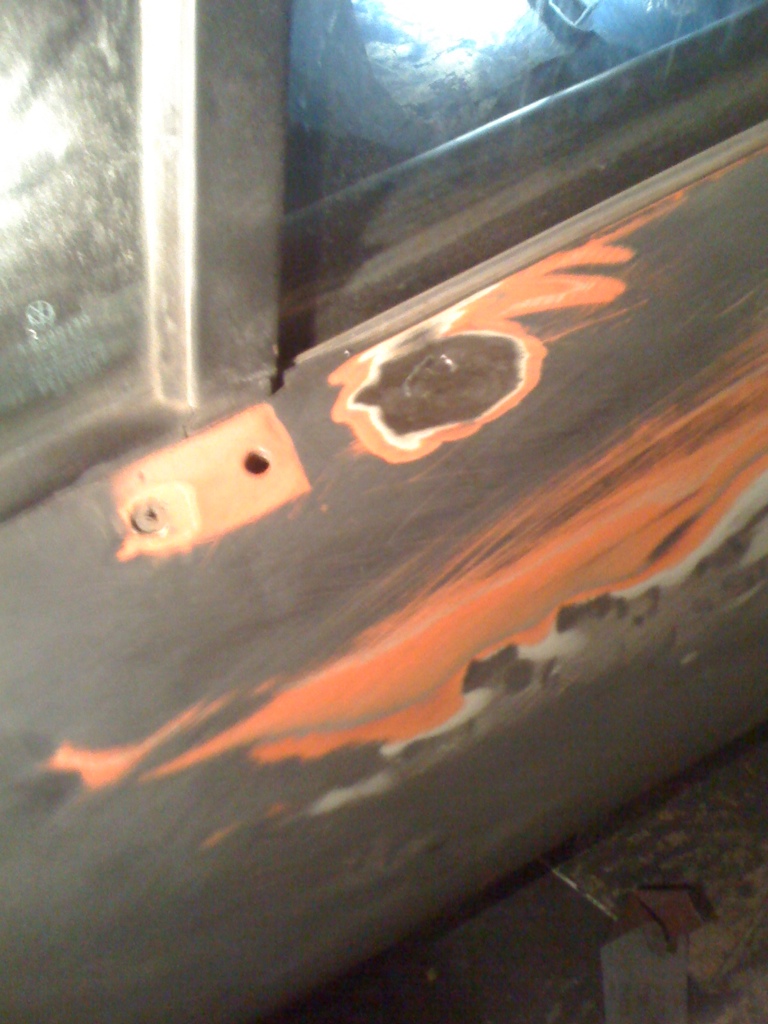

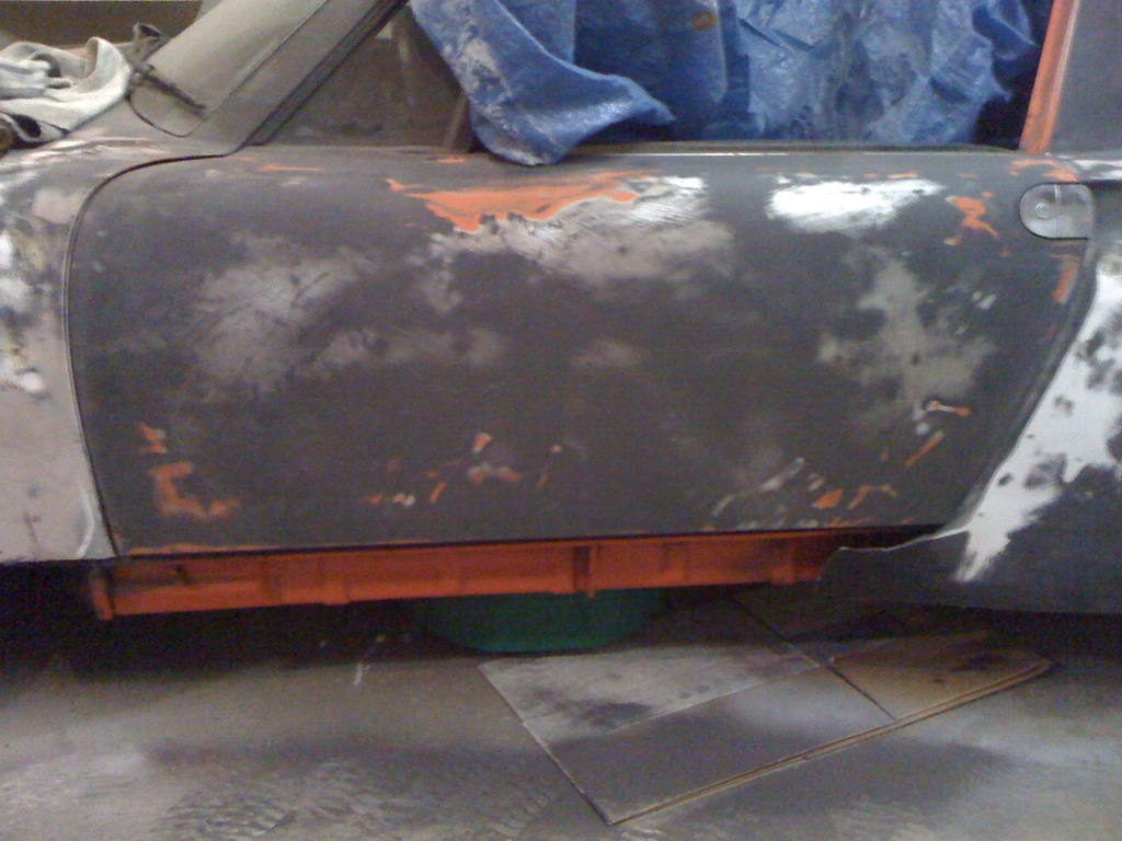

Next was the door. Needs primer filler.
(IMG:http://www.914world.com/bbs2/uploads_offsite/i1210.photobucket.com-172-1296374880.7.jpg)
3 hrs work... Need to get me some supplies! Tuesday afternoon I am free so i'll be tackling it more then with supplies in hand.

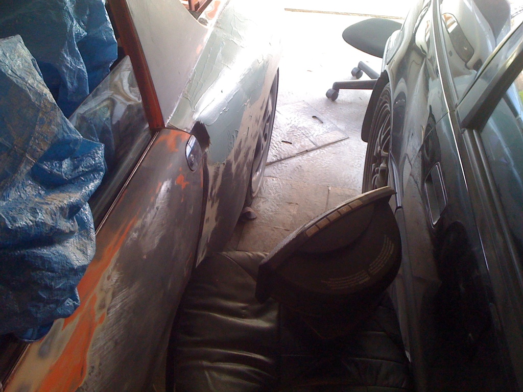

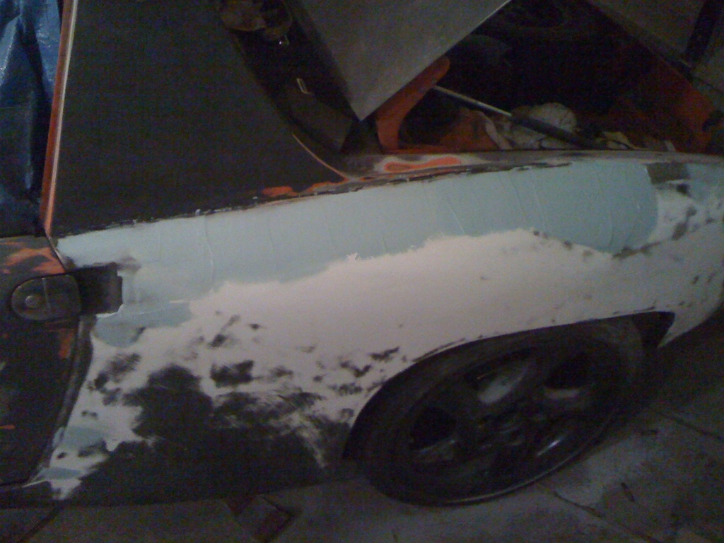

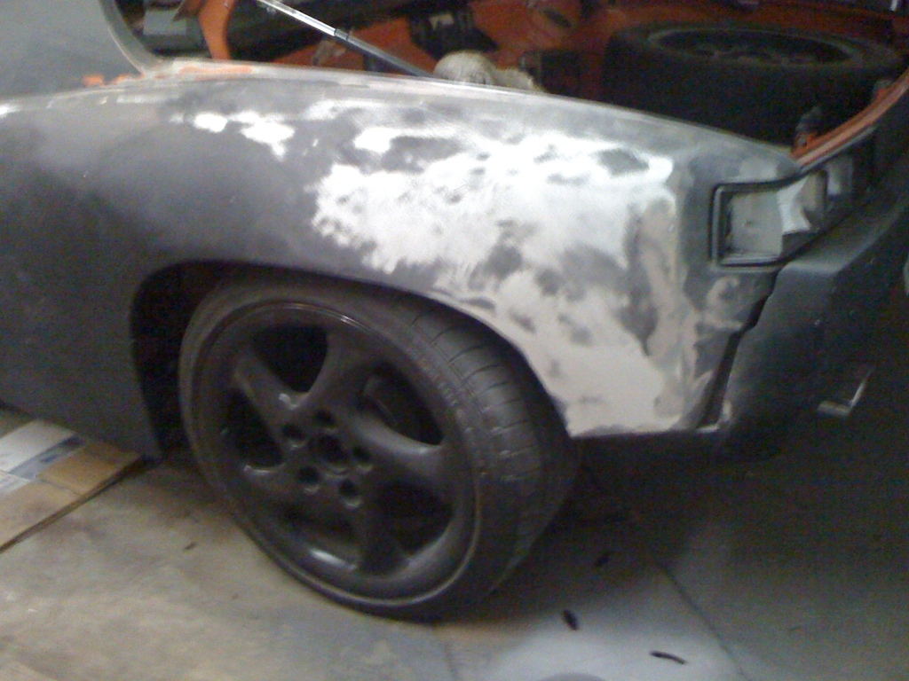

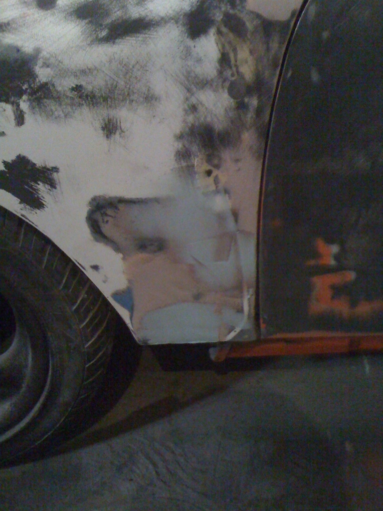

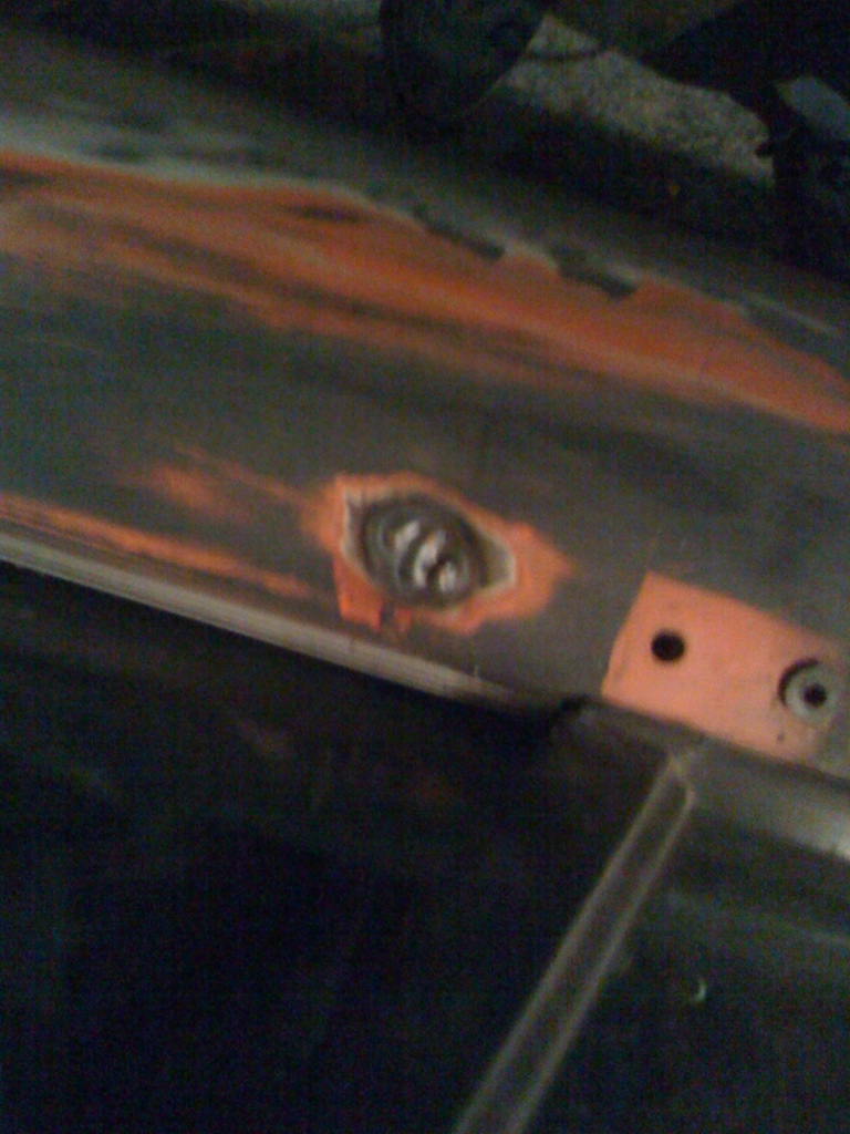

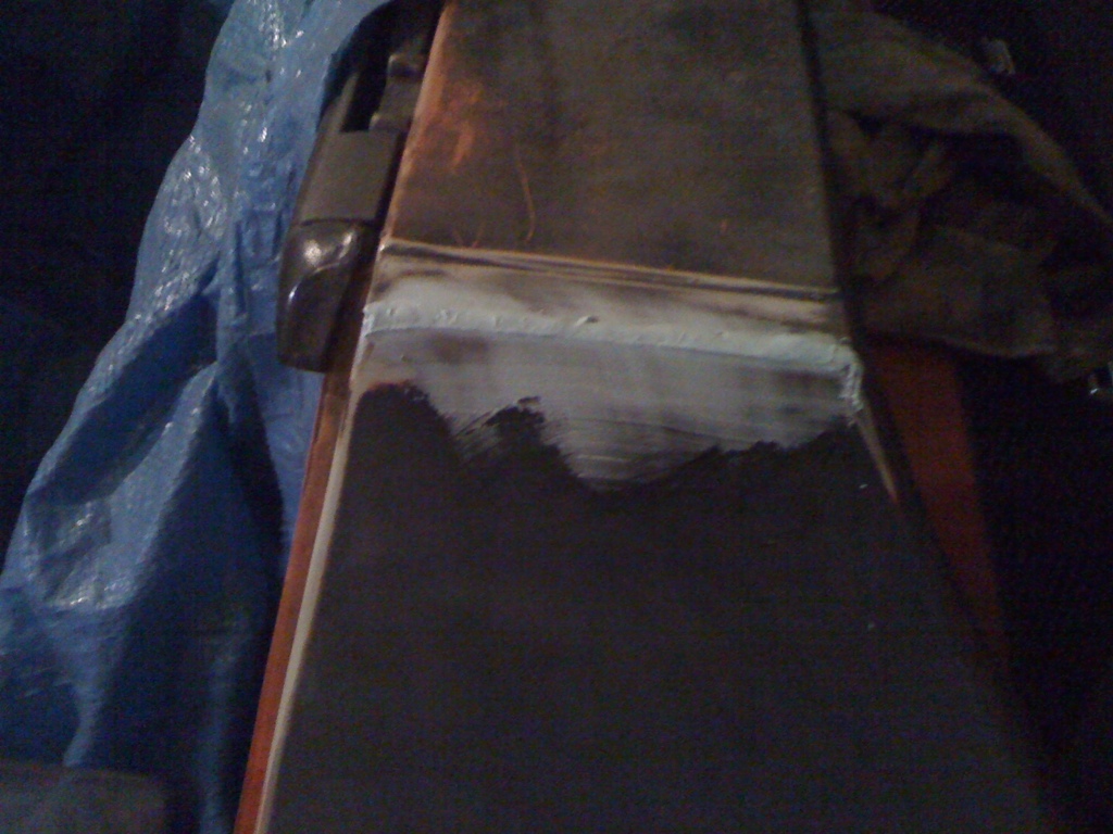

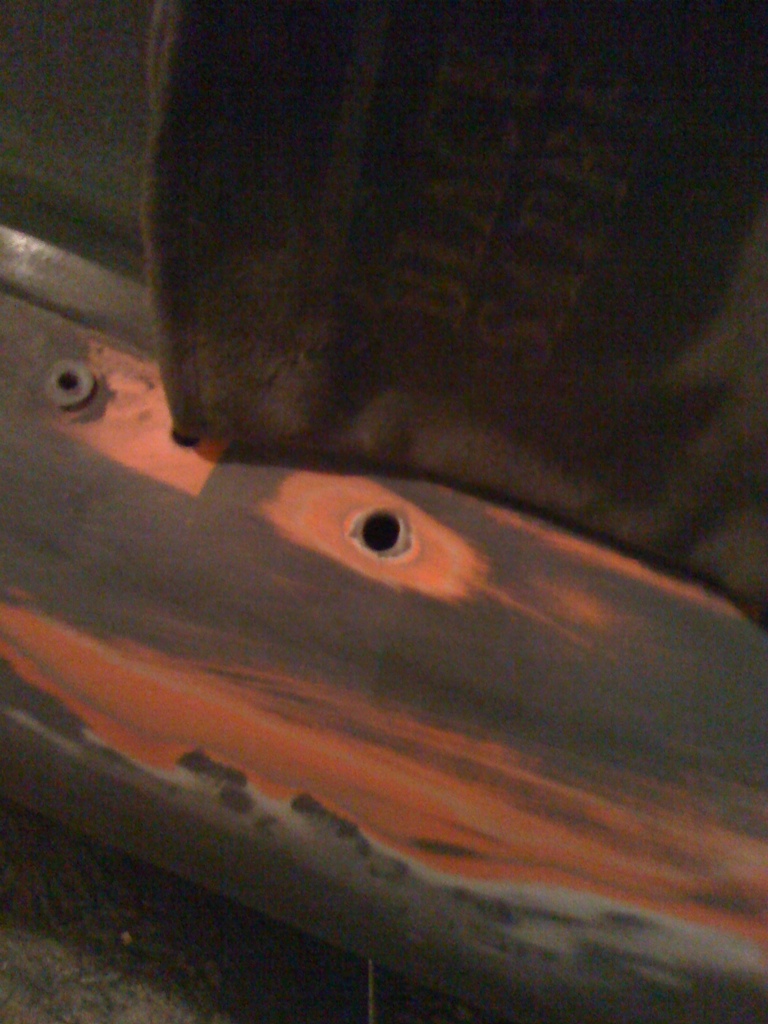

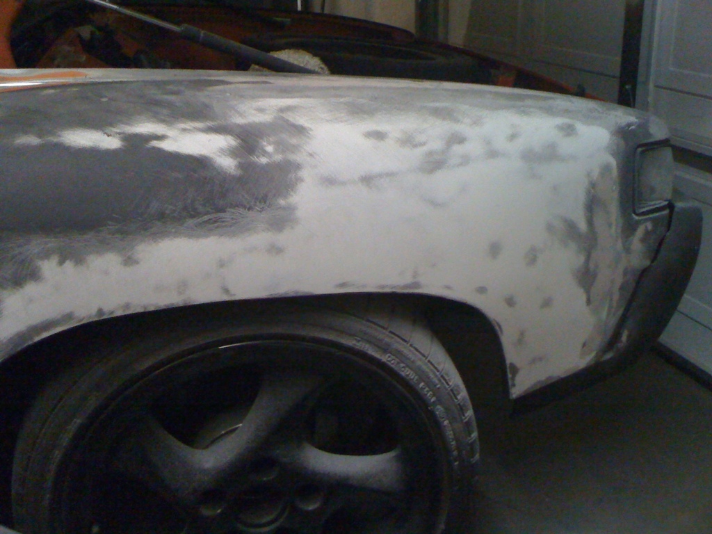

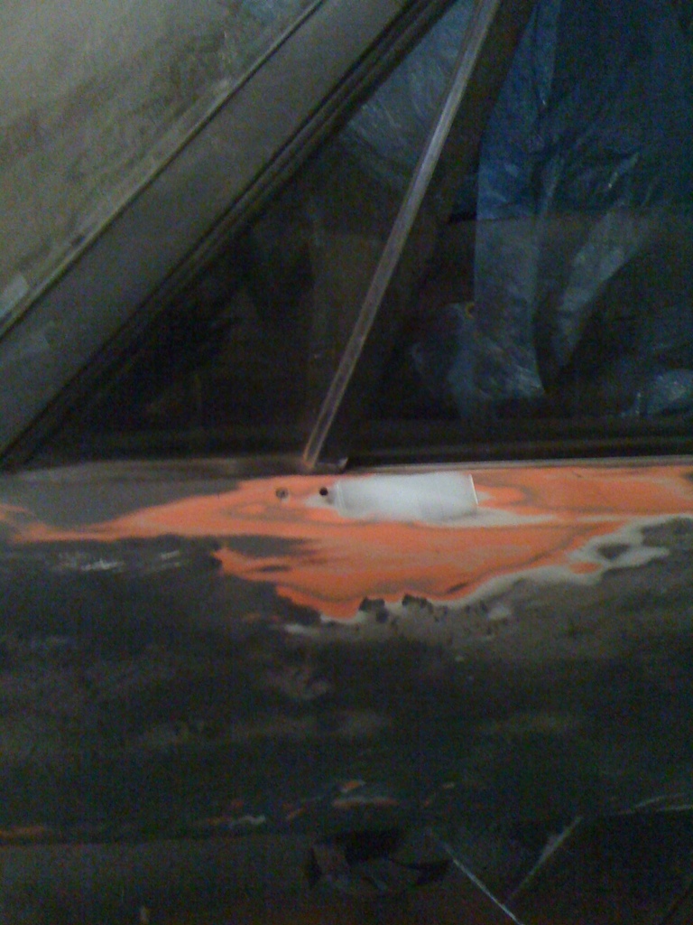

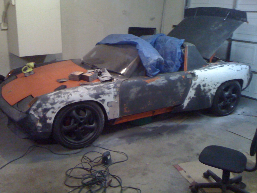

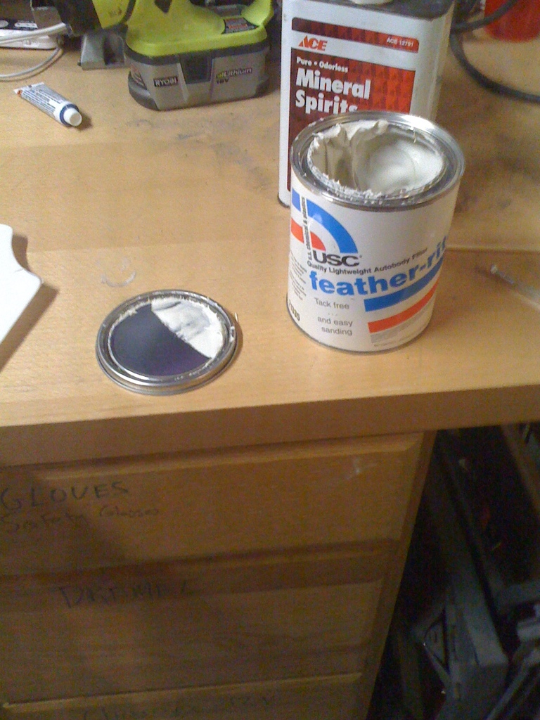

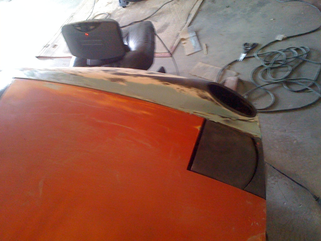

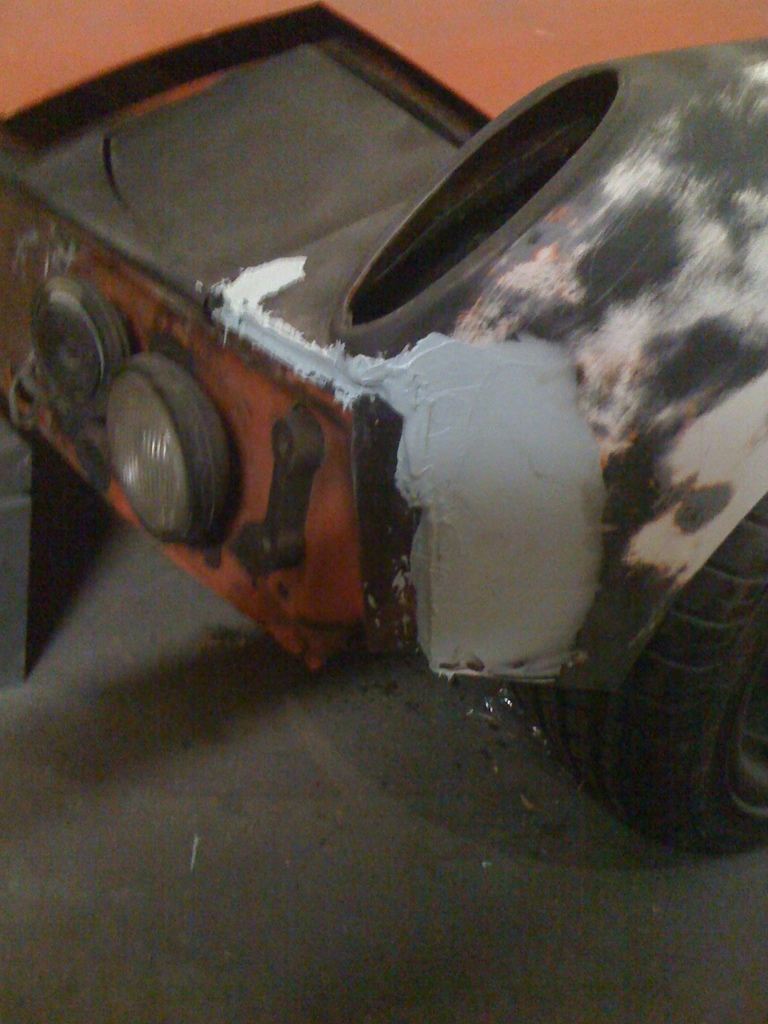

Havent got a working compressor at the house yet so I did some work with the filler.
Unfortunately what I thought was Kitty Hair was actually Metal Ready.... I have no clue how that mix up happened. Im going back tomorrow to see if I can exchange.
So I decided to just use plastic some quality filler I had picked up instead.
(IMG:http://www.914world.com/bbs2/uploads_offsite/i1210.photobucket.com-172-1296628043.1.jpg)
I first had to fill a hole probably from some aftermarket mirror.
(IMG:http://www.914world.com/bbs2/uploads_offsite/i1210.photobucket.com-172-1296628044.2.jpg)
(IMG:http://www.914world.com/bbs2/uploads_offsite/i1210.photobucket.com-172-1296628044.3.jpg)
(IMG:http://www.914world.com/bbs2/uploads_offsite/i1210.photobucket.com-172-1296628045.4.jpg)
So here are the results. I might sand some tonight, I have 2 heat lamps on the body right now.
(IMG:http://www.914world.com/bbs2/uploads_offsite/i1210.photobucket.com-172-1296628045.5.jpg)
(IMG:http://www.914world.com/bbs2/uploads_offsite/i1210.photobucket.com-172-1296628045.6.jpg)
(IMG:http://www.914world.com/bbs2/uploads_offsite/i1210.photobucket.com-172-1296628046.7.jpg)
(IMG:http://www.914world.com/bbs2/uploads_offsite/i1210.photobucket.com-172-1296628046.8.jpg)
(IMG:http://www.914world.com/bbs2/uploads_offsite/i1210.photobucket.com-172-1296628047.9.jpg)
(IMG:http://www.914world.com/bbs2/uploads_offsite/i1210.photobucket.com-172-1296628047.10.jpg)
(IMG:http://www.914world.com/bbs2/uploads_offsite/i1210.photobucket.com-172-1296628047.11.jpg)
(IMG:http://www.914world.com/bbs2/uploads_offsite/i1210.photobucket.com-172-1296629793.1.jpg)
(IMG:http://www.914world.com/bbs2/uploads_offsite/i1210.photobucket.com-172-1296629794.2.jpg)
(IMG:http://www.914world.com/bbs2/uploads_offsite/i1210.photobucket.com-172-1296629794.3.jpg)
All in all I used about 1/2 a quart. A lot more than I thought I would have. I laid it down thick at the rear fender, I didnt like how my sanding went so I wanted to give it another go.
Hopefully i get a compressor at before Saturday so I can lay down some primer filler. In the mean time its bondo and glaze putty and hours of sanding.

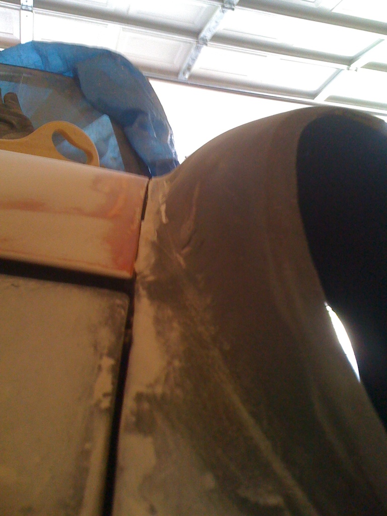

Mark,

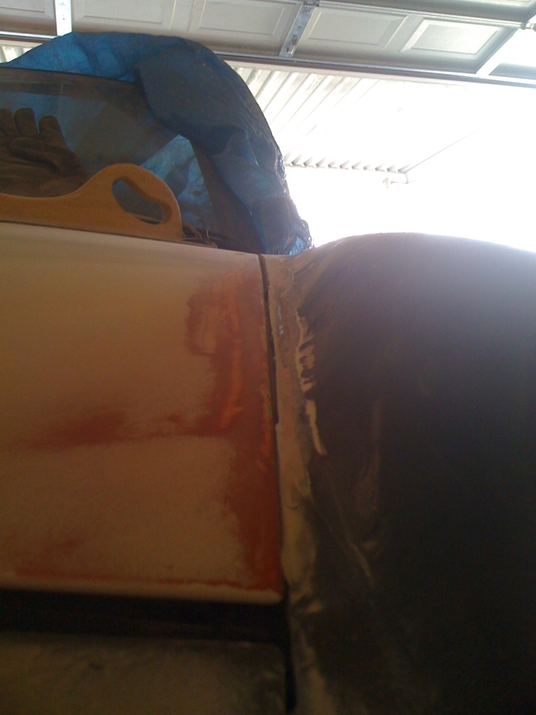

Yup, To be perfectly honest, I forgot to register for night classes this semester and couldnt get in, I decided to focus the time on the 914 VS other hobbies. Its been long enough.
Spoke I have a solid 24" one, and then a flexible 12" one. So far i've been ruffing it in with a 6" block and 80 grit. Ill be hitting it with the 12" board over the fenders next and take it to 160 or so then its primer filler to do the real smoothing.
I really dont like the transition from the rear fender to the door, but there isnt much I can do about it.

Got some more filler layed down
(IMG:http://www.914world.com/bbs2/uploads_offsite/i1210.photobucket.com-172-1296884196.1.jpg)
(IMG:http://www.914world.com/bbs2/uploads_offsite/i1210.photobucket.com-172-1296884196.2.jpg)
(IMG:http://www.914world.com/bbs2/uploads_offsite/i1210.photobucket.com-172-1296884196.3.jpg)
(IMG:http://www.914world.com/bbs2/uploads_offsite/i1210.photobucket.com-172-1296884197.4.jpg)
(IMG:http://www.914world.com/bbs2/uploads_offsite/i1210.photobucket.com-172-1296884197.5.jpg)
(IMG:http://www.914world.com/bbs2/uploads_offsite/i1210.photobucket.com-172-1296884198.6.jpg)
(IMG:http://www.914world.com/bbs2/uploads_offsite/i1210.photobucket.com-172-1296884198.7.jpg)
(IMG:http://www.914world.com/bbs2/uploads_offsite/i1210.photobucket.com-172-1296884198.8.jpg)
(IMG:http://www.914world.com/bbs2/uploads_offsite/i1210.photobucket.com-172-1296884199.9.jpg)
These were some problem areas that I was really concerned about. So far they are coming out really well.
Only spent about 2 hours on it unfortunately. A bunch of other things came into play today.
