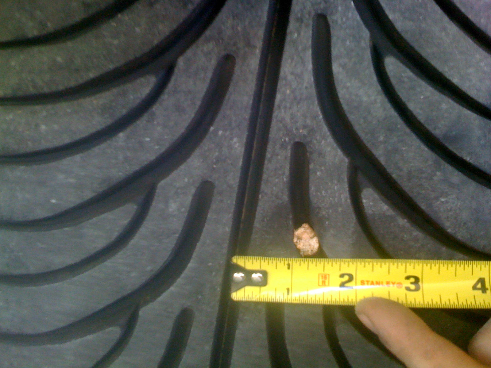

I take that back 285 35 18's.
City of Modesto gave me a 1/2" piece of wood in my tire from their tree trimming (And crappy cleaning up) so now I have to replace it...
Yay..

Sigh...
$200 later, I just ordered a new one.. American tire couldnt fix it, they did offer to prorate it for me for a new tire, but they couldnt get the same tire and I know the Sumitomo tires run very tall... I have a phone call into City of Modesto to see if they will do anything for me.

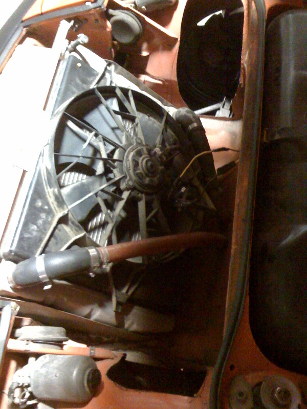

Had a couple of cooling related issues. First off the autozone chrome water inlet on the intake manifold has been corroding away on the inside and finally corroded so far that it created a leak. Pretty bad.. So I drained and flushed the system and installed a factory cast piece that looks like it wont ever have that problem. Took a couple of tries to get all the air out of the system but I did it.
Another issue I had was I had a pusher and a puller 12 or 14" fans (cant remember) and the pusher's connections broke and caused for fraying of wires and a contained electrical fire. I removed the pusher and have been running just a puller, however I wired it backwards on accident and I also decided that one fan just isnt enough. So while dad was picking up some bolts at pick and pull for my honda he picked up a Lincoln Mark VIII radiator fan. 18" of fan glory that fits the radiator PERFECT. MY OH MY does this thing suck air. Absolutely dwarfs the old fan and supposedly pulls 4k CFM. I have it running on just the LOW setting and will setup a separate switch for the HIGH setting (its a 2 stage fan). The only thing I think I have left to do for the radiator is setup a duct to force the air out the wheel wells as I think there is some turbulence currently and I dont think its as efficient as it could be.
