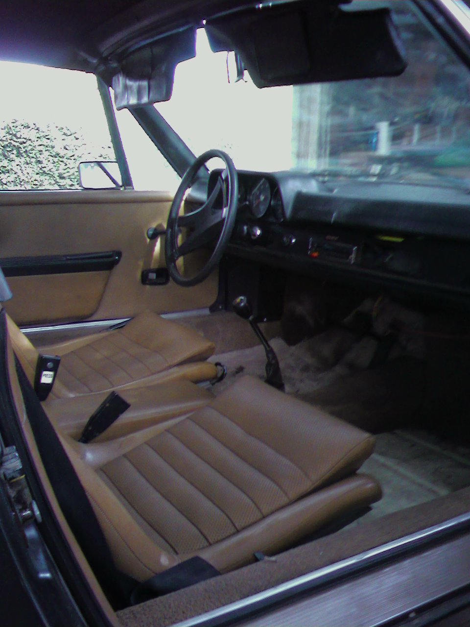

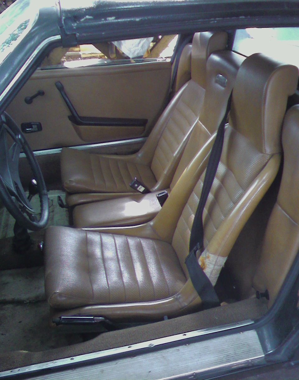

I've been through the same situation. I have a car that was almost not driven from 1976 till 2010. The vinyl looked perfect but I could tell it was a bit cooked from the sun (there was a small tear in the car cover).
I tried to softener the vinyl many vinyl and leather oils. I even tried facial cream (IMG:style_emoticons/default/smile.gif)
After about 6 months of occasionally driving the car, the vinyl gave up at the seams. Only the plastic cover of the vinyl cracked, leaving the fabric layer intact.
I conclude that adding more support under the vinyl will not help.
I have a relatively rare brown vinyl interior but I was able to identify a replacement material of the same color. I'm going to recover the seats.
