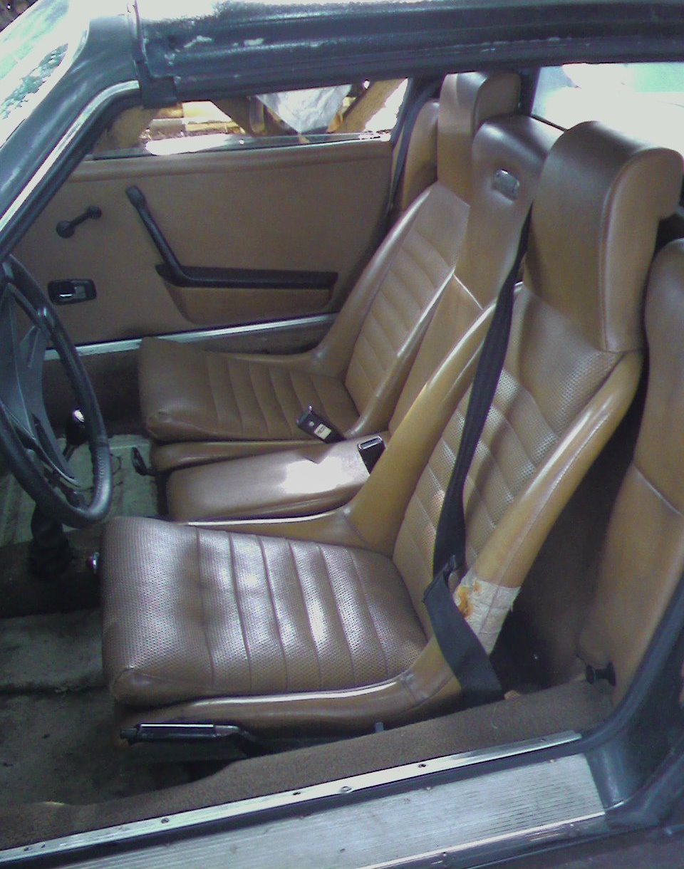

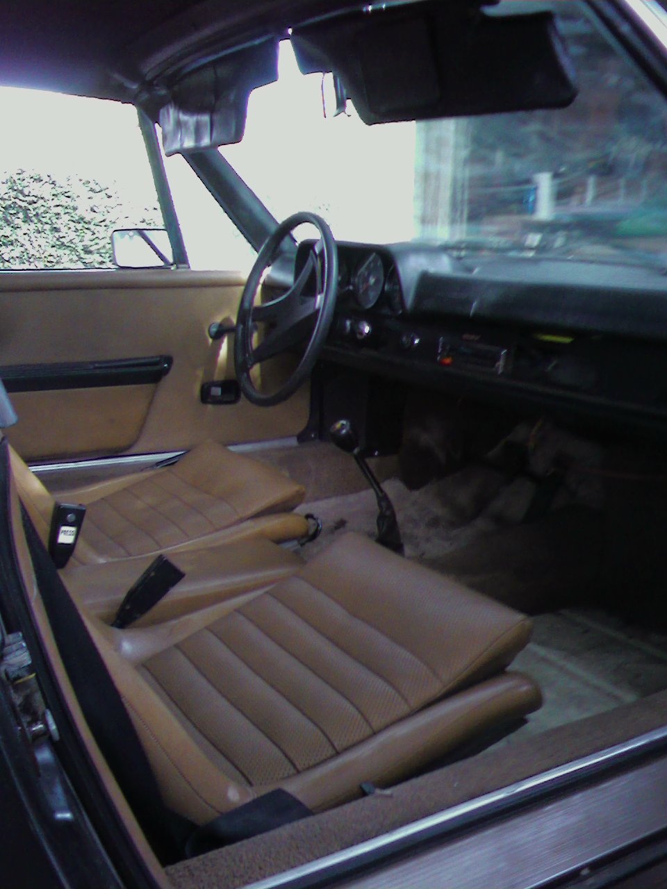

Mine is still pretty pliable after sitting in the garage for the past 26 years, mostly being garaged, car-ported & covered for the 10 prior to that that I owned it, 7 for the PO/OO - even where I have the shittage-in-the-back-pocket tear on my D-seat bolster & smaller ones elsewhere from when it was my DD `75-85.
Click to view attachment Click to view attachmentI think Pat's are in similarly good condition, but without my tears to repair (ergo the extra backpad I got in the matching OE leatherette).
