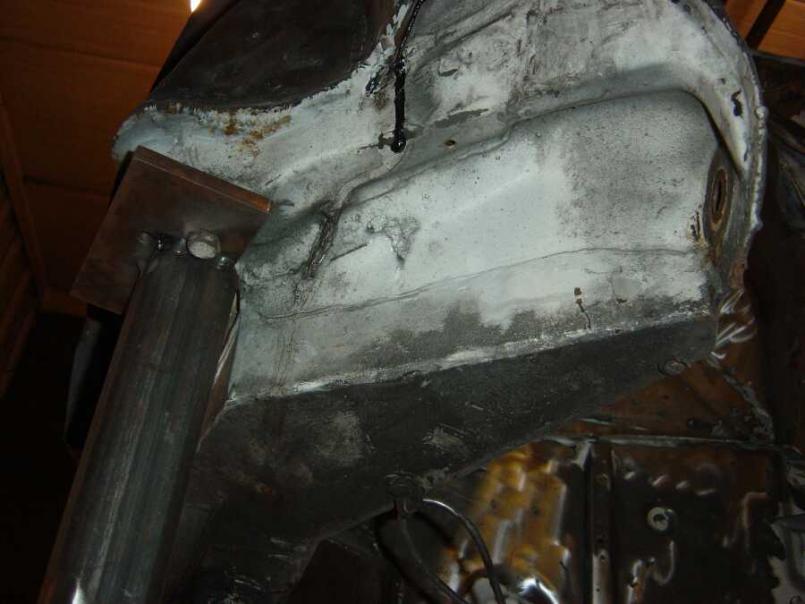

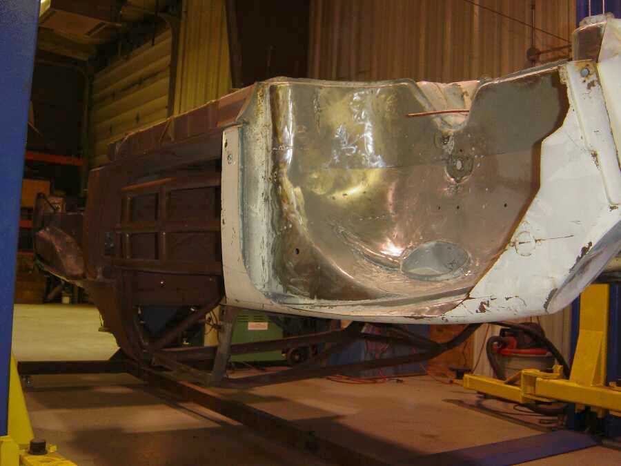

gms   I started to strip the passenger front wheel haus ...   Feb 13 2011, 05:03 PM

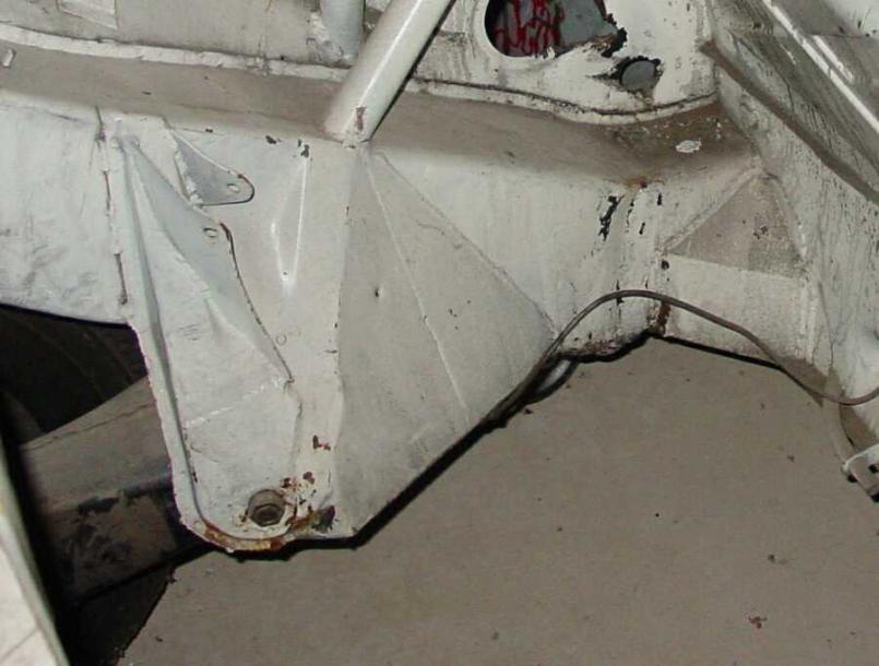

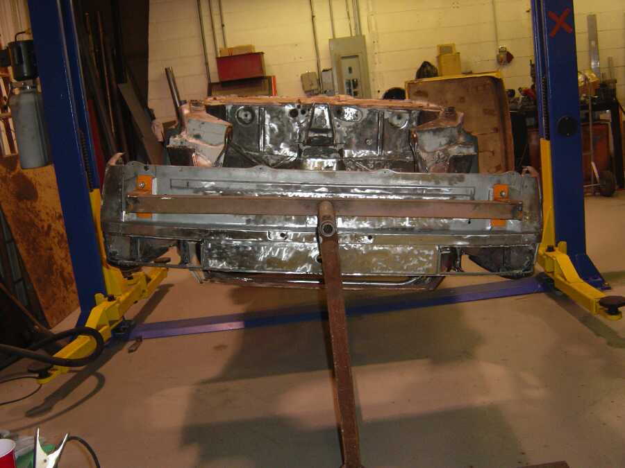

gms   You can see where the cage ties into the front str...   Feb 27 2011, 09:49 AM

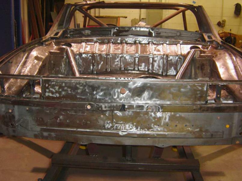

gms   bare ass shot   Feb 27 2011, 09:51 AM

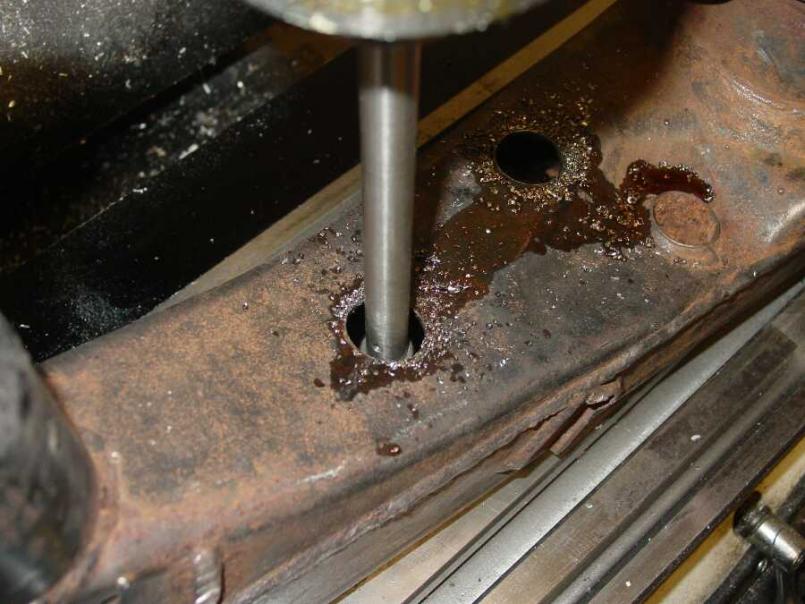

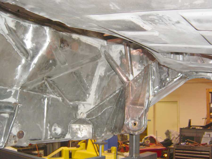

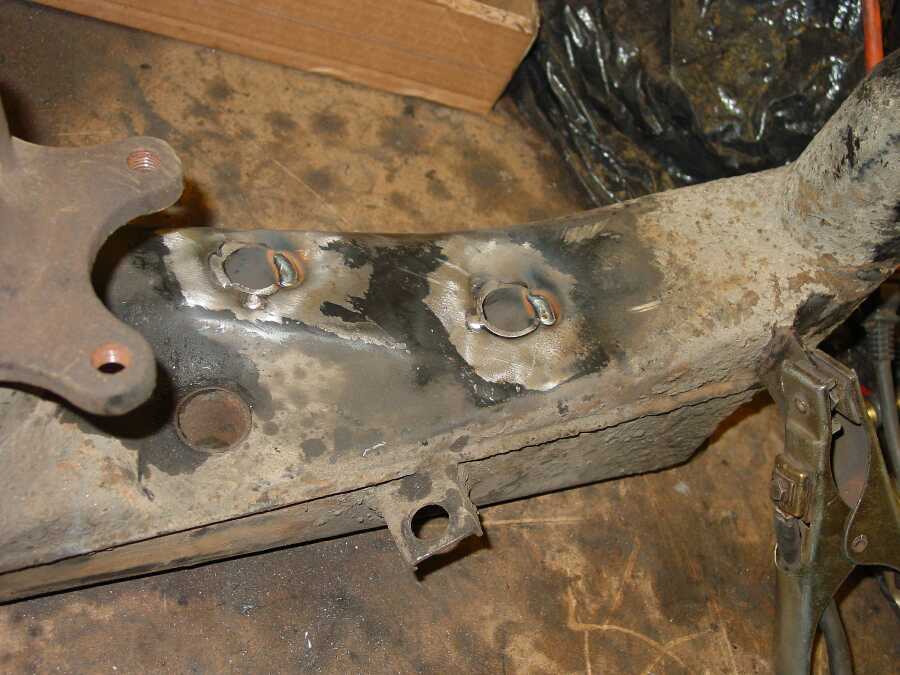

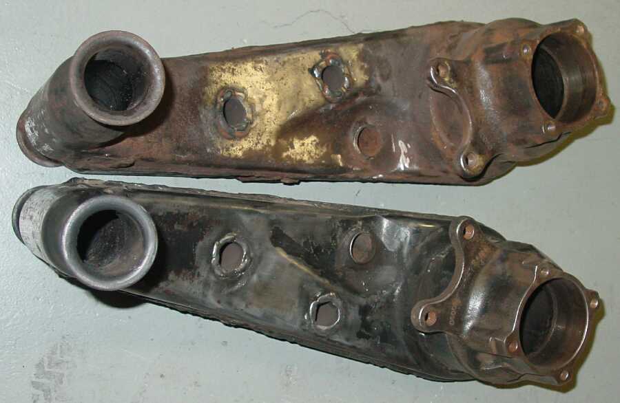

gms   I did some work on the trailing arms a couple week...   Feb 28 2011, 10:43 AM

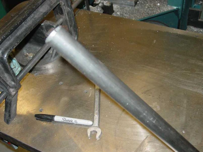

gms   I found some 1" pipe at McMaster-Carr   Feb 28 2011, 10:46 AM
gms   insert in the holes, weld and there they are. I wi...   Feb 28 2011, 10:48 AM

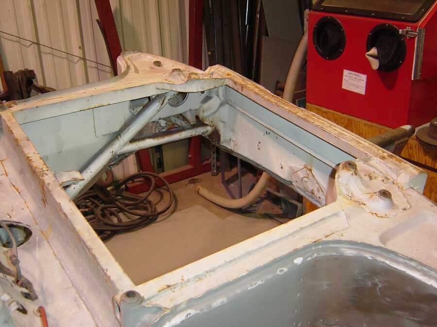

gms   A picture from under the trunk into engine compart...   Mar 8 2011, 11:12 AM

gms   I used that pipe for the rear suspension ear heim...   Mar 9 2011, 02:22 PM
gms   Here are the picture of the driver rear mount   Mar 9 2011, 02:43 PM

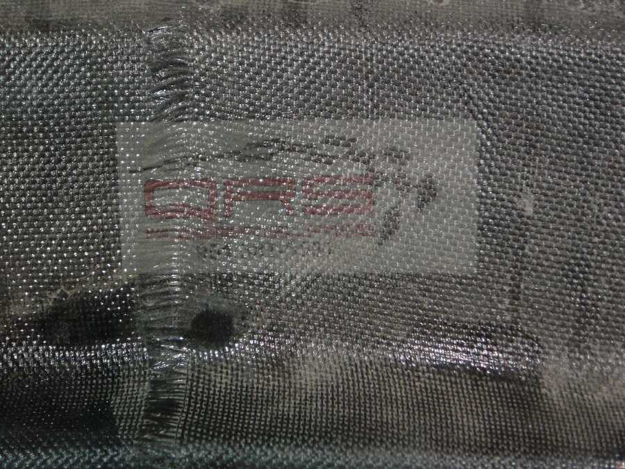

gms   The QRS fiberglass bumpers came in this week, thes...   Mar 10 2011, 01:29 PM

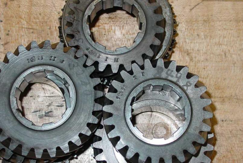

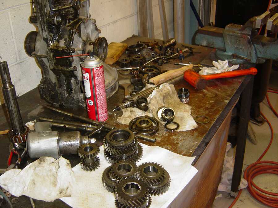

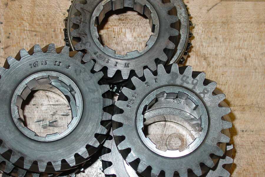

gms   a tranny I bought came in today and I harvested M-...   Mar 15 2011, 01:40 PM

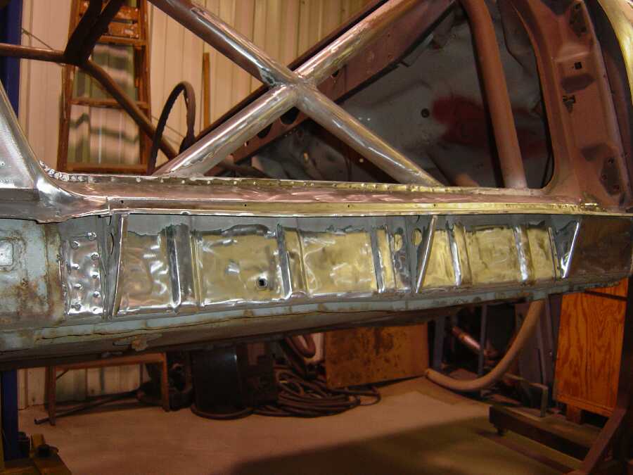

gms   Here is a view of the front trunk area it was 2 y...   Apr 4 2011, 03:01 PM
gms   I did a little paint removal yesterday, very clean...   Apr 4 2011, 03:03 PM

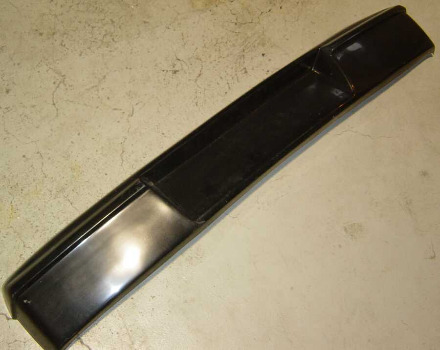

gms   Racing season is over and it is time to get back t...   Nov 7 2011, 10:08 PM
gms   second is the whale tail   Nov 7 2011, 10:10 PM

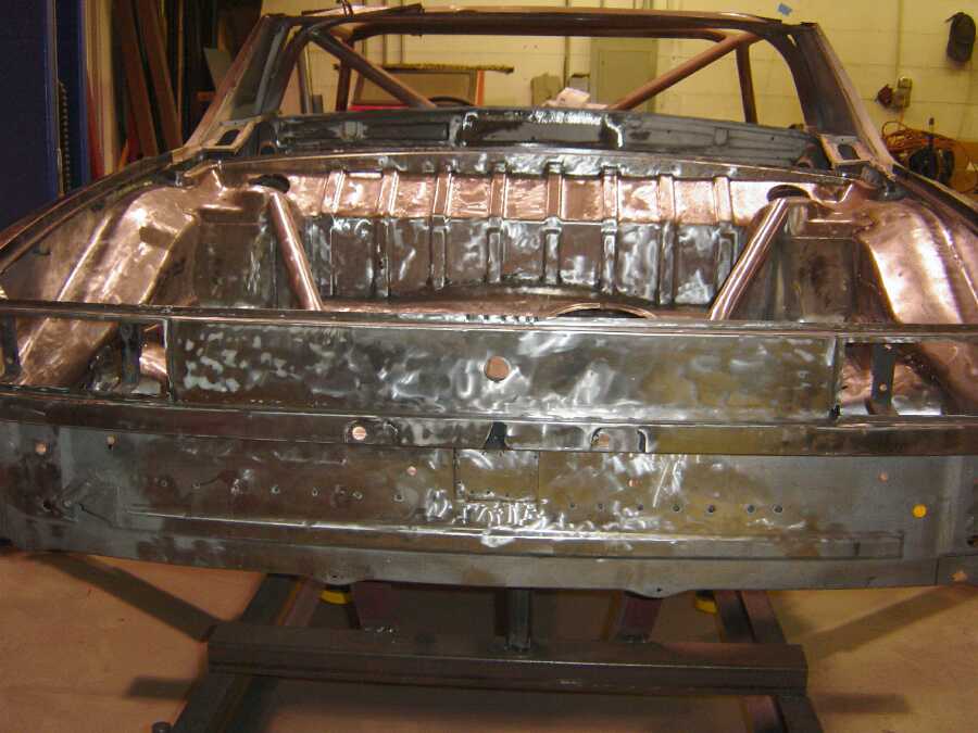

gms   This is an example of some of the work I did yeste...   Feb 13 2013, 09:36 AM
