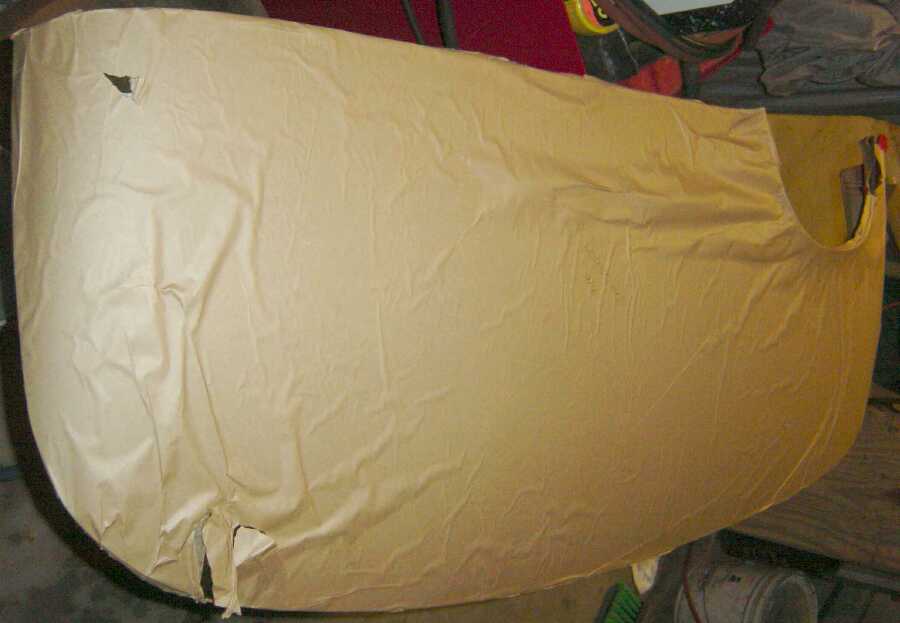

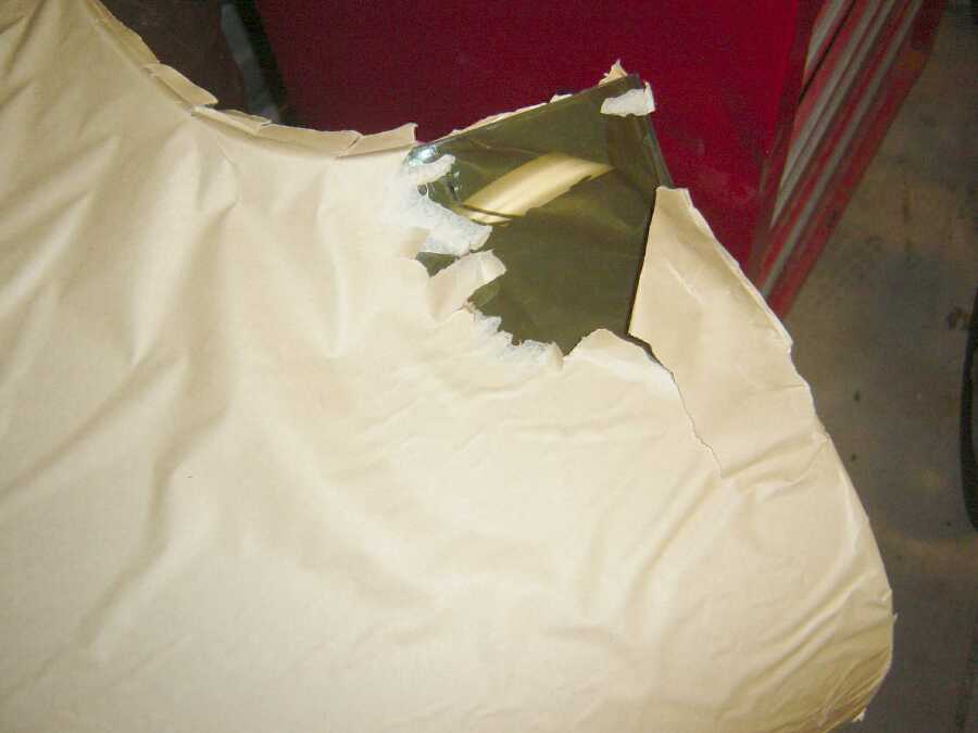

First is the Ginther windscreen

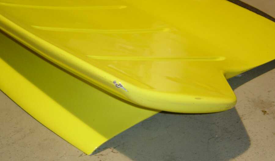

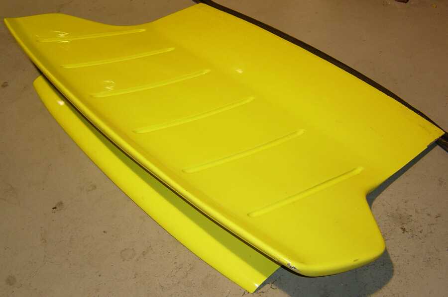

second is the whale tail

The Ginther screen is tough to find....in my experience and un-cheep.
Be careful handling it while fitting. I was & still managed to crack it.
I've not seen one F/S for 4-5 years....extra careful.

QUOTE(gms @ Nov 7 2011, 08:10 PM) *
Hello, where did you find your 'whale tail'? I'd like to have one for my 914.

I've got that exact same whale tail that I won't be using. PM me if you're interested. Located in Davis, CA (just outside of Sacramento).

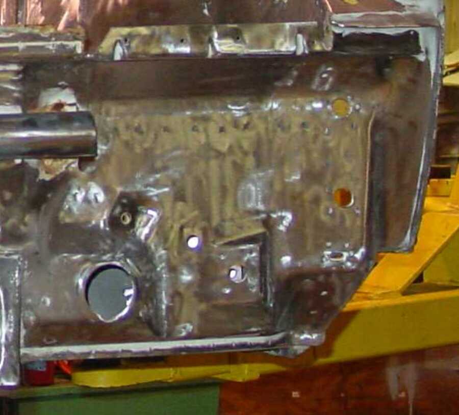

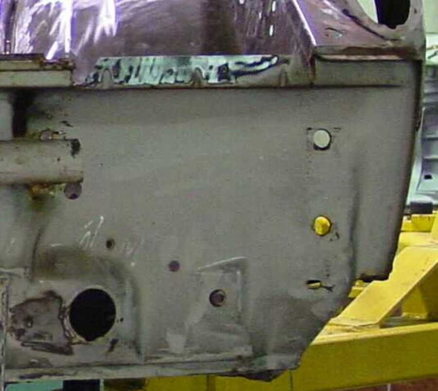

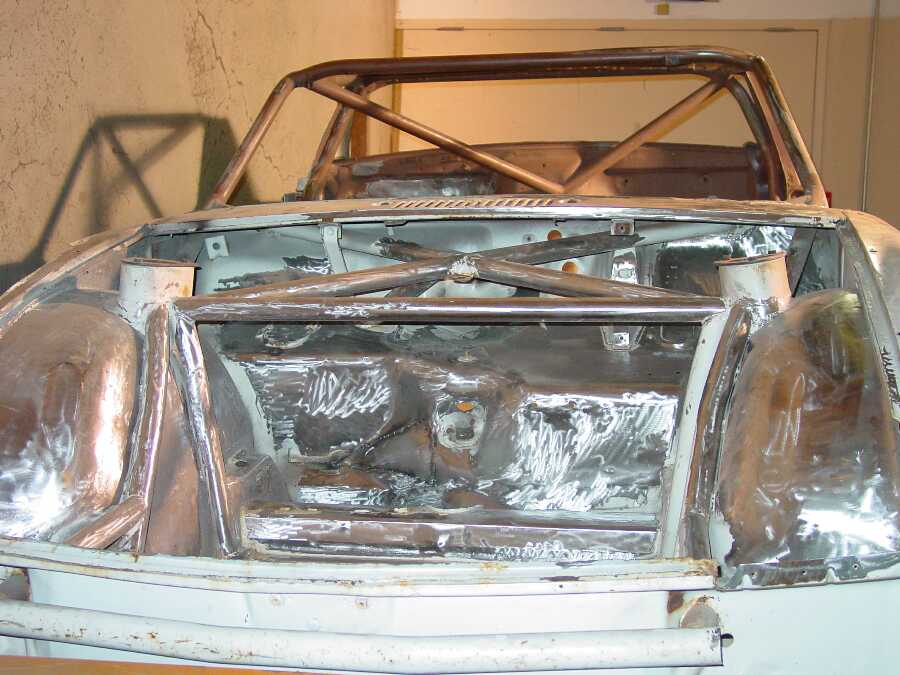

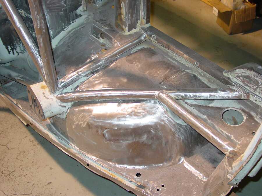

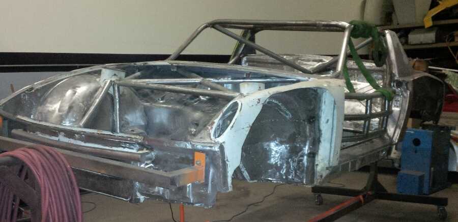

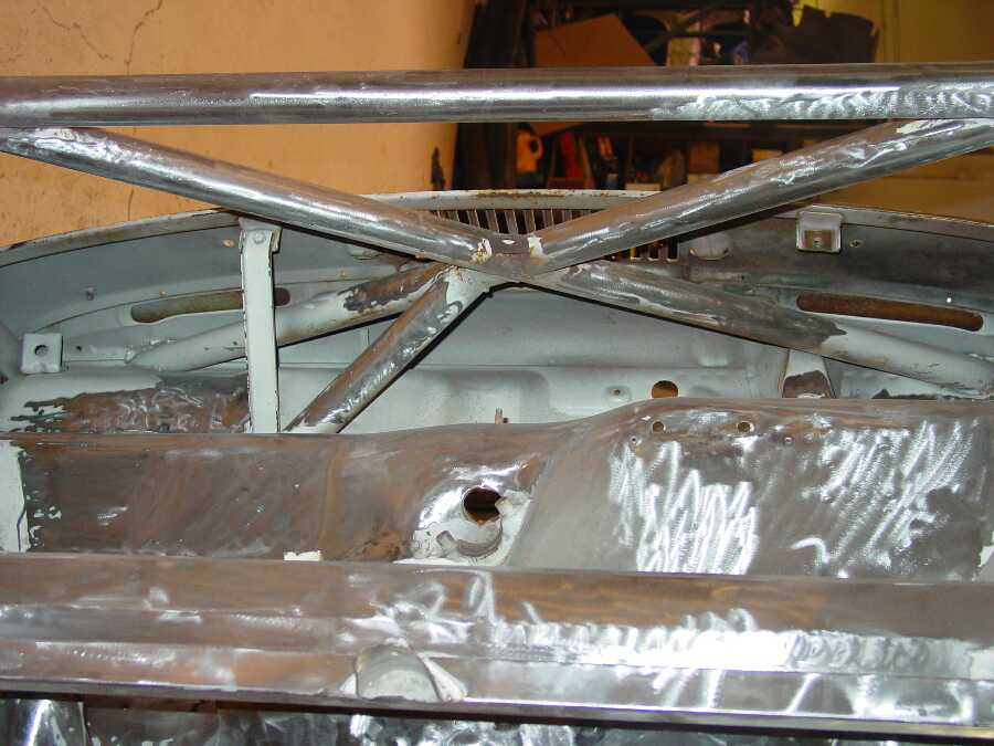

I started work on the car again, got most of the front trunk cleaned up tonight.
Lots of holes to weld up!

Your car is coming along great.
Glenn has spent countless hours prepping this car ans is very detail minded. The appearance of rust is a problem with the lighting. Most of what looks like surface rust is not. It is nice clean and shinny! The roll bars are painted brown.

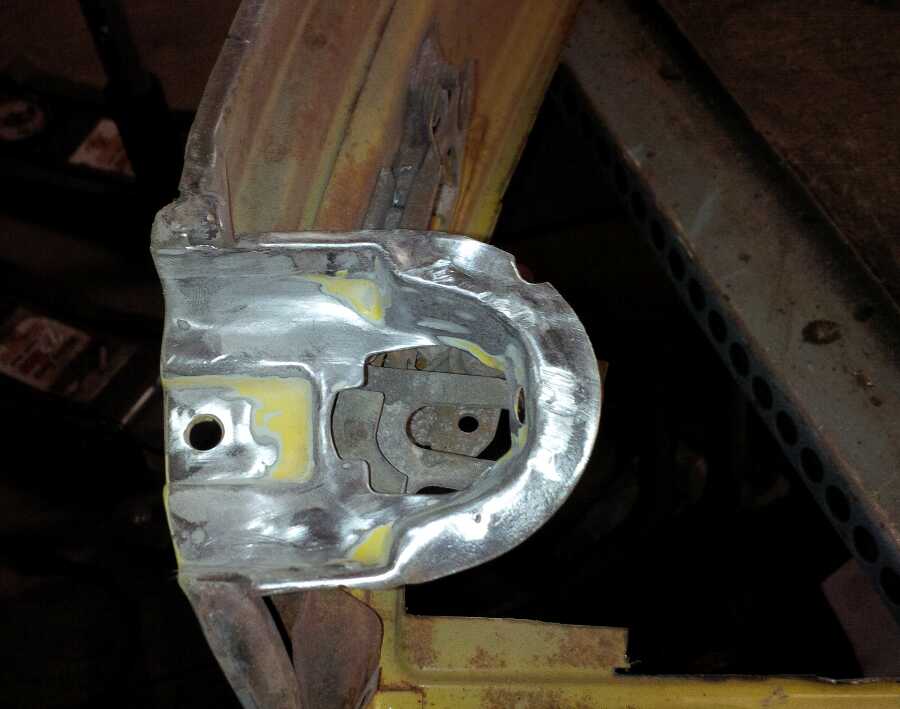

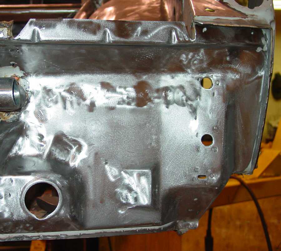

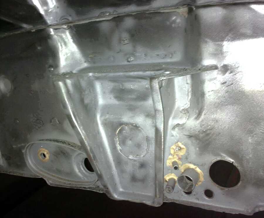

This is an example of some of the work I did yesterday.
I removed the horn and fog light mounts and filled the holes.
Clean the paint off
Weld up the holes

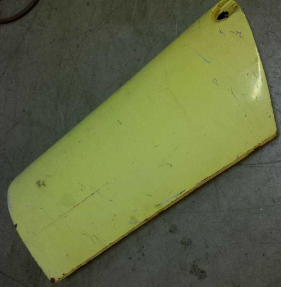

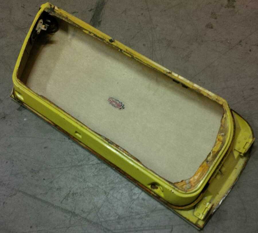

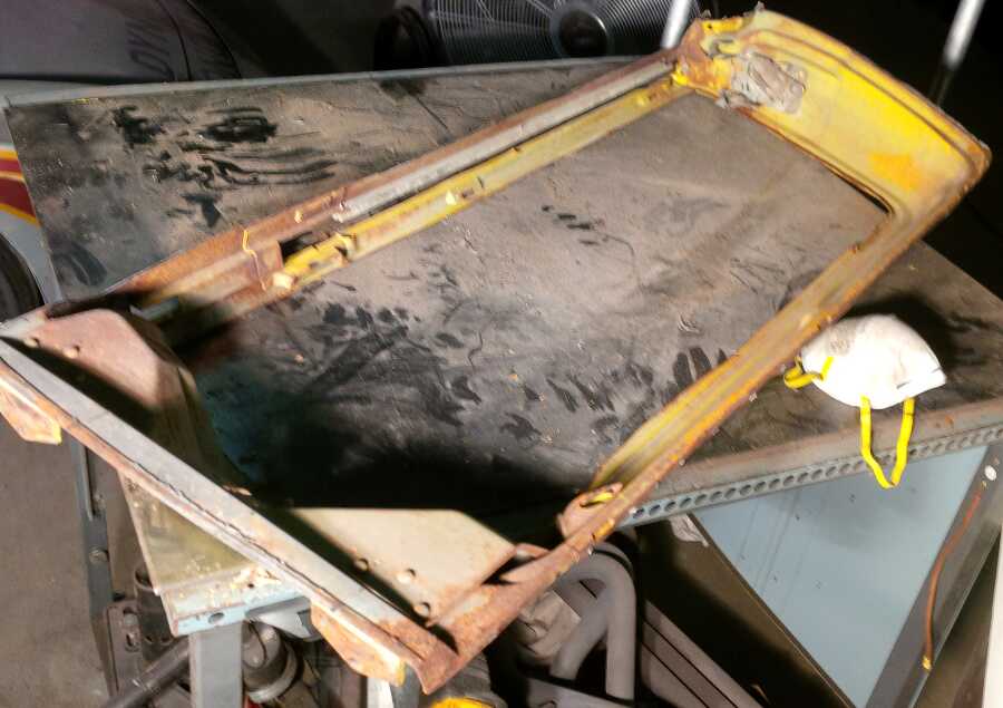

I had an early door with a bad door skin (rust & bondo) so I thought I would try and re-skin it with fiberglass.
gms
post Dec 8 2014, 11:07 AM
Post #56
Posts: 2,755
Joined: 12-March 04
From: Chicagoland
Member No.: 1,785
The skin came off easier than i thought
gms
post Dec 8 2014, 11:08 AM
Post #57
Posts: 2,755
Joined: 12-March 04
From: Chicagoland
Member No.: 1,785
I will use a 3M glue to refasten the fiberglass skin

Not much new, just waiting for a nice day to do some sand blasting

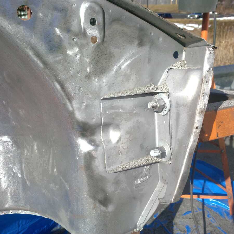

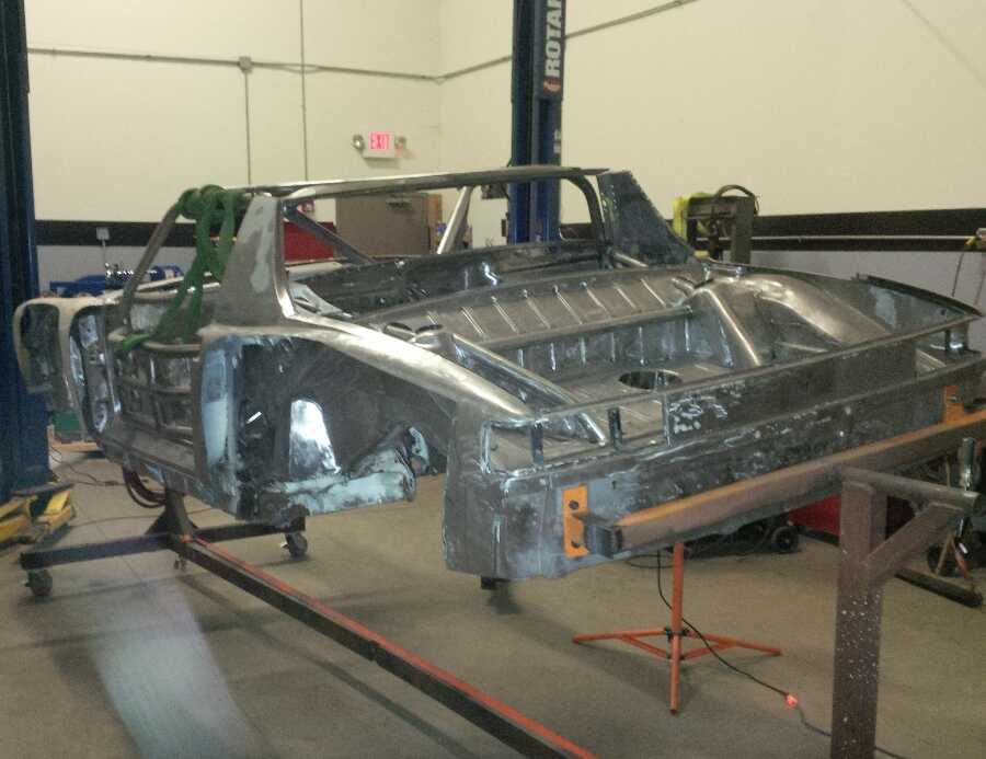

Finally had a warm (41 degrees) dry day on Saturday so I pushed the chassis out side and sand blasted some hard to clean areas

It's hard to know what I dislike more, the cold or sandblasting outside of a cabinet! Dealing with both of them at the same time should get you some kudos for getting the job done!
