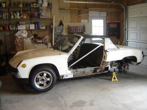

Also, I've read a couple opinions about how much "spread" to introduce to the door way to allow for shrinkage after the tub cools down--and to compensate for sag in the body once it's back on its wheels.
What's my best strategy?

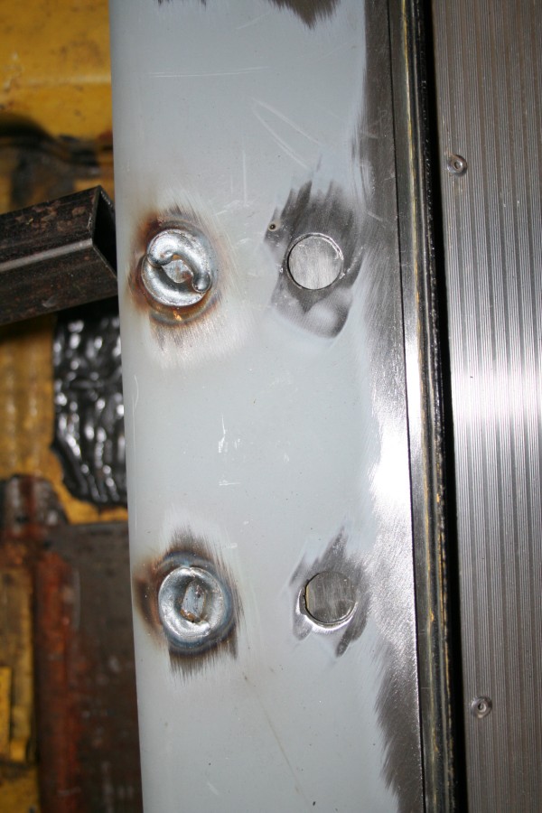

I took both doors off (damn things weigh a ton), made braces for the doors out of 1 inch square tubing and welded brackets to the tubing to bolt in the doorway so the body didn't flex. I also drilled all the holes out to 5/8 inch to make stronger welds. I think it's a great idea to do this. It is a very good kit, takes a little massaging to get it fit up right but you will be pleased with the results.

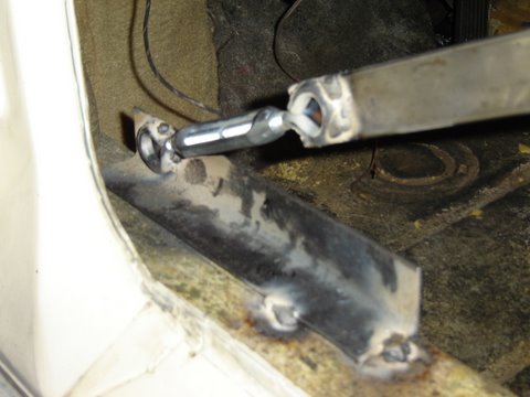

What I have is braces I made from 1" square tubing with integral turnbuckles. They fasten at the upper shoulder belt mount and are tacked on top of the longs as far forward as i could get them. The reason for this was so I could adjust them with the doors in place. I kept the roof clipped in place and then removed the door so I could cut out the inner longs, jack post area, and wheelhouse. All that grunt work is done now with new steel in place and I finally made the plunge on getting the Engman kit. Trouble is, my braces are on top of the longs--interfering with where the stiffening kit will go.
My plan (which I started today) is to grind the welds and pull out one brace at a time. I will then clamp the Engman side piece in place and weld it just in the area which would be under the foot of my chassis brace so I could re-tack the brace. Then, put the door back on to check gaps again, adjust the brace as necessary, remove door, and finish welding in the kit.
I just wasn't sure if it was as easy as that or if I needed to actually put expansion tension on my braces as I have read in the past.
And then the P-brake post also raised the question. I had never seen anyone else addressing it being in the way of fitment. I will say I was blown away by the design, quality, and finish of the kit's parts. Nice stuff to say the least.
