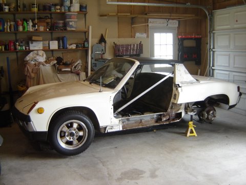

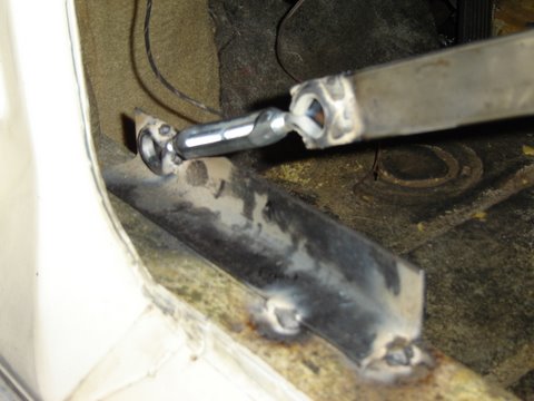

What I have is braces I made from 1" square tubing with integral turnbuckles. They fasten at the upper shoulder belt mount and are tacked on top of the longs as far forward as i could get them. The reason for this was so I could adjust them with the doors in place. I kept the roof clipped in place and then removed the door so I could cut out the inner longs, jack post area, and wheelhouse. All that grunt work is done now with new steel in place and I finally made the plunge on getting the Engman kit. Trouble is, my braces are on top of the longs--interfering with where the stiffening kit will go.
My plan (which I started today) is to grind the welds and pull out one brace at a time. I will then clamp the Engman side piece in place and weld it just in the area which would be under the foot of my chassis brace so I could re-tack the brace. Then, put the door back on to check gaps again, adjust the brace as necessary, remove door, and finish welding in the kit.
