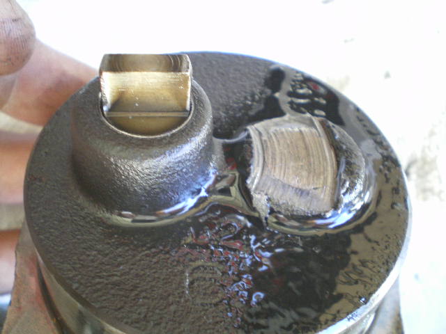

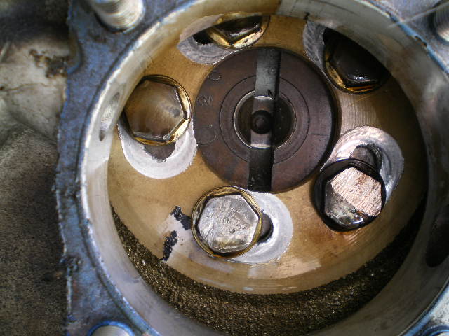

In a prior post I mentioned that I was going to pull the drive train to check out the p/o's alledged rebuild. They said that they couldn't get it to idle. I found alot of blue silicone from the rebuild. Not good. Coupled with the fact that they had installed a hodge podge of FI components I decided to check out this ol' boys work. P&C's looked pretty new (I'll let the machine shop decide that) so I was hoping that everything else was too.
I almost (IMG:style_emoticons/default/stromberg.gif) in my shoes when I pulled the oil pump.

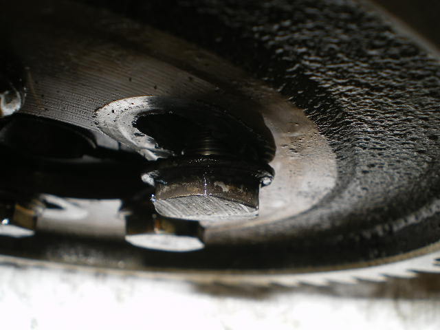

This bolt is not only bent but had backed out 3 threads. The one below it was hand tight.
looking at the back side you can see the difference in bolt lengths
They had to have heard this.
