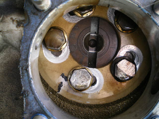

In a prior post I mentioned that I was going to pull the drive train to check out the p/o's alledged rebuild. They said that they couldn't get it to idle. I found alot of blue silicone from the rebuild. Not good. Coupled with the fact that they had installed a hodge podge of FI components I decided to check out this ol' boys work. P&C's looked pretty new (I'll let the machine shop decide that) so I was hoping that everything else was too.

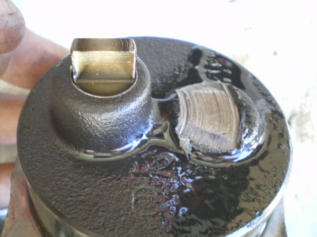

I almost stromberg.gif in my shoes when I pulled the oil pump.

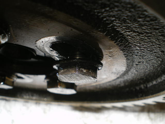

This bolt is not only bent but had backed out 3 threads. The one below it was hand tight.

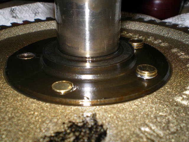

looking at the back side you can see the difference in bolt lengths
They had to have heard this.
SLITS
It is hard to tell if they purposely made the cam timing adjustable by enlongating the mounting holes of if that occured due to the fastner head hitting the oil pump.
On the stand, you should have not been able to turn it by hand.
Nice job!

This was common around Y2K.. A whole batch of cam gears ending up being soft and they'd not hold torque.. It happened to me on one occasion.
Also, the oil pump drive tang is protruding too deep into the drive slot of the cam.. See those two shiny spots where the corners of the oil pump drive have been hitting deep inside the drive slot??
I bet the cam thrust bearings are trashed and the cam is walking fore and aft in the case, that could be why the bolts contacted the oil pump as well.
Start taking it apart.

I see it now that you point it out. I wouldn't have known if you hadn't said, thx. Todd at RIMCO mentioned that the oil pump wasn't original and it need to be brazed on the other side of the scarring.(yep, stripped it and dropped it off to them today) That time frame for the bad timing gears is exactly spot on with what the p/o had said. It's getting a Raby 9550 kit w/8300 gear, as soon as they call back to say the case is good.

Does anyone else see what looks like a crack in the cam flange starting at the short bolt on the left?
76-914
QUOTE(rick 918-S @ Feb 24 2011, 10:01 PM) *
Good eye, Rick. When looking at from a side view. the material actually raises a bit where the 2 cracks are. But I really wasn't going to re-use it, honestly. happy11.gif
