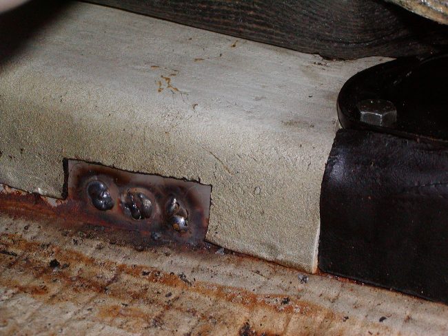

Been driving the 914 for a few weeks while I slog through my Subaru's head gasket repair. On the way to work yesterday the clutch goes "POP!" and looses about half its adjustment. I figure the cable is done for and buy a new one. No biggie...
Turns out the clutch tube broke away from the tunnel. So now I get to join that club. 2 cars down. All I need to do now is get some cinderblock and push both of them on to the front lawn...

If its the front of the tube that let go, its an easy job actually.

Hoping to just plug weld it too... I all ready have SS lines, so risk of fire is a bit lower...

It looks like you just plug welded right to the tube itself. That's what I was considering as I'm assuming the bracket won't be in good shape. Any draw backs to that? I have a friend that is a professional welder bringing his TIG by to help, so heat control should be a non issue.

...and its loose at the firewall too. Good grief.

What a day! Was able to finish the 914 AND the Subaru. A good friend came over with a portable TIG and we plug welded the bracket at the front of the clutch cable and used a very heavy washer "kustomized" to fit on the rear at the firewall. Clutch feels amazing! I had no idea how bad it "was".
