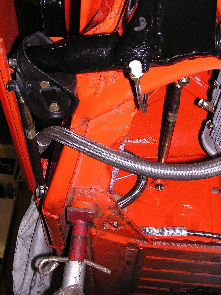

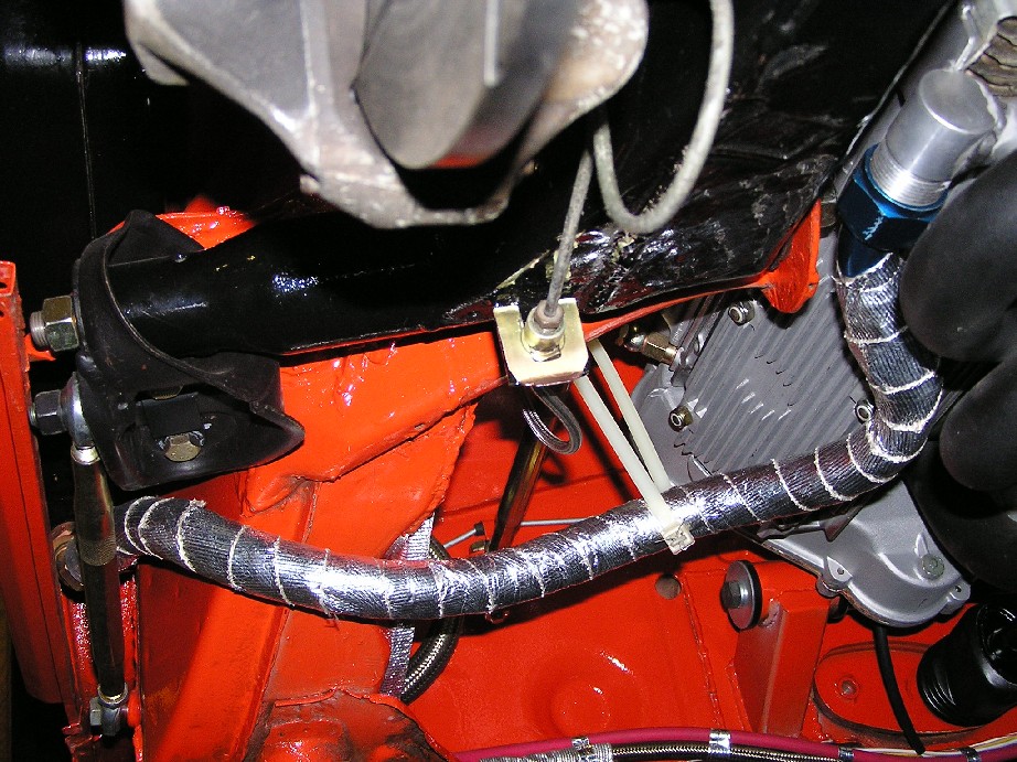

Scott, while you are taking pics, would you mind taking a pic of where the lower line exits the body and how/where it is secured to the body (if at all)?
I can't seem to figure out if that hose simply dangles or if there is actually some holes in the body it needs to pass through.
Thanks a lot.
Rob
SLITS
post Feb 18 2011, 10:03 PM
"This Utah shit is HARSH!"
Posts: 13,602
Joined: 22-February 04
From: SoCal Mountains ...
Member No.: 1,696
On a 914/6 there is a bracket the hose sits in, attached to the body. The supply hose does not pass thru any body panels.
The scavenge hose passes thru the body (actually the engine shelf, driver's side, to the oil tank.
Anyway, on my conversion it dangles.
brant
post Feb 18 2011, 10:08 PM
Posts: 12,281
From: Colorado
Member No.: 47
conversions dangle:
brant
post Feb 18 2011, 10:09 PM
Posts: 12,281
From: Colorado
Member No.: 47
and:
moparrob
post Feb 18 2011, 11:13 PM
Posts: 646
Joined: 27-April 10
From: Los Angeles
Member No.: 11,663
Thanks guys, dangle it shall be.
Much appreciated.
