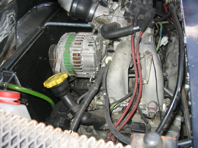

WCC 2005 Scott drove his Suby conversion from MD to CA. his rad was in front of teh eng in teh eng comp

QUOTE(sean_v8_914 @ Feb 19 2011, 01:09 PM) *
(IMG:style_emoticons/default/agree.gif) Suby conversion before Renegade came out with theirs.
Absolutely unrefined in every sense of the word but it made it all the way from MD to CA and back. We traveled through the desert together and got stuck in construction traffic. The car cooled well enough it didn't over heat.

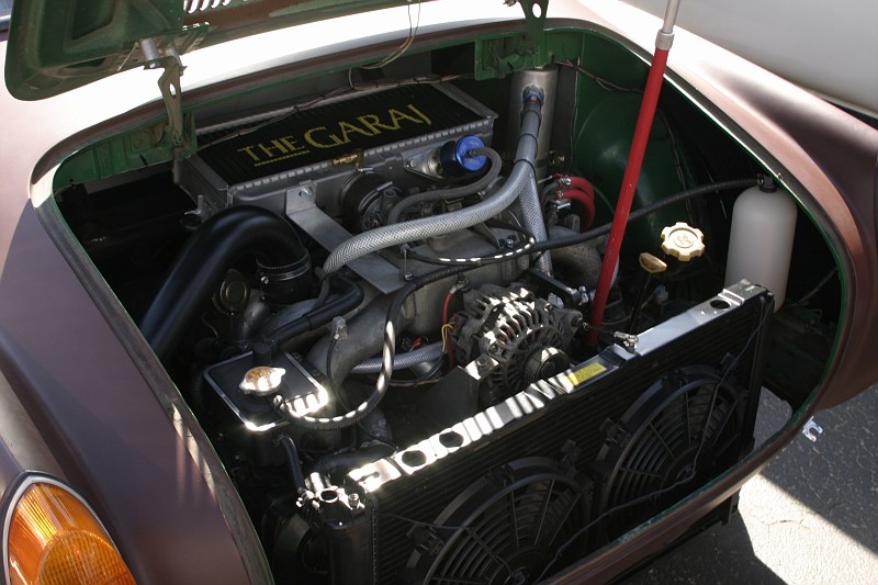

I know is not a 914 but my vw ghia with rear radiator work fine is a street legal car + I do D E and temp is not a problem Attached Image
