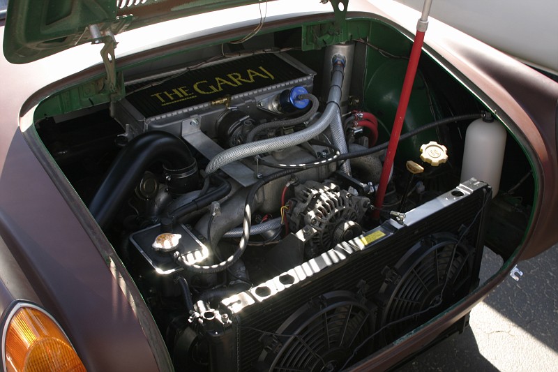

Brujo65
I know is not a 914 but my vw ghia with rear radiator work fine is a street legal car + I do D E and temp is not a problem Click to view attachment
