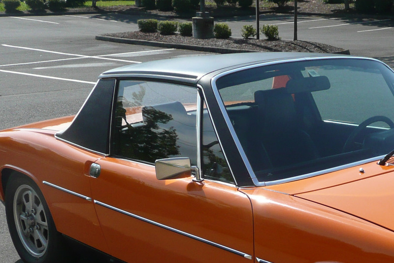

Does your 914 currently have or did it ever have black vinyl covering the windshield loop like the one in the photo below?
Thanks,
Steve

Also, the Orange one in the pic on Steve's/smg's post above is exactly one digit VIN before yours - ....1102! I'm betting it originally had the A-pillar vinyl on yours too. He's in SoCal in Anaheim Hills near me.
As an early 914-2.0 it has some unique features such as that, probably the chrome window crank handles & door handle cups (interior - or did have), etc. which were hold-over 72 MY items unique to only the first 1000-2000 73 MY 914s, as well as being marketed in the US as a "914S" for the first half of the 73 MY up to about Jan/Feb 73.
Mine is VIN ...1954 & built about 2 weeks after ...1102 (& probably yours), and the OO/PO & I did multiple color change repaints - last to a color which sounds similar to yours (see small pic at my avatar in the upper left of this post), but I'll be going back to it's OE L80E Light Ivory (white) in my resto. I'd suggest you take yours back to the OE color eventually as well, and replace/add-back any oddities noted above which used to be on it, to have an accurate resto & worth best bucks!
