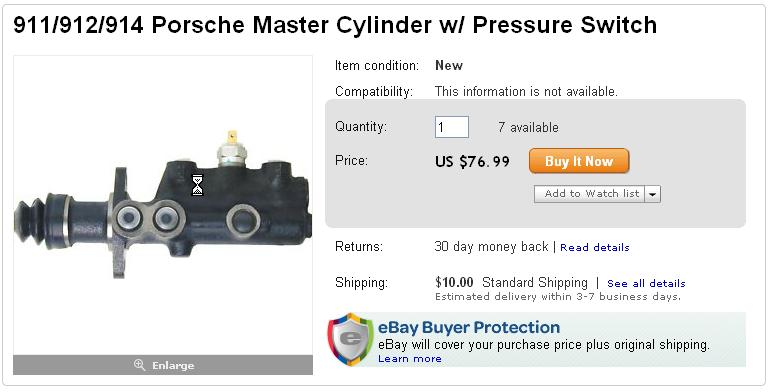

Is there any reason this master cylinder wouldn't fit my 1975 1.8L? The ad lists it as '72 and older only. They say the have only the ATE part ($309) for the 1975.
http://cgi.ebay.com/ebaymotors/911-912-914...s#ht_2274wt_996

I don't see any reason why not except that it's a Chinese MC and they had a very high failure rate (and it's retailing higher than most others sell them for). So much so that Pelican stopped carrying them (so I was told).
I'm not a big China hater but, in this case I'd probably use ATE and get the 19mm which is much less than the 17mm.
Their quality may come up in time... but I wouldn't want to guess with brakes.

if 914 355 012 00 (17mm) or 911 355 012 02 (19mm) it will fit the ate are expensive 012 just over 200 and the 19 just under 200 but the "euro" parts 19mm is around this part you are showing.

Is the 19mm a direct replacement, or will I need to do other modifications?
It will be a direct replacement. Not a fun job though.
You will have a firmer pedal though. There's been a lot of debate back and forth on this and I really feel that anyone who has to change out their MC should go with a 19. As mentioned, you will have a firmer pedal. You will have to press slightly harder but, you should get use to that in an afternoon.
