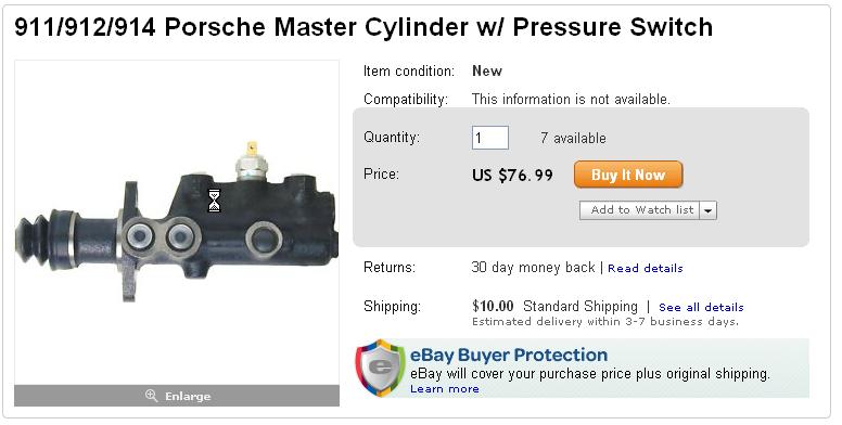

Is there any reason this master cylinder wouldn't fit my 1975 1.8L? The ad lists it as '72 and older only. They say the have only the ATE part ($309) for the 1975.
http://cgi.ebay.com/ebaymotors/911-912-914...s#ht_2274wt_996
Eric_Shea
I don't see any reason why not except that it's a Chinese MC and they had a very high failure rate (and it's retailing higher than most others sell them for). So much so that Pelican stopped carrying them (so I was told).
I'm not a big China hater but, in this case I'd probably use ATE and get the 19mm which is much less than the 17mm.
Their quality may come up in time... but I wouldn't want to guess with brakes.
