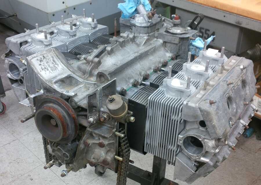

SuperTec head studs installed
Bartlett 914

QUOTE(gms @ Sep 2 2013, 10:57 AM) *
And they are beautiful! I cannot imagine one of those breaking. They look very strong!

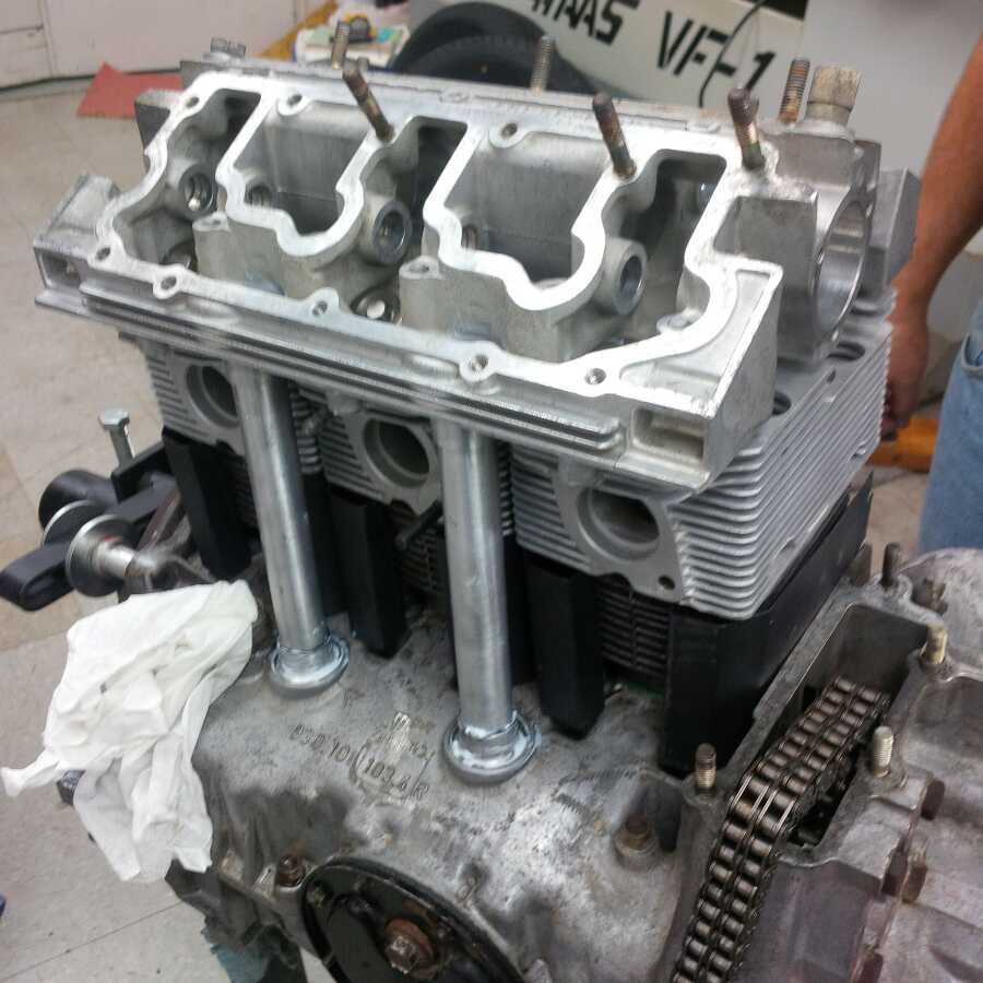

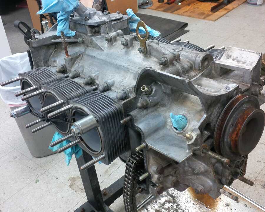

Mark K and I were working on the 3L again this weekend, got heads installed.
Since I had Alusil cylinders I just left the 9.3 to 1 pistons in and will upgrade the cams to Elgin 330s.

I had Henry at Supertec rebuild my 2.7 last winter, and am also glad to have the Supertec head studs installed as the engine previously had all Dilivar studs (supposedly the proper setup when it was last rebuilt in the 90s). They seem to really be a good answer to the head stud problems, and Henry gives a two year warrantee on his engines.
Did you use Casesavers on the block or otherwise reinforce the mounting points for the head studs?
gms
post Sep 16 2013, 02:00 PM
Post #166
Posts: 2,755
Joined: 12-March 04
From: Chicagoland
Member No.: 1,785
QUOTE(GeorgeRud @ Sep 16 2013, 01:38 PM) *
Not necessary on an aluminum block

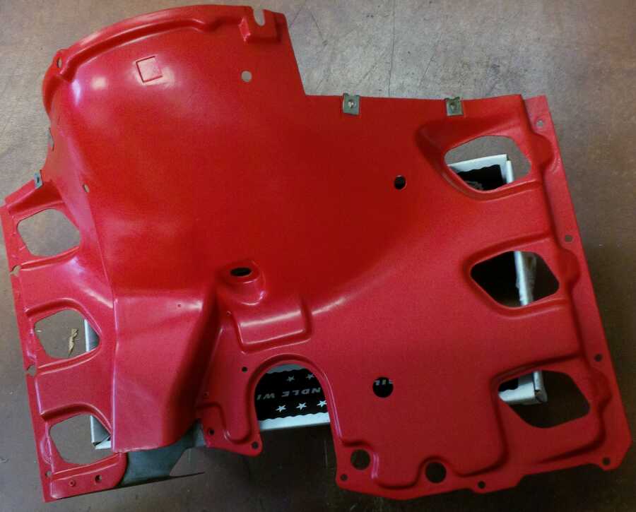

post Sep 20 2013, 03:46 PM
Post #168
Posts: 2,755
Joined: 12-March 04
From: Chicagoland
Member No.: 1,785

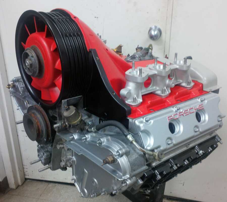

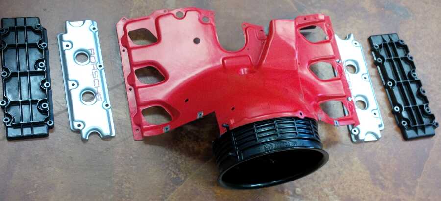

Painted the fan shroud and valve covers
gms

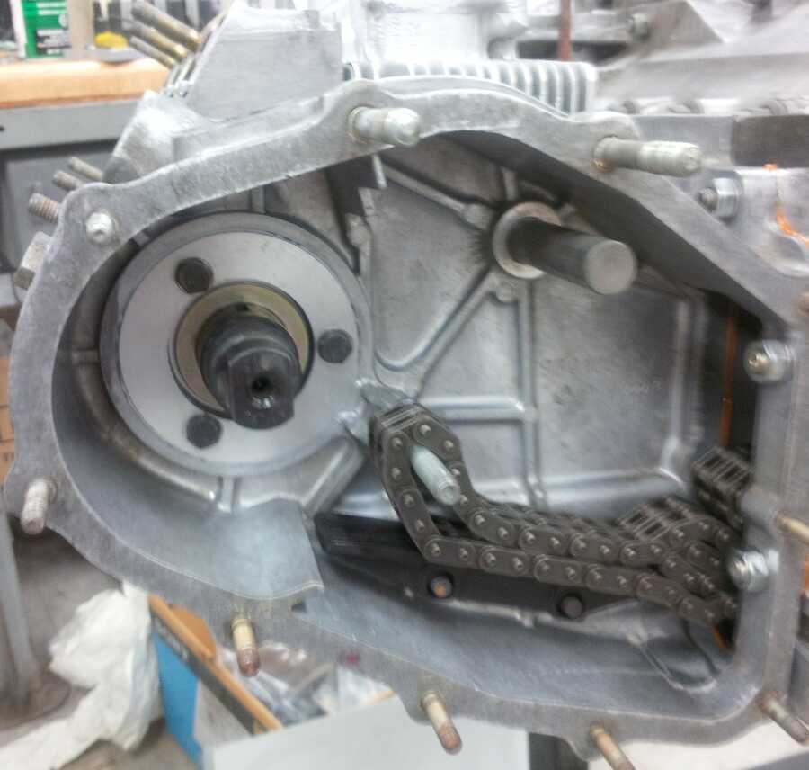

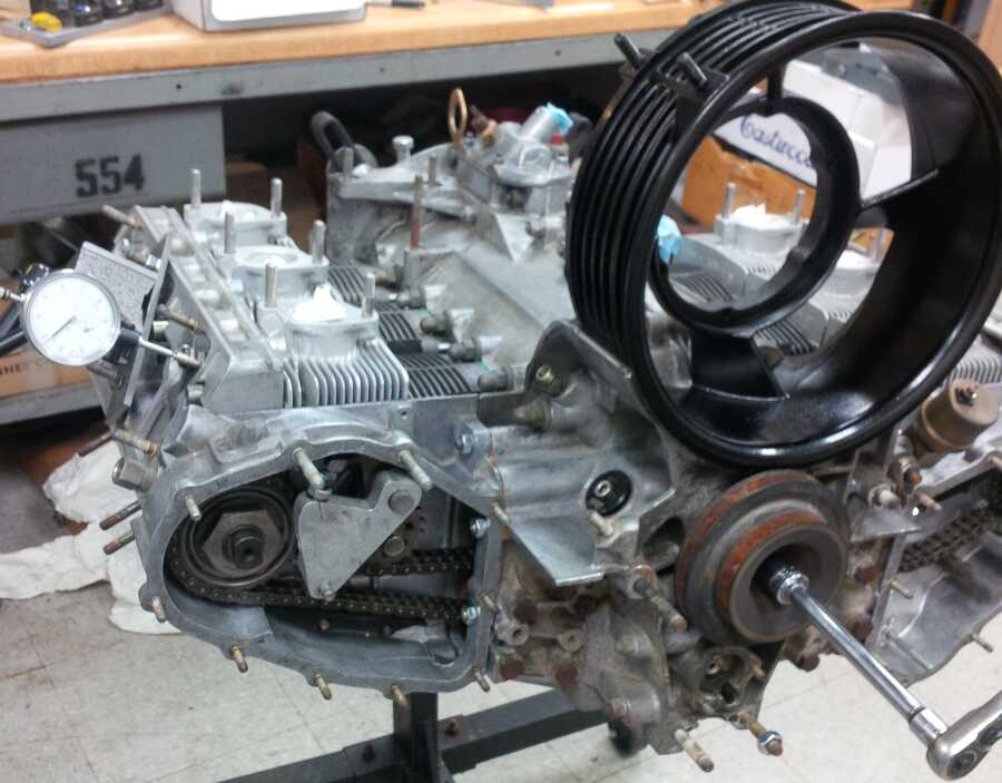

installed chain housings and timed left cam...getting closer!

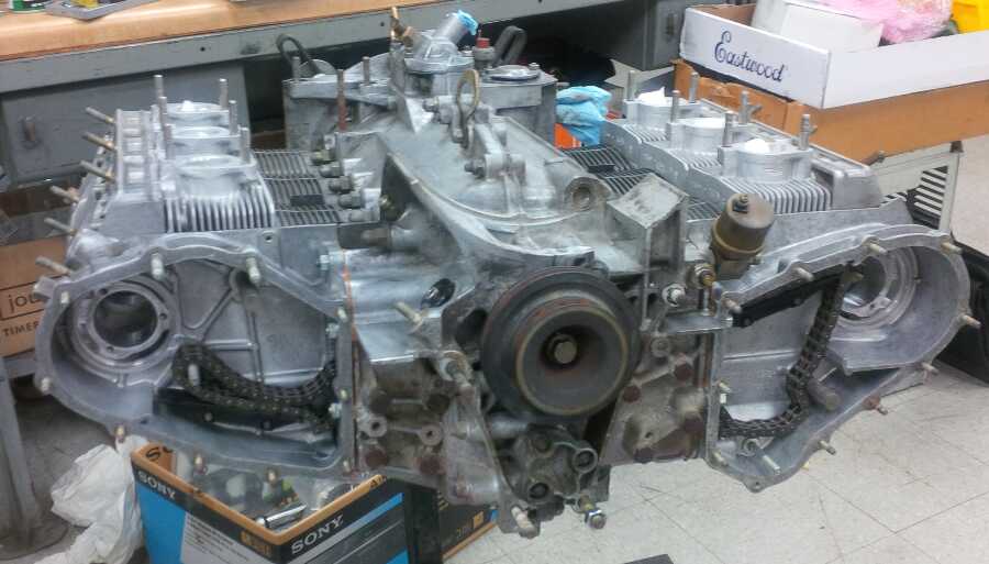

almost ready to install

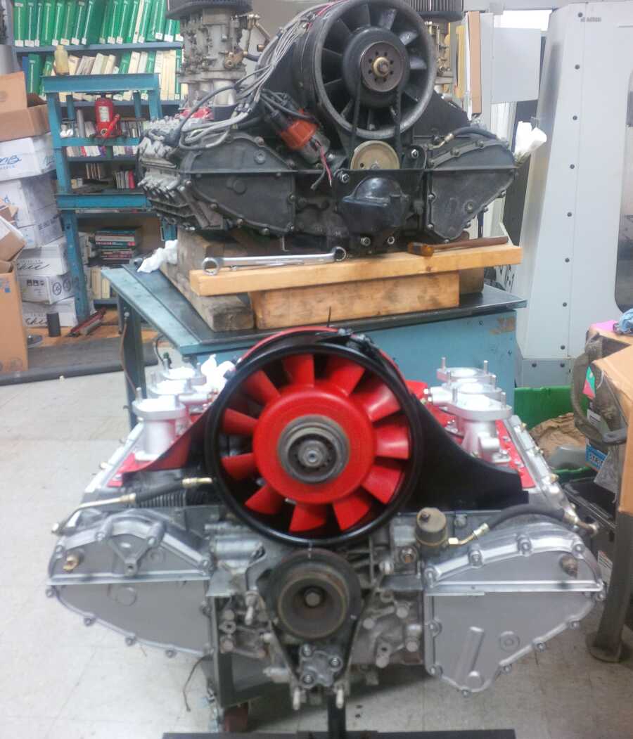

post Sep 25 2013, 09:15 AM
Post #171
Posts: 2,755
Joined: 12-March 04
From: Chicagoland
Member No.: 1,785

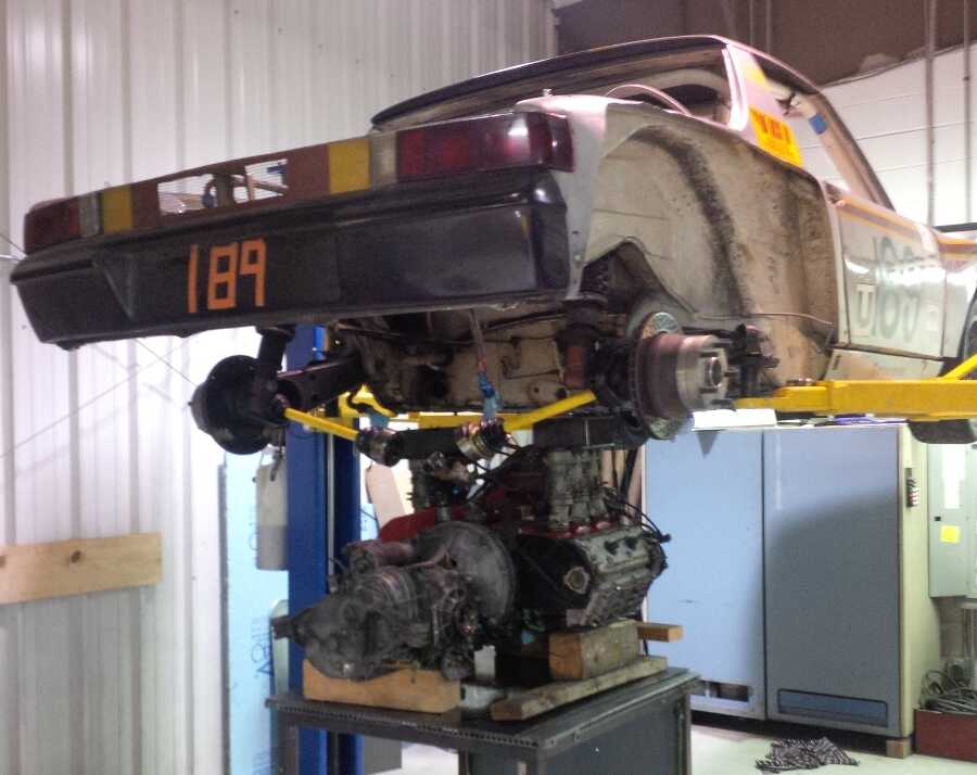

engine transplant surgery
gms
post Sep 25 2013, 09:20 AM
Post #172
Posts: 2,755
Joined: 12-March 04
From: Chicagoland
Member No.: 1,785
Out with the old and in with the new, this little 2.2L has served me well...time for more power.

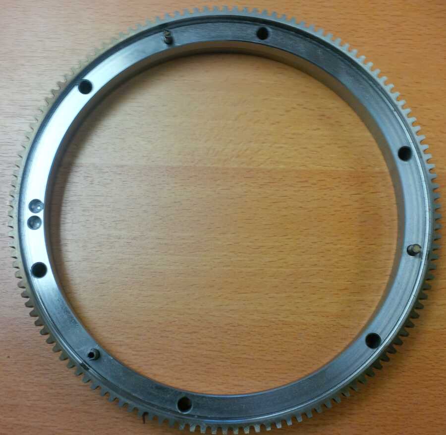

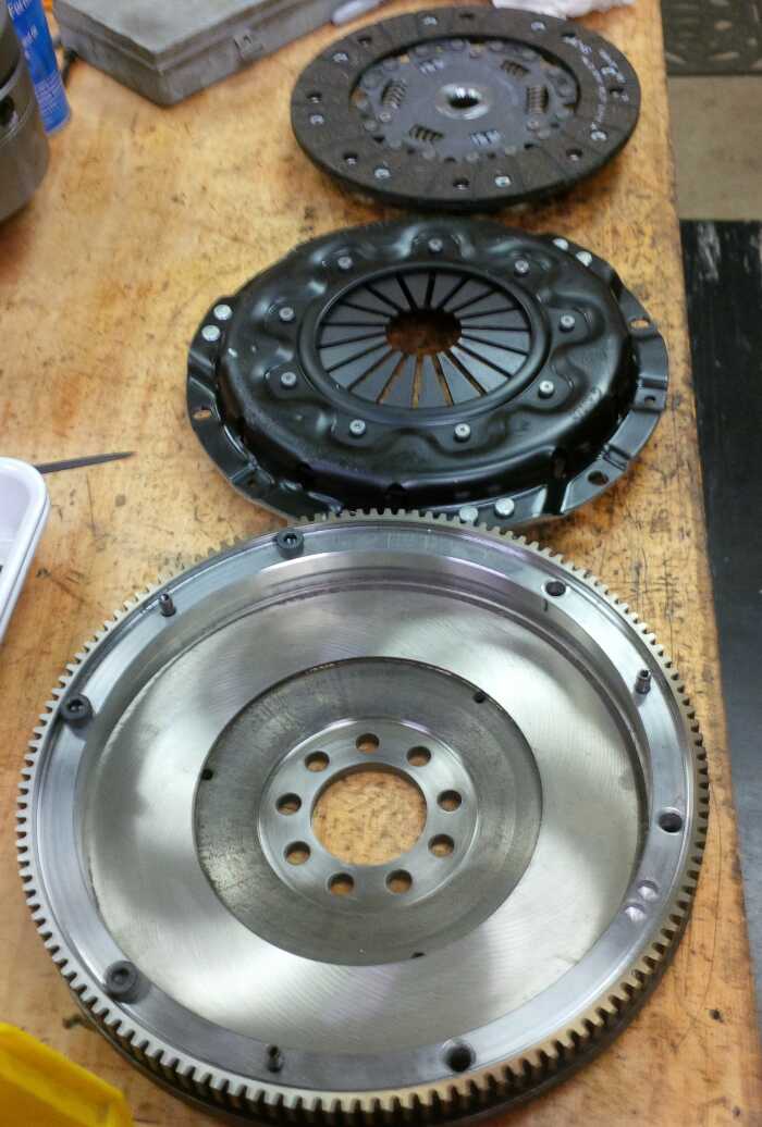

May I ask what kind of chlutch/flywheel combo you are going to use with 3L and 901 ? (IMG:style_emoticons/default/smile.gif)
I would also like to ask if those Elgin 330s cams are made from new cores or are they re-grinds ??
gms
post Sep 25 2013, 02:37 PM
Post #174
Posts: 2,755
Joined: 12-March 04
From: Chicagoland
Member No.: 1,785
The cams are regrinds and I am using a Kennedy flywheel adapter that turns it into a cup style. The clutch and pressure plate are the stage 2 also from Kennedy.

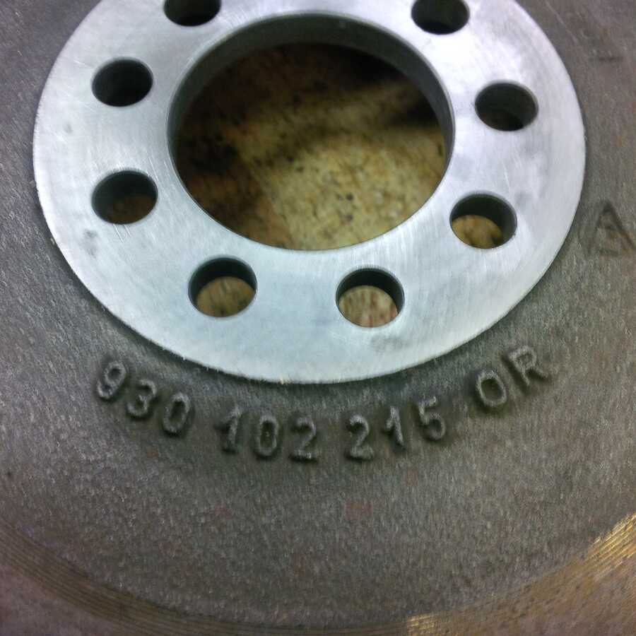

The flywheel is the 911 SC unit
gms
post Sep 26 2013, 08:36 AM
Post #178
Posts: 2,755
Joined: 12-March 04
From: Chicagoland
Member No.: 1,785
Here is the ring pressed into the flywheel and the Kennedy Stage 2 - 228mm pressure plate and clutch.
