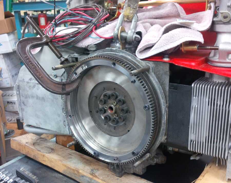

QUOTE(gms @ Sep 26 2013, 04:36 PM) *
Here is the ring pressed into the flywheel and the Kennedy Stage 2 - 228mm pressure plate and clutch.
Thanks Glenn. Very interesting pics. Never saw that kind of adapter before.

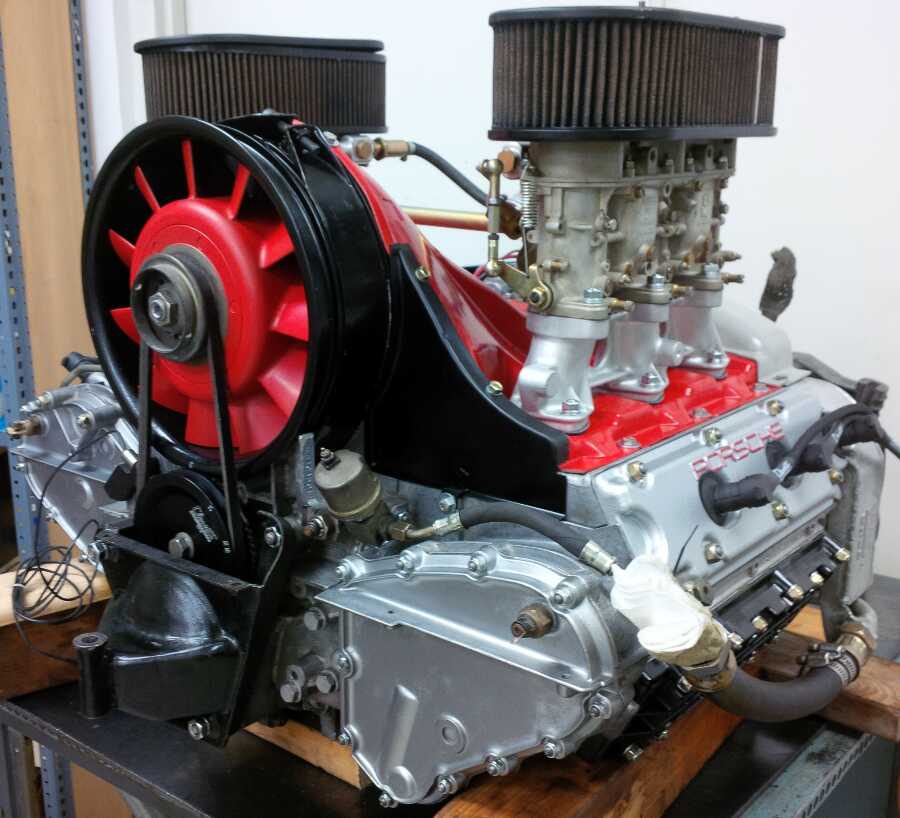

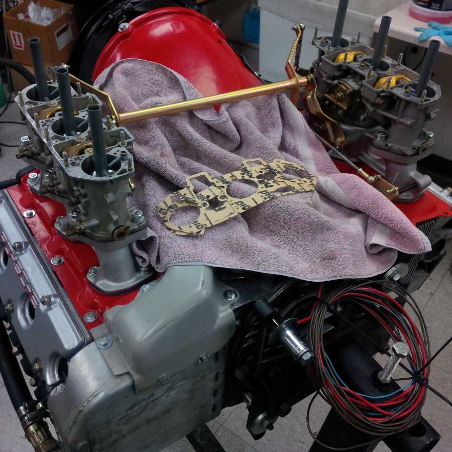

More progress last night, installed proper jets and venturis

this is the flywheel with the Kennedy adapter attached

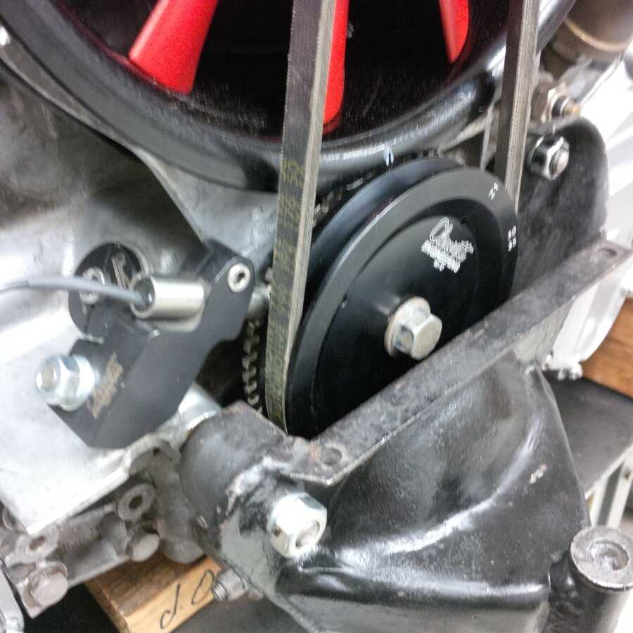

the XDi timing components

as she sits ready to go back in the car

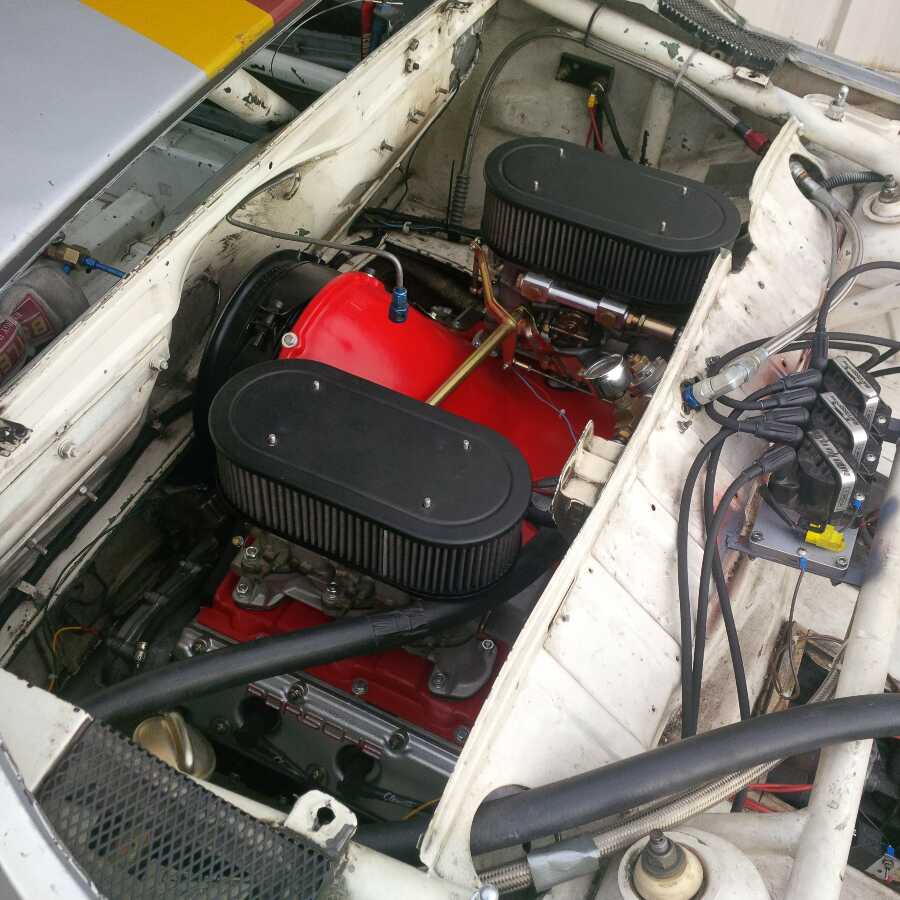

engine installed and ready to race tomorrow!
That's really nice set-up.

one last picture of the engine before it went in the car

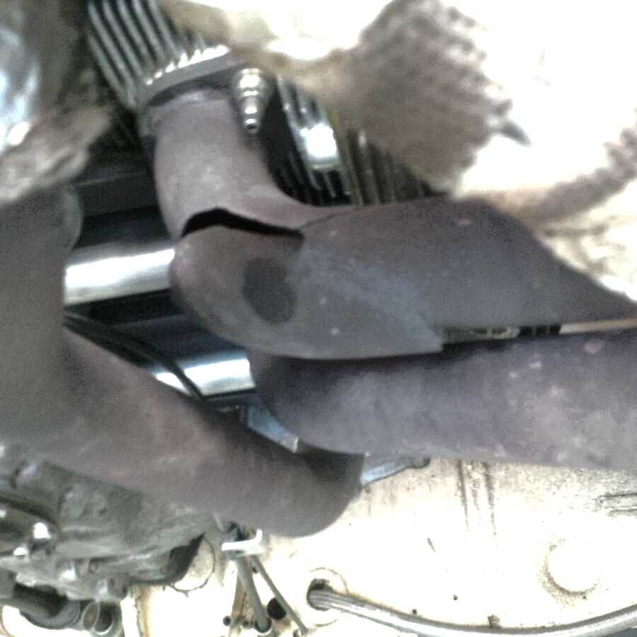

The race yesterday did not turn out well, I had the rev limiter set too low in practice and then the exhaust bracket came loose so i didn't get that many laps in.
I fixed the bracket and went out for qualifying then a header pipe cracked wide open before I finished the first lap. I did not get a whole lot of laps in but the engine feels strong but I still need to tweak the ignition advance and carburetors.

I just used the Weber 40 IDAs that i already had with 36mm venturis.
The ignition is XDi, there is and initial advance and 3000 RPM setting.

Sorry, I mean the "secundary venturis". I don´t know the right term, but I mean the "pipe" above the venturi. Number 68 in Weber Parts List How they are so tall ?? I thought only 46s have tall "secundary venturis". Or does they only look tall.... (IMG:style_emoticons/default/blink.gif)

yes those are the tall secondary venturis

here are pictures of the slit in the header pipe

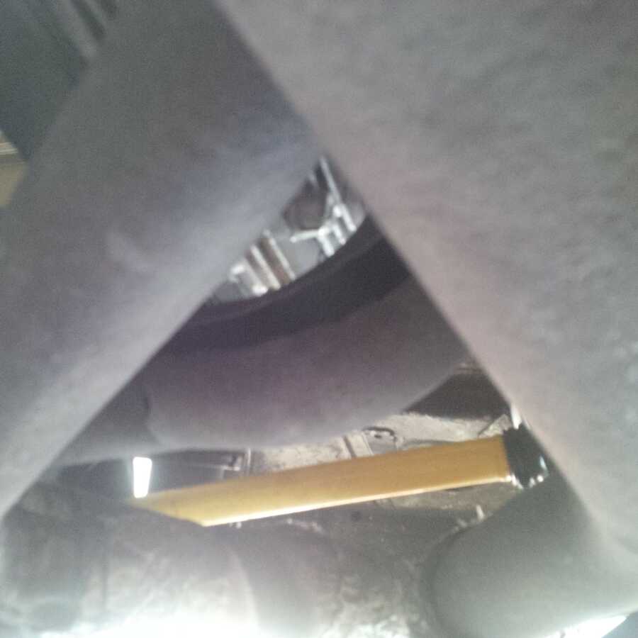

The last race of the year was last weekend and I had a great practice and qualifying
I had a nice start in the race and then the oil leak hit the headers only 1.5 laps than out. I did not have the GoPro running but a fellow racer posted a video, I am to the left.
That is my friend in the white mustang, his control arm broke...too scary
