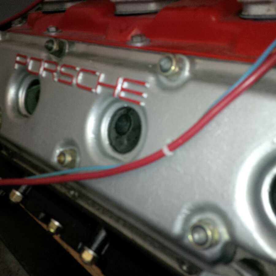

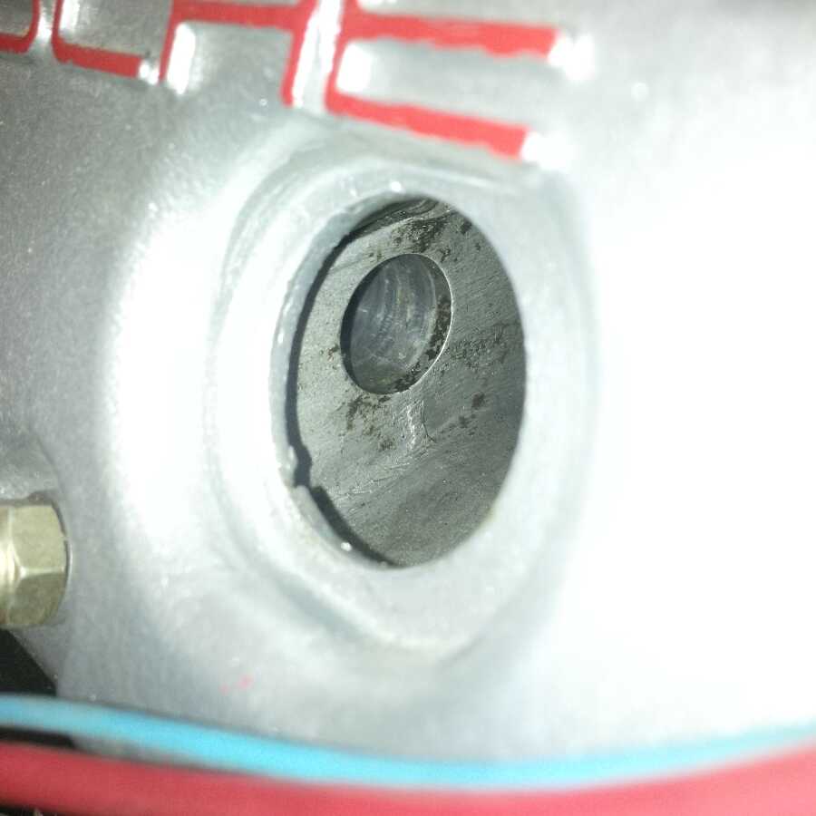

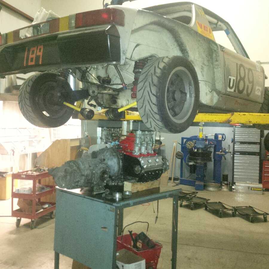

Today I pulled the 3L and found the source of the oil leak, it was one of the the rocker shaft. No one to blame except but myself (IMG:style_emoticons/default/headbang.gif)

3.2L is sealed up and ready for fan shroud and carbs!

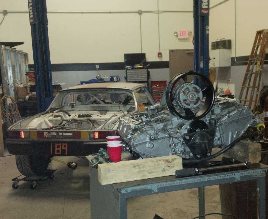

3.2L is in the car running and sounds great.

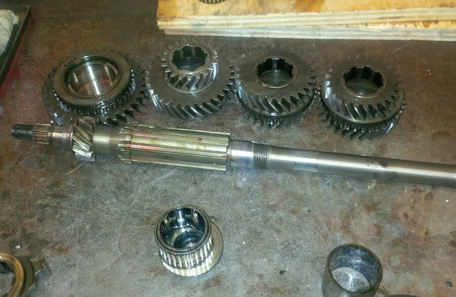

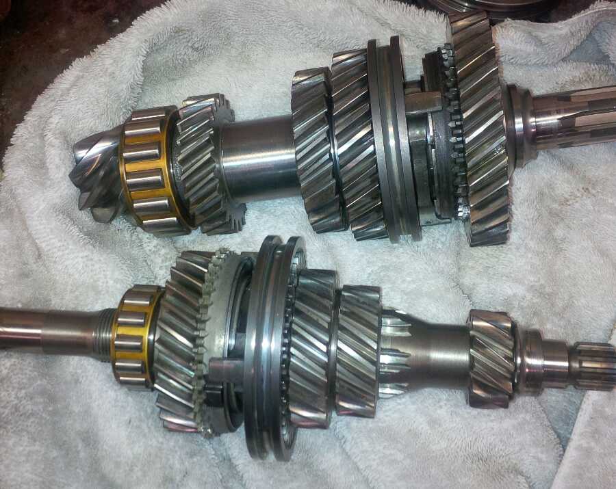

Had a good outing last weekend but the gears are all wrong so I installed M-S-X 3rd 4th and 5th gears for the next race

Glenn, good job !! what is the blue wheel machine in the back ground ???
gms
post May 12 2014, 09:13 AM
Post #226
Posts: 2,761
Joined: 12-March 04
From: Chicagoland
Member No.: 1,785
QUOTE(sixnotfour @ May 12 2014, 10:10 AM) *
A lehigh SR-2410 wheel straightener

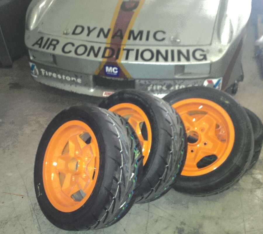

Baby got some new shoes!
Toyo R888s mounted up

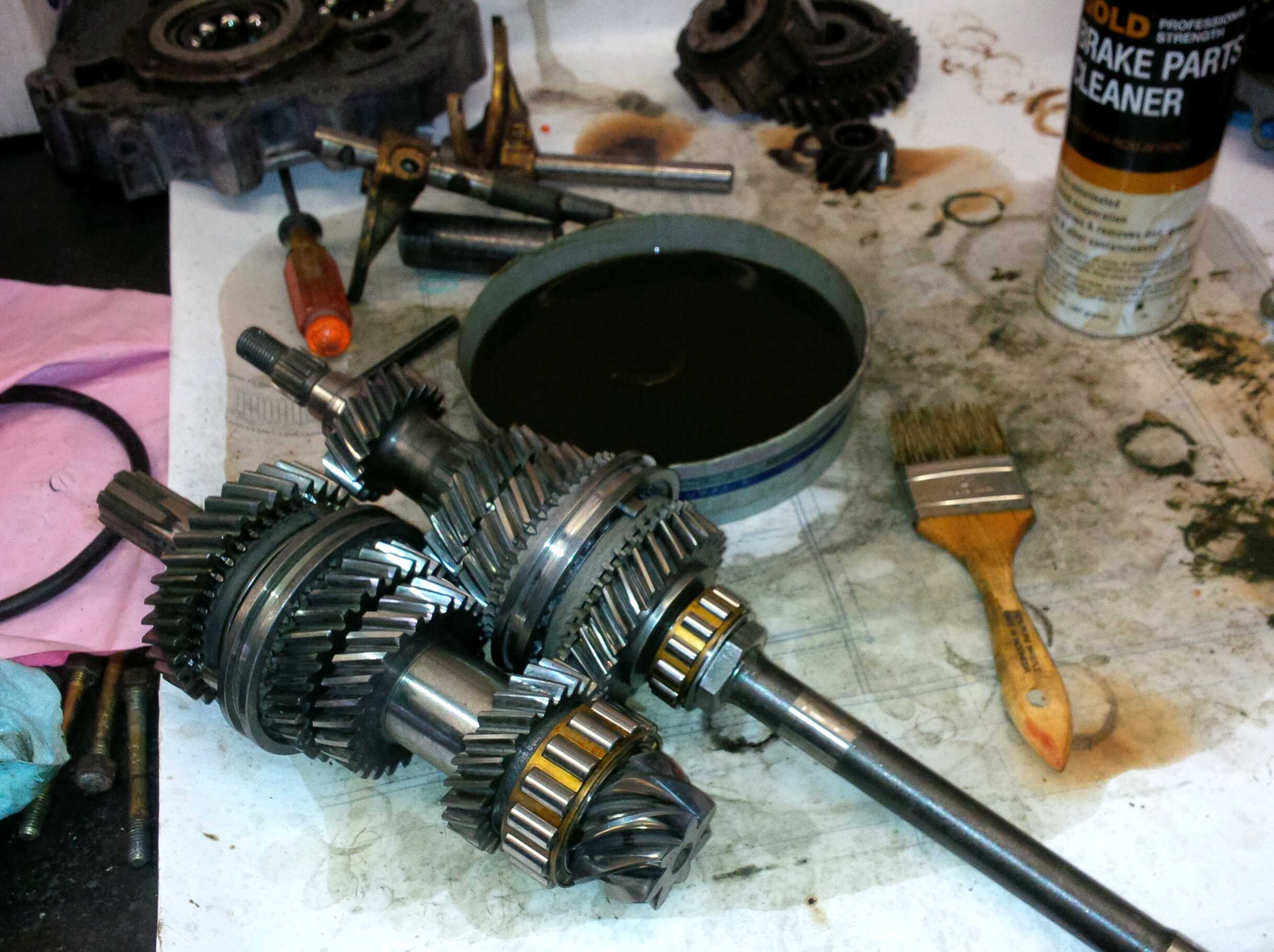

Last minute changes to the gears, I checked the gearing spreadsheet and the M gear looks to be too low.
I found a 912 4-speed with A-H-Q-X gears, I used the A , H and X then replaced Q with a P ratio.

QUOTE(gms @ May 20 2014, 05:18 PM) *
With those wheels you will look faster!
With the new tires you will be faster.
Looking forward to this weekend! (IMG:style_emoticons/default/piratenanner.gif)
