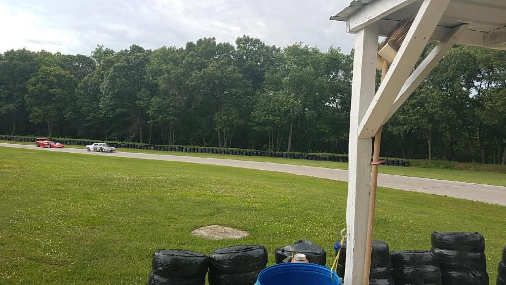

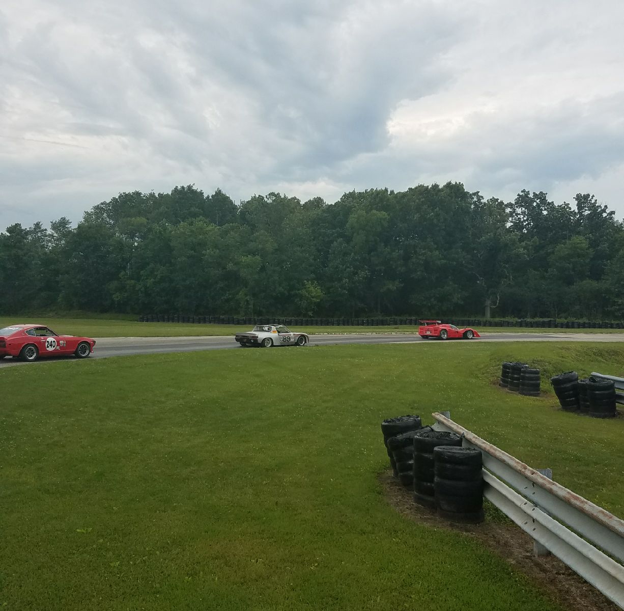

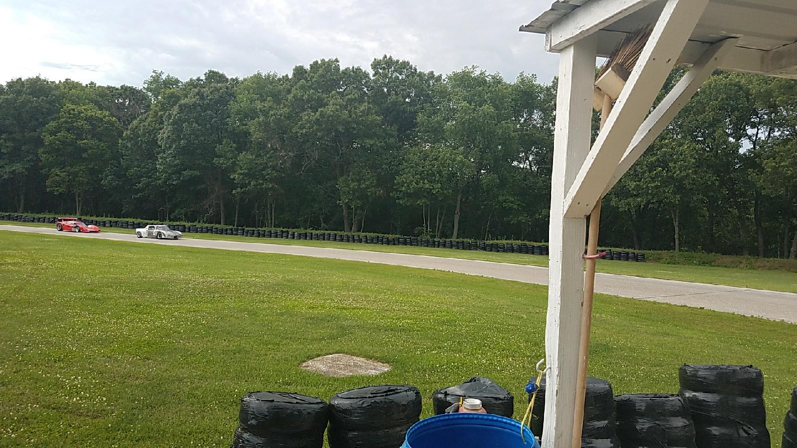

I was out this weekend and my sister (the professional photographer (IMG:style_emoticons/default/biggrin.gif) ) took some pix.
I qualified 2nd

The Manta (kit car) missed a shift and I got by him for the first time ever!!

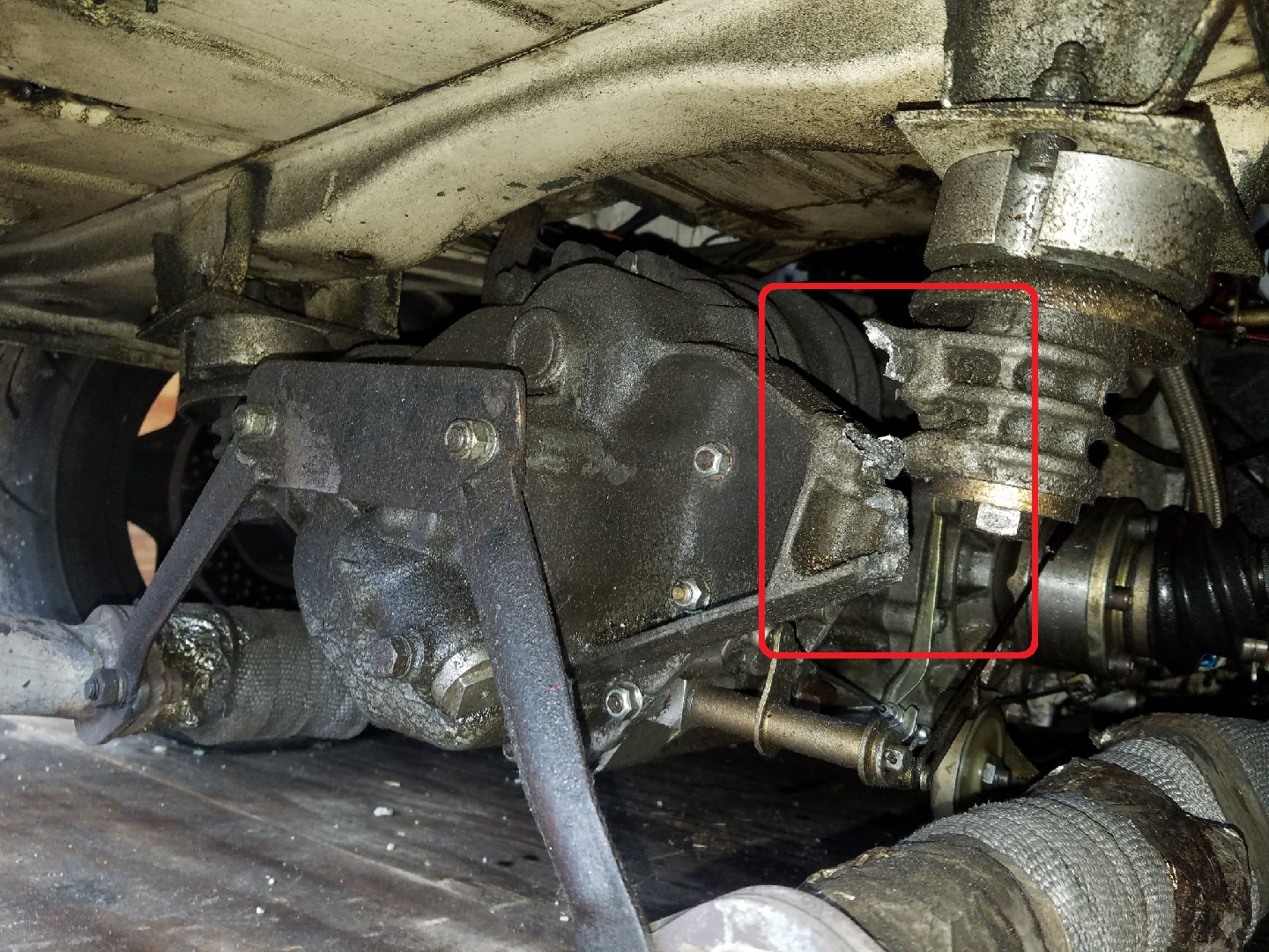

and then as luck would have it the transaxle ear broke and I was done

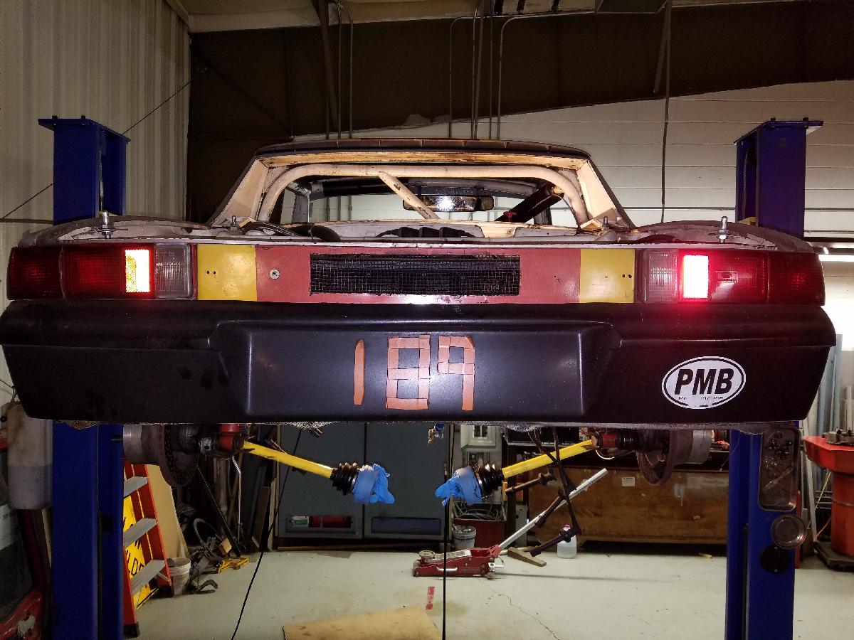

Mark Kinnaman and Mike Bednar were kind enough to help yesterday, we pulled the engine and replaced the cover. I have a HPDE on Friday so it needed to be done fast. We pulled the engine because when the ear broke it disconnected the crank case breather hose and the was oil everywhere.

a'yup - happened to my oem 914-6 transaxle 'way back in 1976 when my bro' hit a huge pothole at speed - same side; except it did not result in the oilbath (hose must'a been longer);
- found a guy who welded magnesium (-6 covers being nearly unobtanium ) - and it held for the next 15 yrs i ran it

What ?
Had it been broken and welded before ?

QUOTE(rgalla9146 @ Jul 4 2017, 09:15 PM) *
What ?
Yes Rory good eye that ear was welding (not sure what i was thinking when i installed it)
The first replacement that I grabbed had a hairline crack in the same area so I found another. car is in the trailer and ready to run, I am doing a Porsche Club DE at a track I love...Autobahn South Course. Thanks Mark Kinnaman for helping I would have never made it without him.

QUOTE(Larmo63 @ Jul 6 2017, 11:48 PM) *
Looks good, Glenn....I guess we must remember that our cars run on parts that are only 45 years old!!!!
(IMG:style_emoticons/default/first.gif)
Thanks!
That is the truth, I never even checked the trans housings and trail cover but I will from now on.

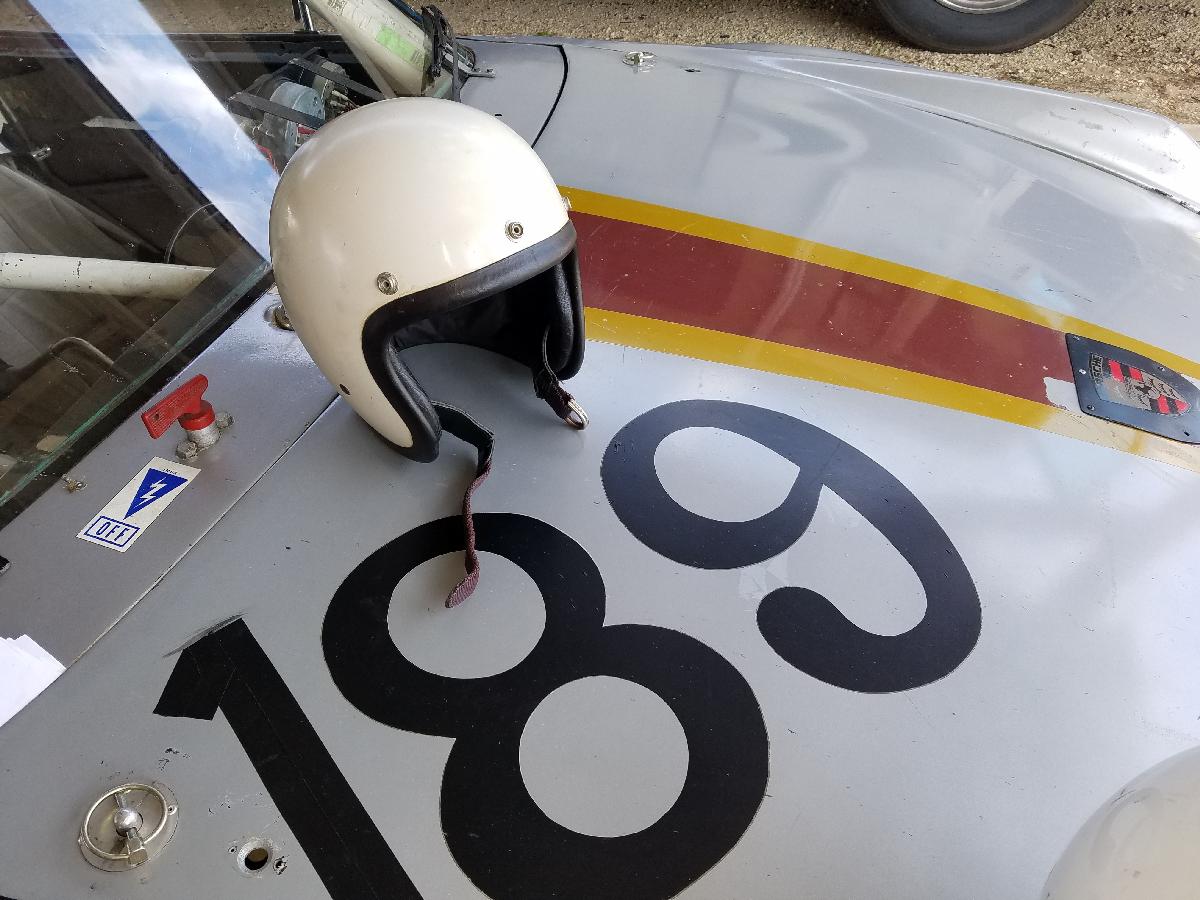

My friend had his first helmet from the early '60s at the track with him on sunday.

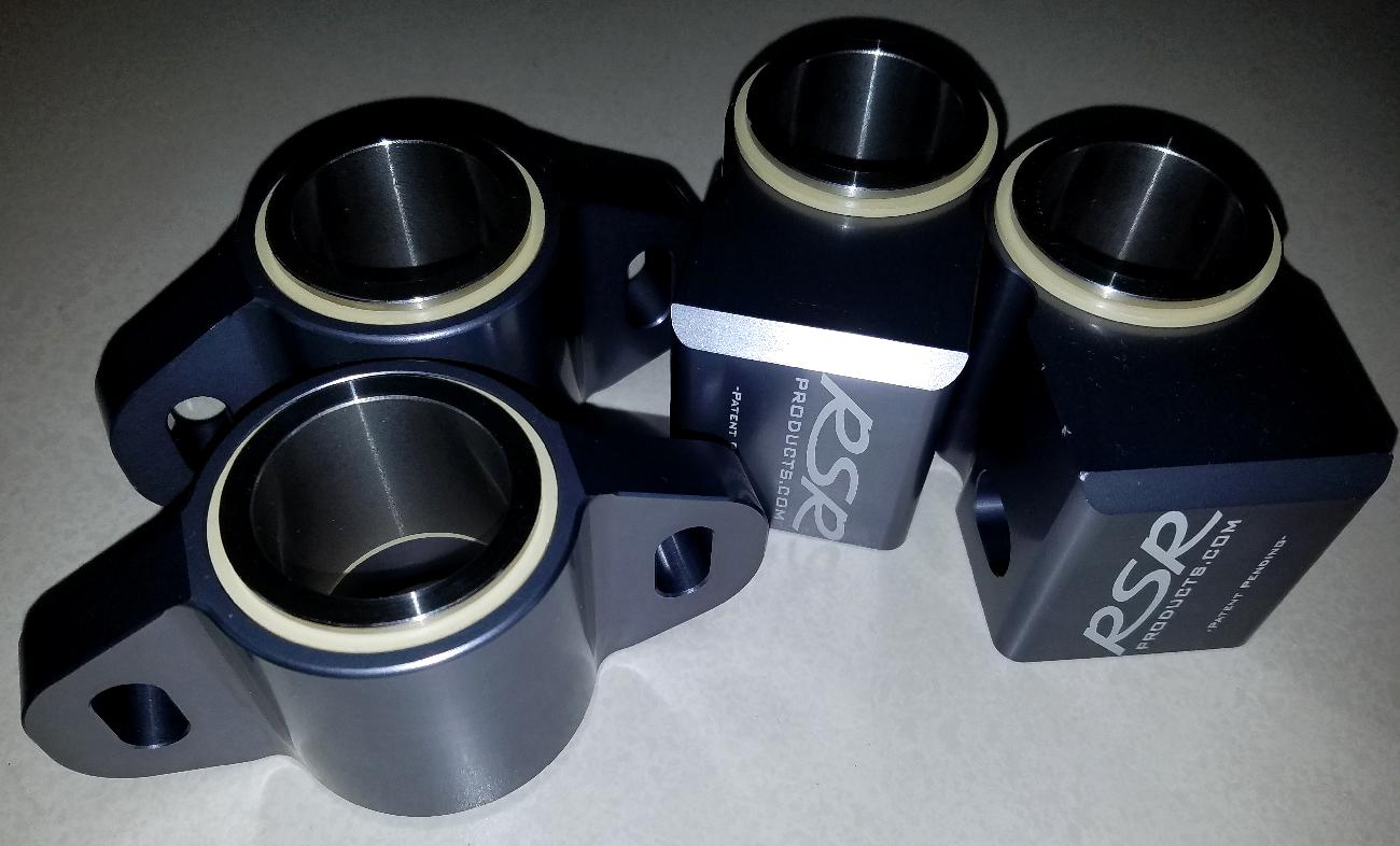

New project, renew front suspension!

Wonder if the solid trans mounts contributed the failure?

QUOTE(pete000 @ Jul 13 2017, 10:35 PM) *
Probably, I should not have used a welded/repaired cover
