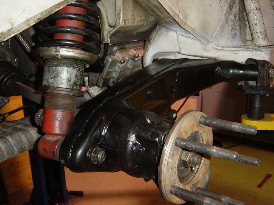

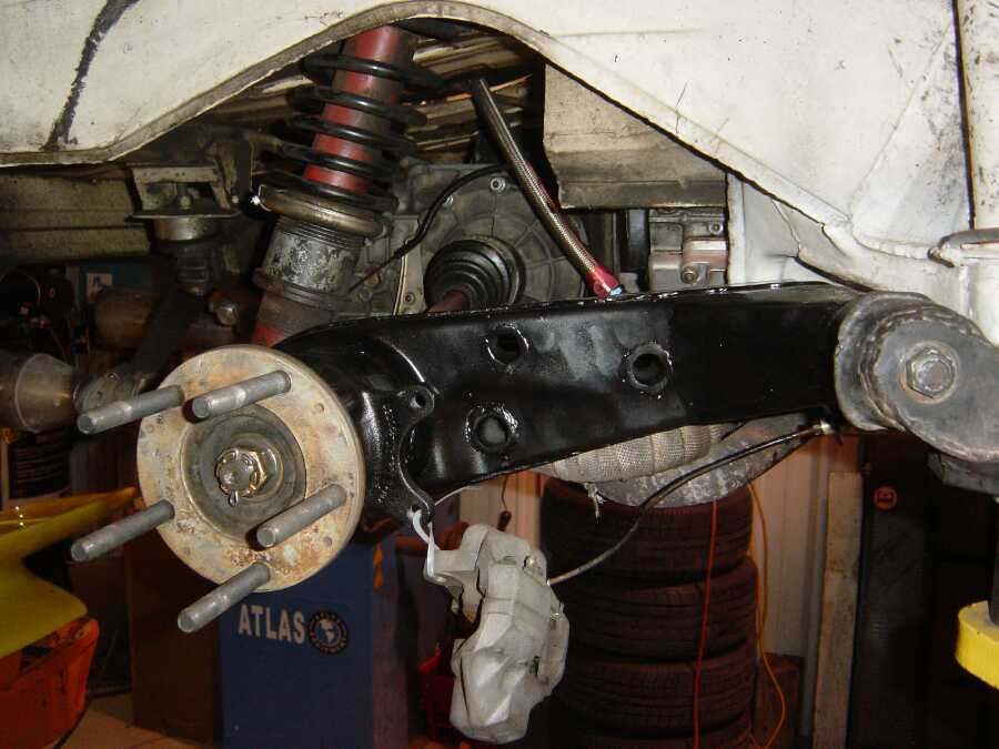

I was trying to align the rear of the car and could only get tow-out on the passenger side. Pulling the trailing arms exposed an old rubber bushing and a worn plastic bushing. I was convinced the passenger side was bent.

I did a little reinforcing

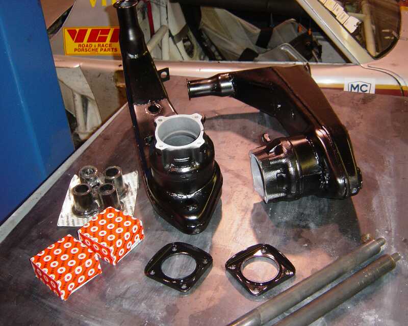

Glenn what are going to use for bushings ?

I already threw some Weltmeister bushings (until I build with solid metal)
Bearings provided quickly by PMB thanks Eric!
