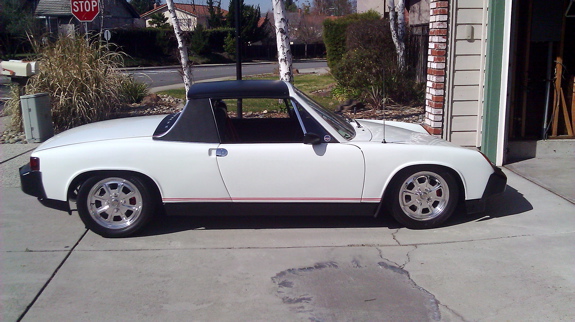

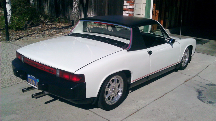

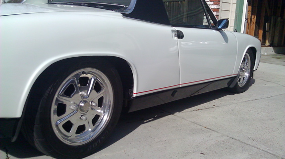

Member No.: 2,880
205x50x15s on 5.5" Factory Fuchs (IMG:style_emoticons/default/biggrin.gif)
Dunlop Direzza Star Spec Z1s
