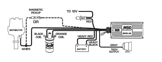

I'm changing engines and lost the paperwork for my MSD box.
Does anyone have instructions for connecting MSD 6AL to one-wire '87 930 distributor? |
LaughaC Connecting MSD 6AL to one-wire '87 930 distributor? Mar 24 2011, 11:31 AM
iamchappy I believe it is MSD wires Purple+ , Green- / Distr... Mar 24 2011, 12:23 PM
moparrob http://www.914world.com/bbs2/uploads_offsite/i954.... Mar 24 2011, 08:57 PM![]() ![]() |
