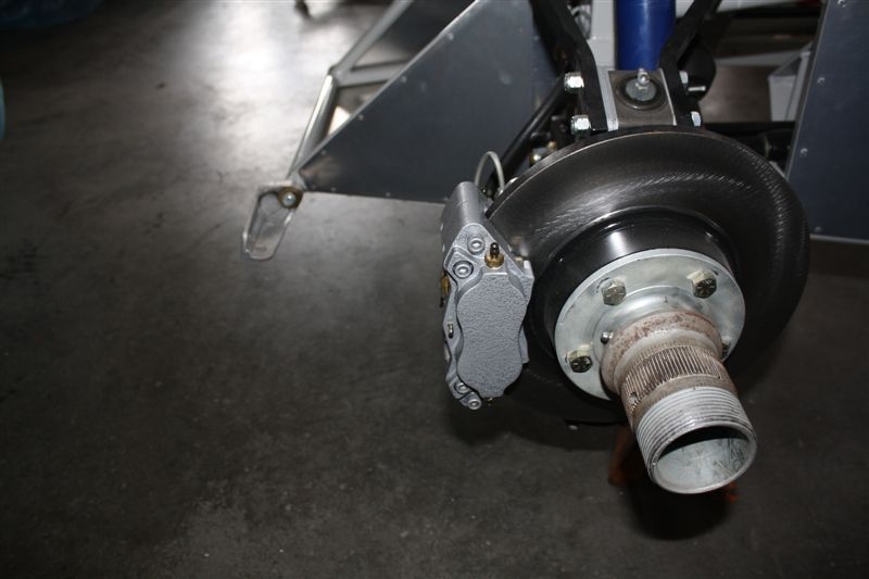

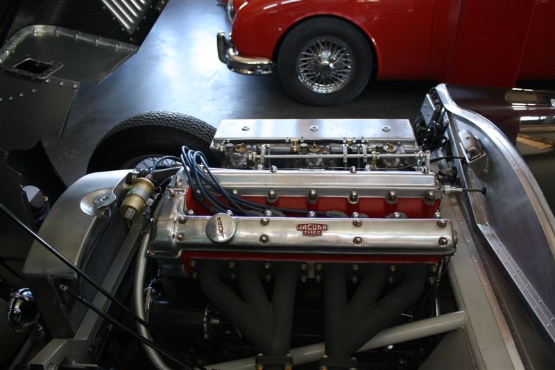

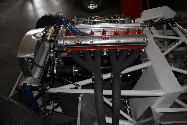

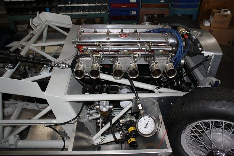

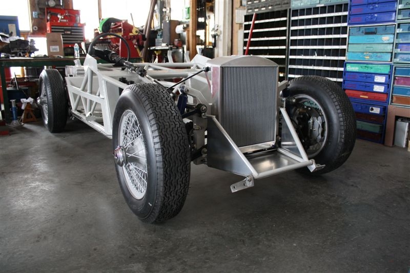

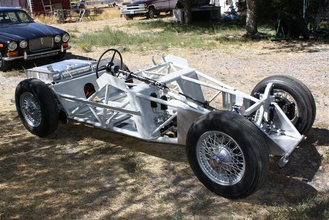

It is a 3.4L, punched 40 over, using series 3 XJ cams. All other internals are C-Type “correct” and fully polished as per the original. Approx 9.5:1 comp, triple 45’s and a lightened flywheel, wet sump. At sea level, the motor dyno’d at 340hp. The original cars maxed at 220hp
Here is a picture of the nearly completed chassis. The only deviations from stock are the two upright blades at the cowl (needed for the non-stock body) and the brake calipers/system and pedal cluster. We are hoping to do some machining on the pedals to at least make them the correct shape. Notice we already had the Wilwood logos machined off of the calipers. Finding the correct 1953 calipers on for the first car to use disc brakes at Lemans was simply not going to happen.
The one bummer about the car is that it has two doors – which is totally wrong for the cars that ran Lemans – they only had a driver side door. The molds for this body were taken off of the red 1953 Mille Miglia car which had the two door set up. -

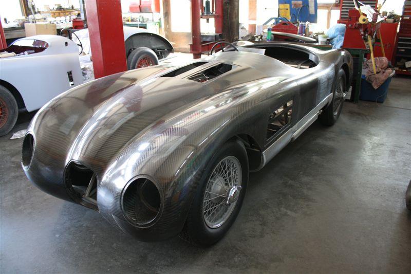

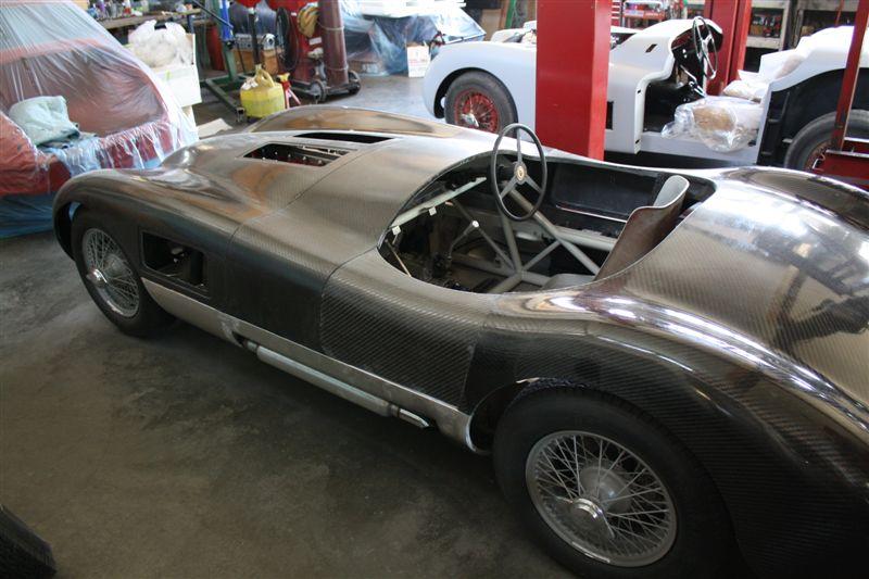

Litterally just received these pics - body is finally mounted on the chassis. After seeing it assembled, I am again going back and forth with my brother on if we should paint it, clear coat it, or maybe a clear coat tinted with british racing green. Kinda fun.

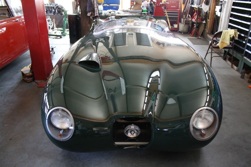

here is what it would look like fully painted.
I got the idea of the tinted clear coat from this Bugatti.
I dont know. The stealth factor might be the best bet - i.e. having the car look stock until the hood is opened (we are definitely not painting the underside of the front clamshell). The motor came out great, so it will still be pretty neat with the hood up.

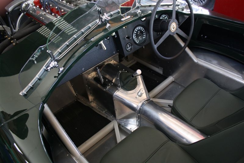

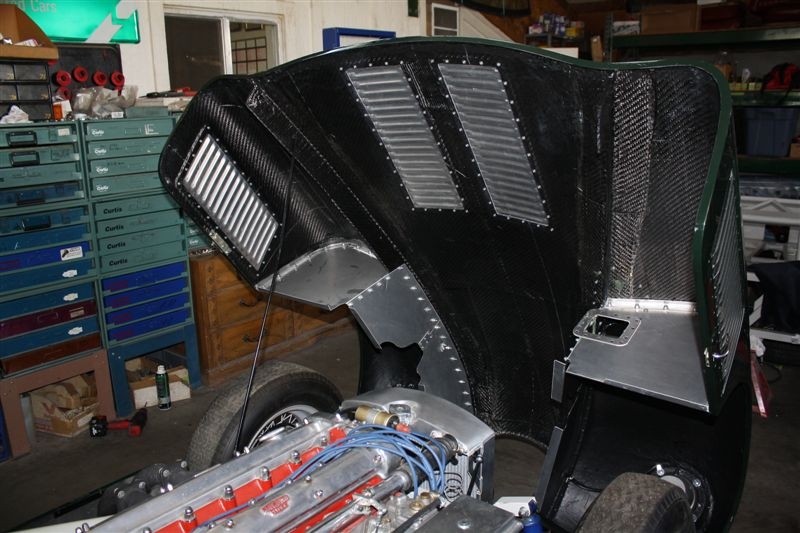

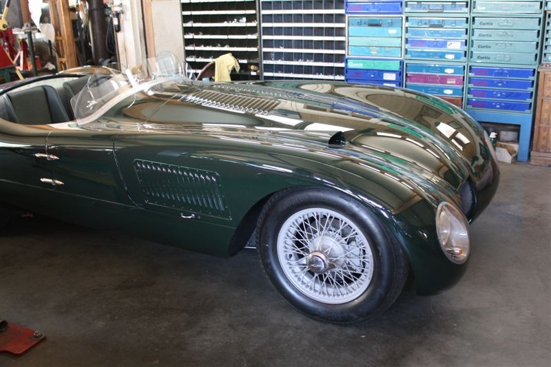

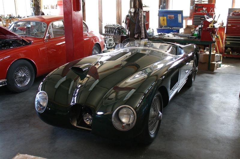

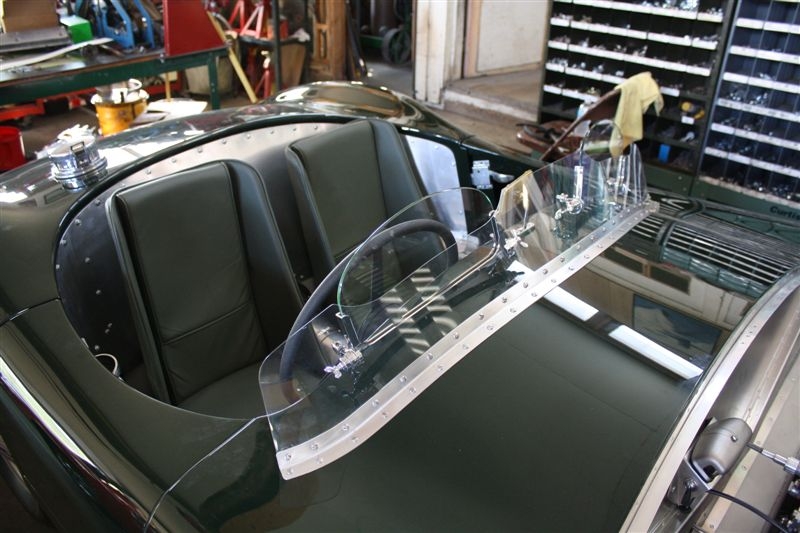

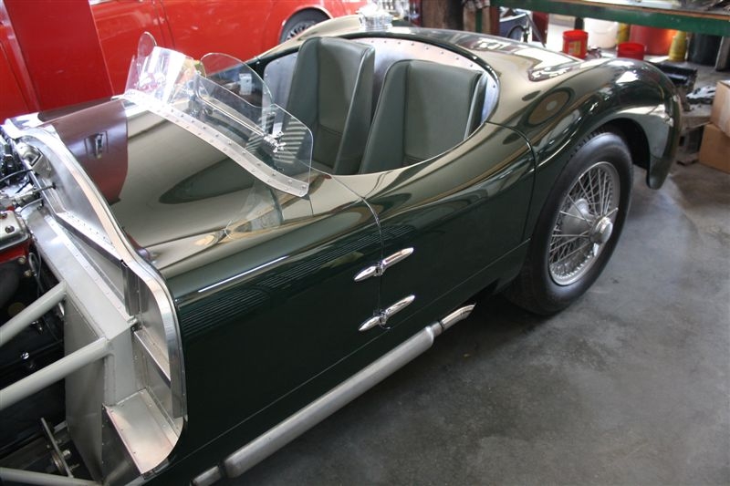

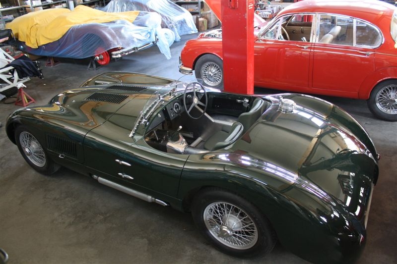

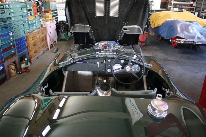

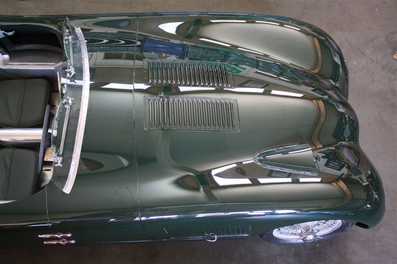

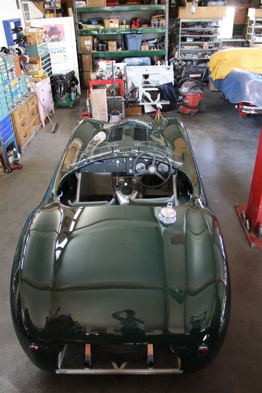

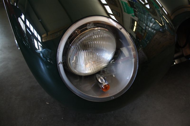

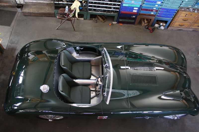

Well, here she is. The c-type is finally done (less the front grill and rear trunk lid/spare tire cover being installed).
It has been just over two years. Many of the delays were self inflicted - I really wanted the details to be spot on. Love the little junk - things like the gauges/switch gear, the wiring, the work light on the firewall, the "Mille Miglia" 8" lucas driving light behind the grill, the gasket around the air intake - none of that junk sounds like much time, but it all adds up.
The steering wheel is finished wrong - it should be smooth and shiny. I will get that fixed locally. I also need to source the correct loom material for the plug wires. Other than that, I am very very pleased.
Here are a pile of pics - enjoy!

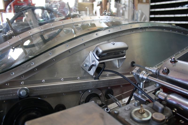

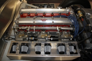

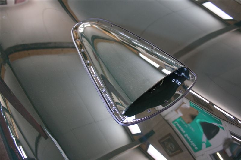

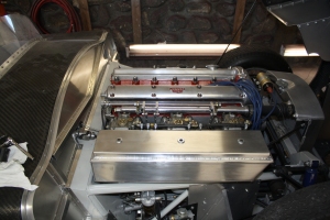

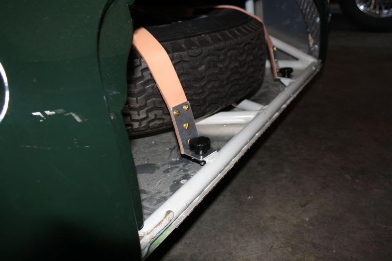

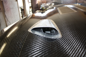

Here are a couple more. I thought this was extremely cool. On the original car, the air scoop on the hood was a direct feed to a box over the carbs - no air filter at all.
On this car, I had the air box made just a tad bigger to allow the fitment of individual cone filters. It looks completely stock from the outside - you would have to measure the box to know it was not correct. Kinda slick.
Scott S
post Sep 4 2012, 05:39 PM
Post #39
Small Member
Posts: 1,698
Joined: 30-April 03
From: Colorado
Member No.: 633
The square hole on the right side of the car in this pic is where the air intake interfaces with the air cleaner box....
