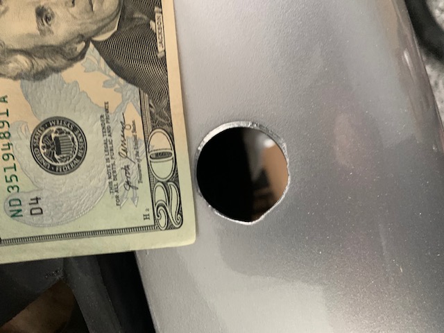

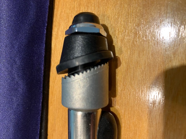

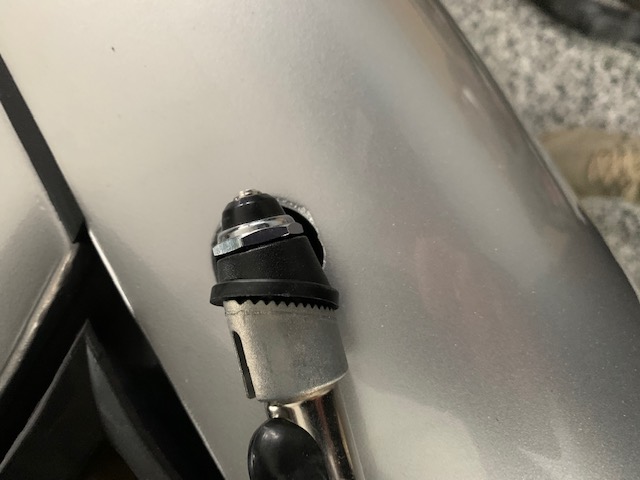

I bought the RIGHT antenna - it came with the wrong mounting hardware.
Hole Size - around an inch
Hole is too big
45 Degree mount?
Do I haggle with the vendor for the proper hardware? Buy a new one? What does the right hardware look like?

many different antennas were installed by the dealers, often times the cheapest they could buy from a supplier to make money selling to the new 914 buyer. The one that should go with the car is a hirschmann mounted on the left front fender just in front of the door. It has a small hole and dedicated hardware. If your hole is bigger, it was drilled for one of these who knows what, aftermarket antennas and there is really no hardware to correct it, but rather find an antenna that fits the larger hole.

Thank you George - very good - will do.

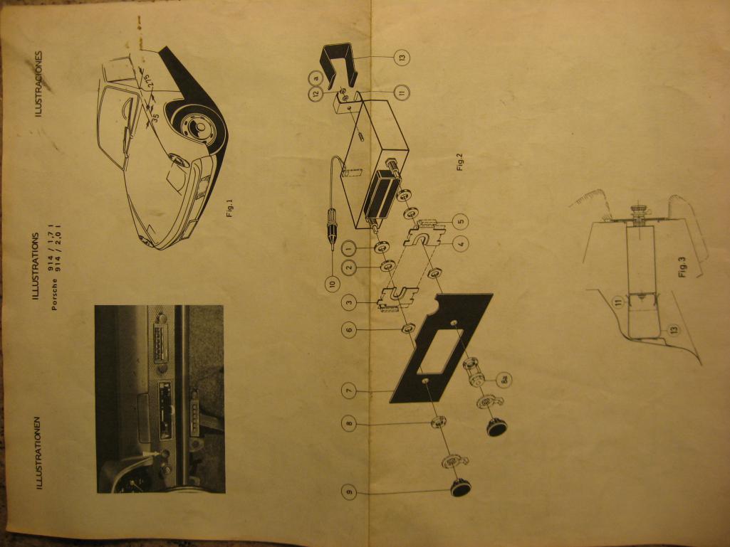

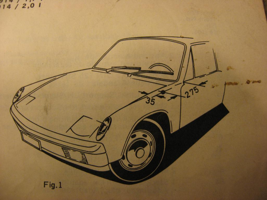

All 914's have two factory holes on the drivers side that are there for only one reason. Antenna installation.
One is on the drivers inner fender, it always has a rubber plug from the factory.
It's for the wire to extend into the wheelwell.
The other hole is in the vertical pinchweld behind the tire. It's for a bracket that supports the antenna. See pic.
There is also a factory diagram showing proper location of hole in drivers fender.
I'm looking for that photo.
