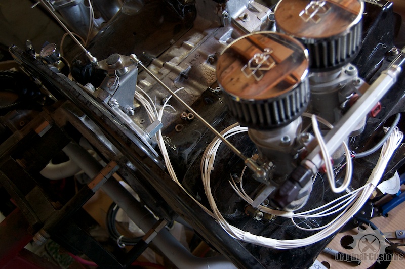

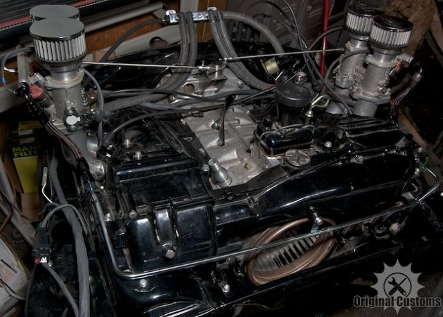

This motor is a 2432 Raby kit. It uses the LE200 heads and stock 2liter cylinders. The stroked crank is 84mm I believe so think of it as a super-stroker. It will run Jenvey throttle bodies and SDS injection. The EFI sensors I have chosen to use will be TPS, CHT, MAP, IAT, O2 in closed loop, and I think that is everything. Injectors are Ford Red Top. This motor requires quite a bit of engine block clearance so as they say, don't try this at home...
It took me about three trips down to Original Customs to put the engine together. I used McMark's shop so I could get his free advice which he of course charges me for, and I don't get distracted by wives wondering how much all of this costs. Plus Mark has an engine break-in stand that allows us to fire it out of the car and correct anything that might be wrong without having to pull an already installed motor.

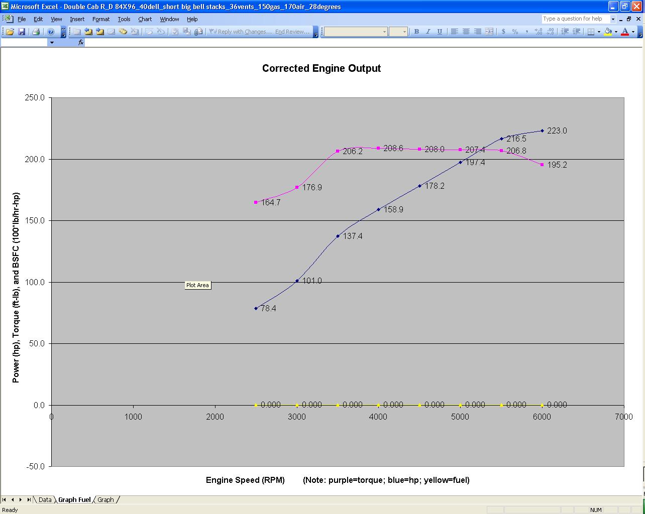

Here is a dyno sheet of one of these motors that Jake actually built. I would expect that my result might be within 10% of his. :Insert fingers crossed smiley here:

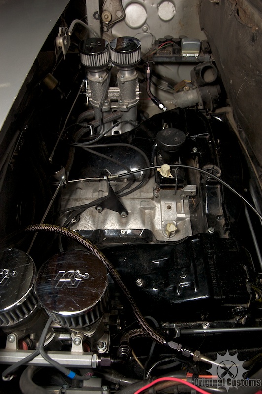

ConeDodger   Jenvey throttle bodies   Apr 2 2011, 03:16 PM
ConeDodger   Custom air cleaners using K&N filters designed...   Apr 2 2011, 03:17 PM

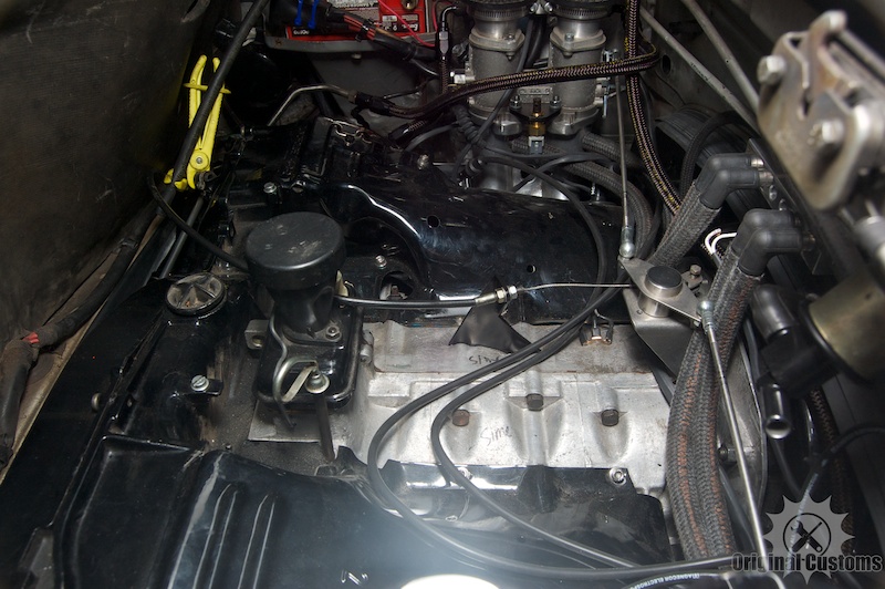

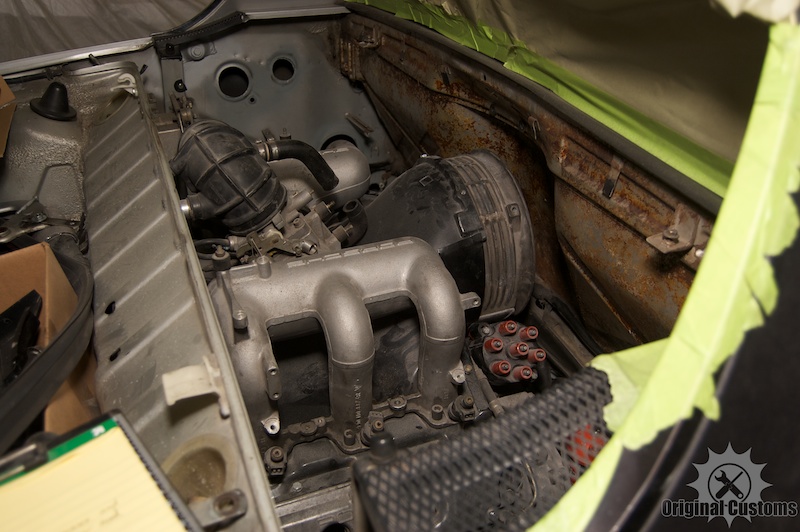

ConeDodger   Here are some random shots of the engine as it goe...   Apr 2 2011, 03:24 PM
ConeDodger   Here is a close-up of just how much spacer you nee...   Apr 2 2011, 03:25 PM

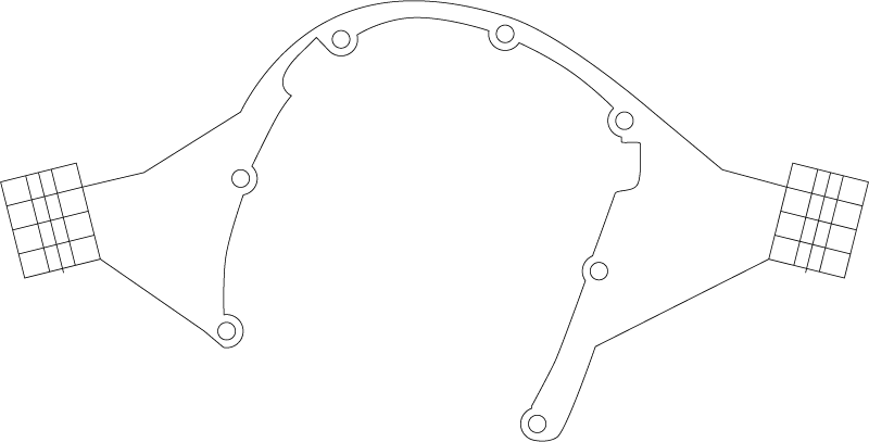

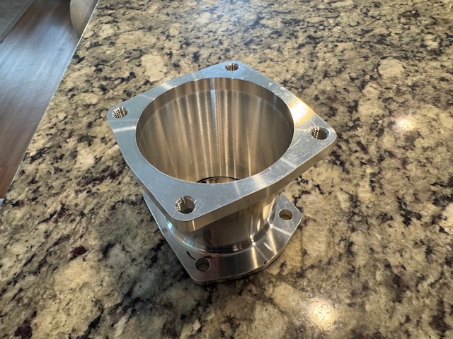

ConeDodger   This is an idea I had which I ran by McMark. He di...   Apr 3 2011, 10:31 PM
PeeGreen 914   Jeff does some really cool stuff. Can't wait t...   Apr 3 2011, 10:35 PM
ConeDodger   Jeff does some really cool stuff. Can't wait ...   Apr 3 2011, 10:47 PM
PeeGreen 914   Excellent idea. I always hated the BS engineering ...   Apr 3 2011, 11:09 PM
ConeDodger   Excellent idea. I always hated the BS engineering...   Apr 3 2011, 11:12 PM

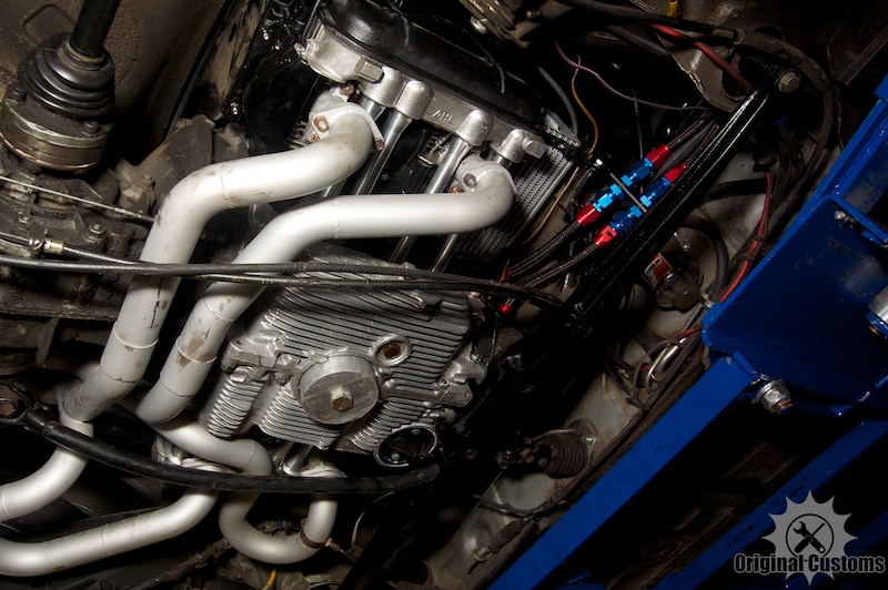

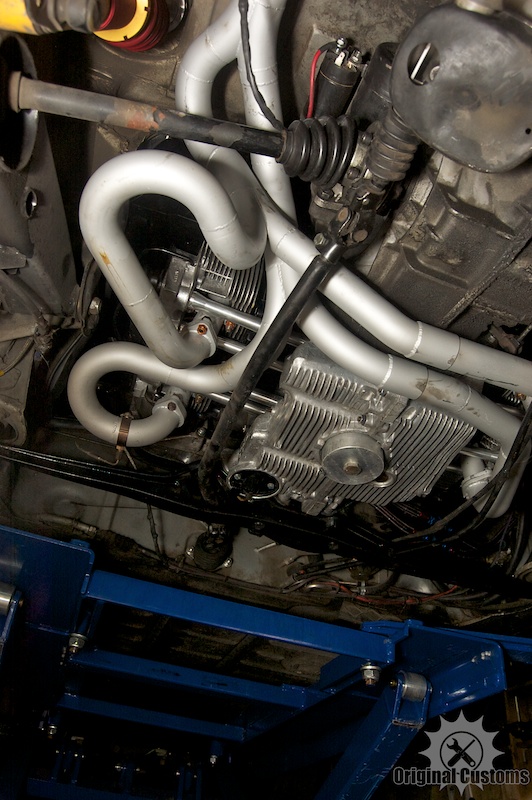

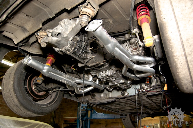

Dave_Darling   So, any idea why the #1 exhaust pipe got so hot? ...   Apr 4 2011, 05:42 PM
ConeDodger   So, any idea why the #1 exhaust pipe got so hot? ...   Apr 4 2011, 05:48 PM
Racer Chris   So, any idea why the #1 exhaust pipe got so hot? ...   Apr 5 2011, 07:29 AM
ConeDodger   [quote name='Dave_Darling' post='1453680' date='A...   Apr 5 2011, 09:24 AM
Jake Raby   Thats header always has an elevated EGT on #1. We ...   Apr 4 2011, 06:09 PM
McMark   The box w/ wire was a Fluke meter with a temperatu...   Apr 4 2011, 08:30 PM
ConeDodger   The box w/ wire was a Fluke meter with a temperat...   Apr 4 2011, 10:09 PM
Dave_Darling   Cool, all of those make sense. Even McMark's ...   Apr 4 2011, 11:57 PM
ConeDodger   Cool, all of those make sense. Even McMark's...   Apr 5 2011, 01:09 AM

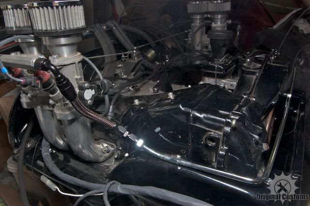

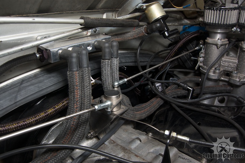

ConeDodger   Here is another Original Customs application. This...   Apr 7 2011, 08:31 PM

ConeDodger   Now that is a very accurate linkage set up. Mark h...   Apr 7 2011, 09:14 PM

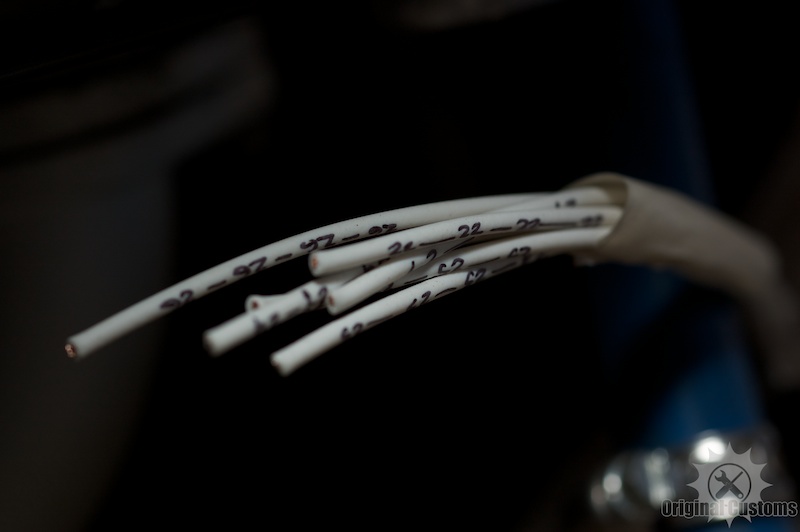

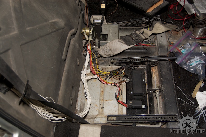

McMark   Got the wiring diagram drawn up yesterday. There ...   Apr 28 2011, 10:27 AM
ConeDodger   Sorry Mark. Think of yourself as a pioneer. :) Fo...   Apr 28 2011, 11:02 AM
McMark   True. I usually remember to include that caveat. ...   Apr 28 2011, 11:33 AM

ConeDodger   Hard to believe this pile of wire is close to beco...   May 30 2011, 05:59 PM

McMark   Harness mockup goodness.... :drooley:   May 30 2011, 07:39 PM
ConeDodger   OMG! Looks like McMark hired munchkin wire wri...   Jun 3 2011, 09:09 PM
r_towle   they DO make wires with different colors.... R   Jun 3 2011, 09:30 PM
ConeDodger   they DO make wires with different colors.... R ...   Jun 3 2011, 10:12 PM
ConeDodger   What was once a pile of wires is now a fuel inject...   Jul 27 2011, 09:14 AM
