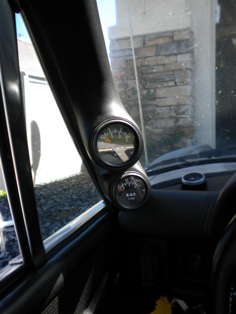

I think that is Mark's LM2 A:F meter. Either that or he is making sure the Tangerine Header is 12 Volt (IMG:style_emoticons/default/blink.gif)
Actually Sean, Mark is checking the temperature of the header and the temperature of the air being exhausted from the fan housing. He has some product under development and needs to know if his material choice will have a problem with temperature.

Did you see those nice EGT gauges, the aircraft ones. I found a thermocouple company that has the right ones for exhaust bungs. Of course the gauges are not cheap, but they are SAFE. Maybe good insurance given that your going to be tuning on the road?

I am using both an EGT and CHT aircraft gauge. I also have the A:F ratio gauge going in the clock hole in my Appearance Group center console. I would really like it to be the third gauge in an A pillar pod but thus far Morph hasn't taken my not-so-subtle hints. (IMG:style_emoticons/default/smile.gif)
