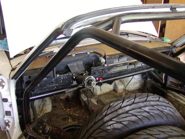

wow, finally something being assembled on/in the car (IMG:style_emoticons/default/smile.gif)
dash frame...i wanted to do a custom dash similar to the 356 cars, I just don't have the time (or skill??) to do it right now, so back to the factory dash

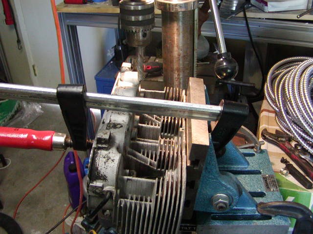

with my mill broken (both of them, now I've got a few grand worth of large paperweights taking up space and soon money (IMG:style_emoticons/default/sad.gif) )
i had to drill out the broken head stud on my drill press, not the most accurate, but better than nothing...
Hey Jake, if you see this, do you the correct angle that the exhaust studs are relitive to the bottom of the head??
I put 'em at 5° which looks pretty good.

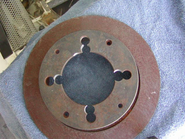

welcome to my engineering nightmare....i should have listened to Brad the first time...now i know why this is one of the most least popular conversions: going from 4x130 bolt pattern to 4x100 bolt pattern
it's a PITA, plain and simple
I'm about thiiiiiiiissssss close to throwing my rims and tires on eBay and going back to the standard bolt pattern...
so here is my rear rotor that i drilled yesterday, the center bore diameter is too big which causes the new holes to break thru. I don't like that at all...it's probebly okay for mild street use (and it is the rear brakes which don't see as much forces), but I plan on beating on the car (with love of course) so I cannot put these to use with a clear conscious
nebreitling

my 2cents: cut your losses and toss the 4x100 setup! safety first!

QUOTE(nebreitling @ May 9 2004, 12:18 PM)
You guys worry too much. The tapered bolts are the point of force on the rotors not the studs, If you shear a tapered bolt the rotors will clunk. and your lugs will loosen before anything else happens.

QUOTE(Mueller @ May 9 2004, 12:46 PM)
i wouldn't run 'em ...
better ways to kill yourself! (IMG:style_emoticons/default/wink.gif)
