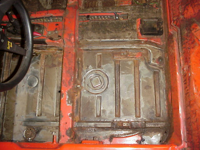

Gint   You know, while I was out poking at rust and takin...   Apr 15 2003, 08:35 PM

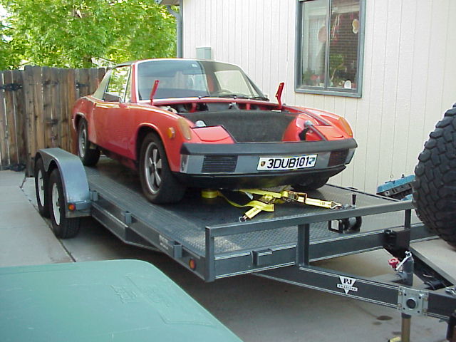

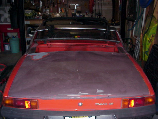

Gint   Let's start with a nice "before the moron" pic   Apr 15 2003, 08:50 PM
Gint   Post moron   Apr 15 2003, 08:51 PM
Gint   Another view (look at that sticker on the spare)   Apr 15 2003, 08:53 PM

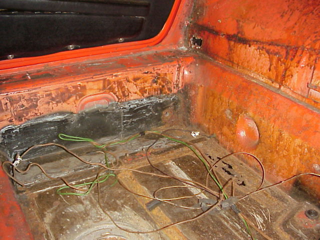

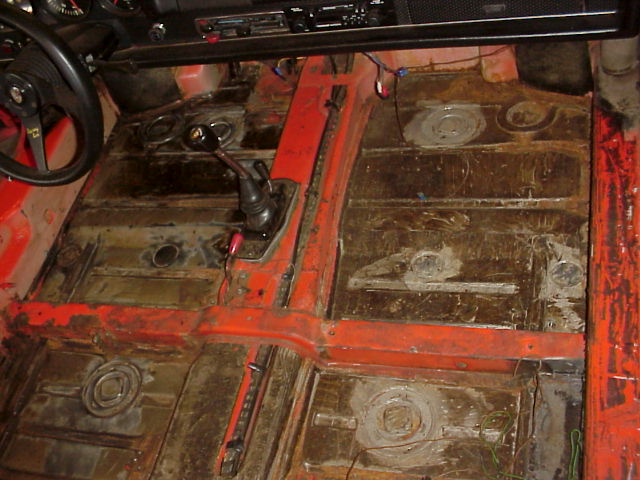

Gint   This was after I removed the backpad and mat.   Apr 15 2003, 08:55 PM
seanery   I HAD NOTHING TO DO WITH THIS! :o Mike, Wha...   Apr 15 2003, 09:06 PM

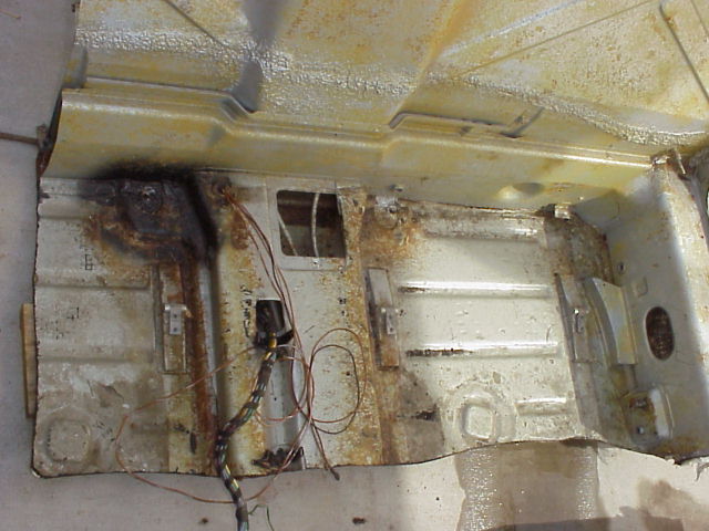

Gint   A little surface rust in this channel. Not entire...   Apr 15 2003, 09:07 PM
Gint   Again, I'm not really sure what it's for.   Apr 15 2003, 09:09 PM
Gint   The seats and backpad. These will be stored for f...   Apr 15 2003, 09:10 PM

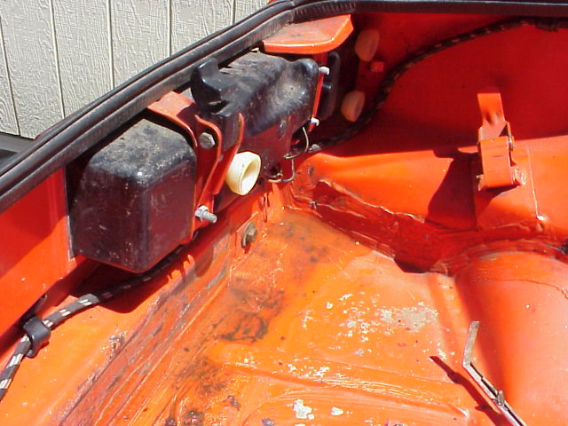

Gint   Another spot of knarly surface rust on the firewal...   Apr 15 2003, 09:12 PM
Gint   See that crack on thje floor pan and the hole in t...   Apr 15 2003, 09:13 PM
Gint   That's concrete you can see through the hole.   Apr 15 2003, 09:15 PM
Gint   I almost forgot to show this pic. The worst of it...   Apr 15 2003, 09:17 PM

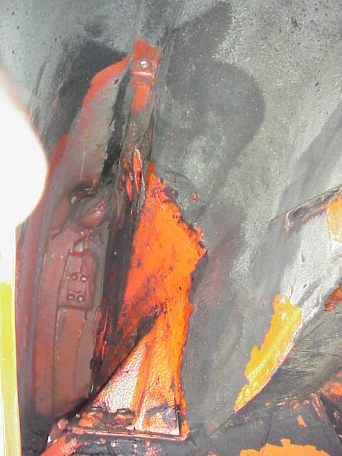

Gint   Passenger side rear corner. There is actually a h...   Apr 15 2003, 09:19 PM
Gint   Aha! Now we can see some previous shoddy repa...   Apr 15 2003, 09:21 PM
Gint   Another daylight sighting from interior panels. T...   Apr 15 2003, 09:23 PM
Gint   Although the rust stops at the cross brace on the ...   Apr 15 2003, 09:24 PM

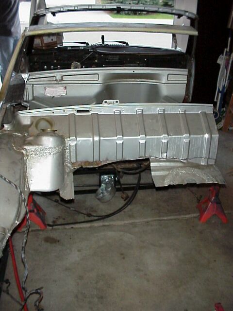

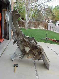

Gint   Post engine/trans removal. That's the donor-m...   Apr 15 2003, 09:32 PM
Gint   This could be a problem. Right side upper bolt ho...   Apr 15 2003, 09:34 PM
Gint   Another view. Last pic for today. More tomorrow.   Apr 15 2003, 09:35 PM

Gint   Tank area passenger There is some VERY minor surf...   Apr 16 2003, 06:05 PM
Gint   Tank area Driver's side   Apr 16 2003, 06:06 PM

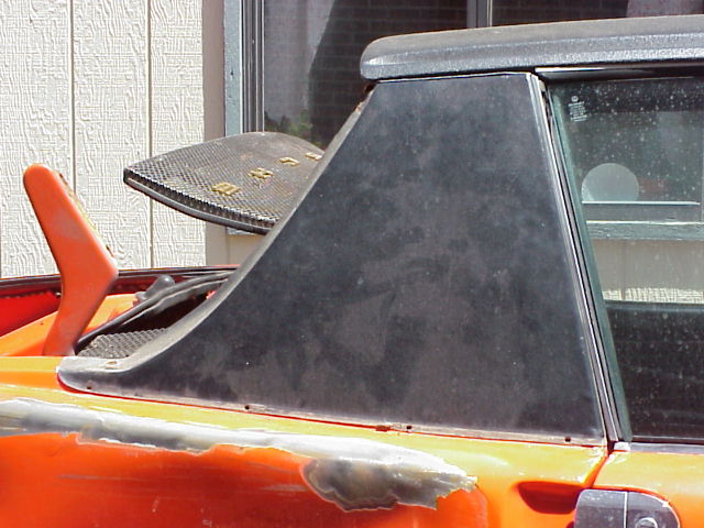

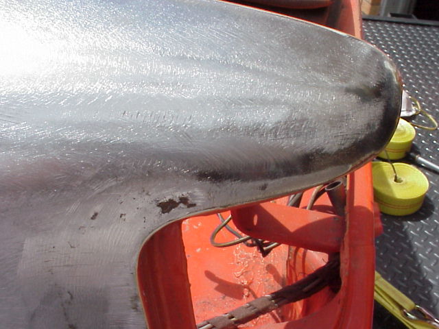

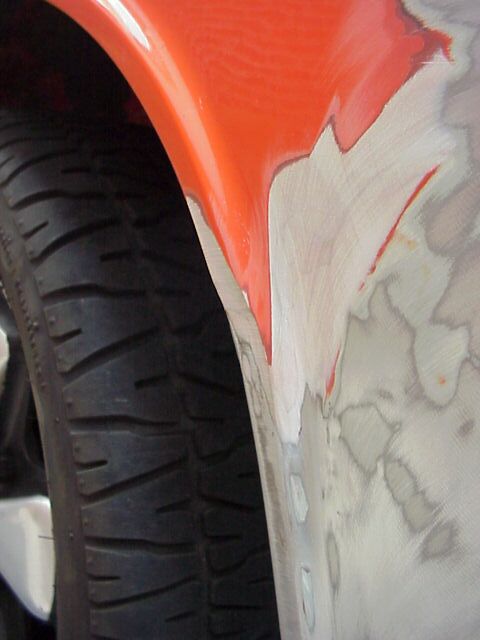

jonwatts   So, Mike, what are we seeing here with the paint? ...   Apr 17 2003, 01:46 PM
Gint   It's just wierd light. The car did receive a ...   Apr 17 2003, 02:13 PM

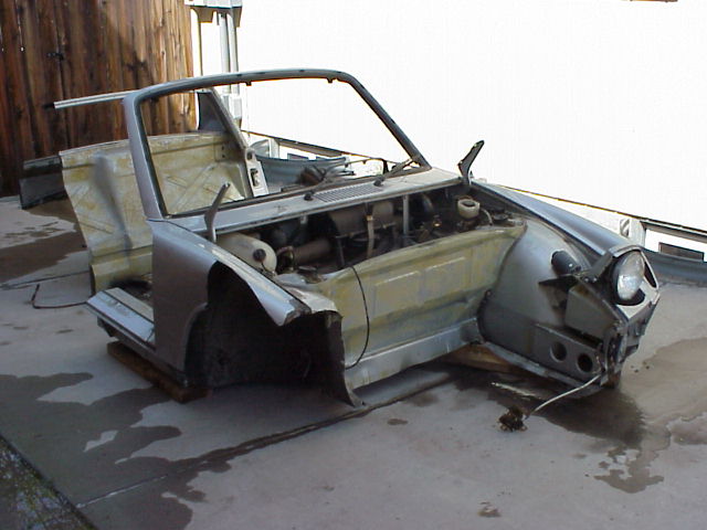

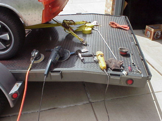

Gint   Damn I love tools. The right tool makes all the d...   Apr 18 2003, 08:49 PM
Gint   Took the crap right off.   Apr 18 2003, 08:50 PM
Gint   This is the plug on the driver's side front fl...   Apr 18 2003, 08:51 PM
Gint   Near the left rear donut.   Apr 18 2003, 08:52 PM

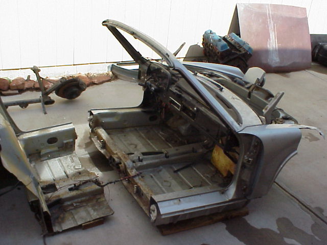

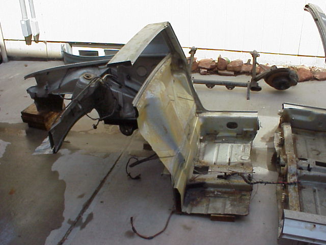

Gint   This is the unmolested donor car.   Apr 18 2003, 08:53 PM

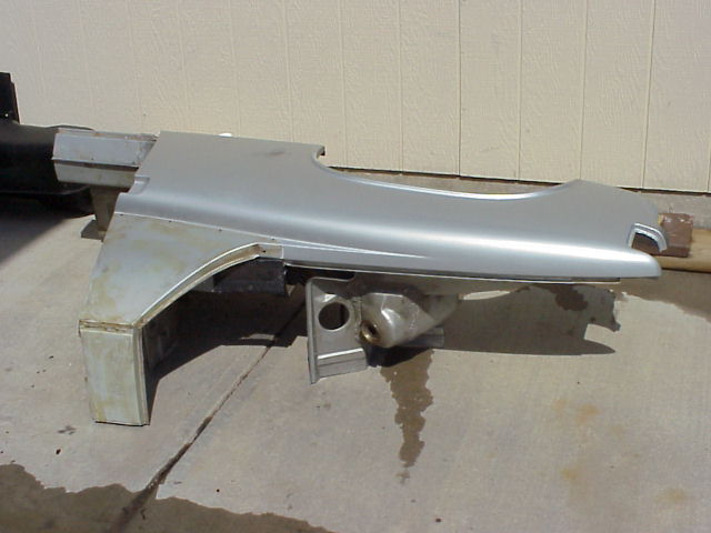

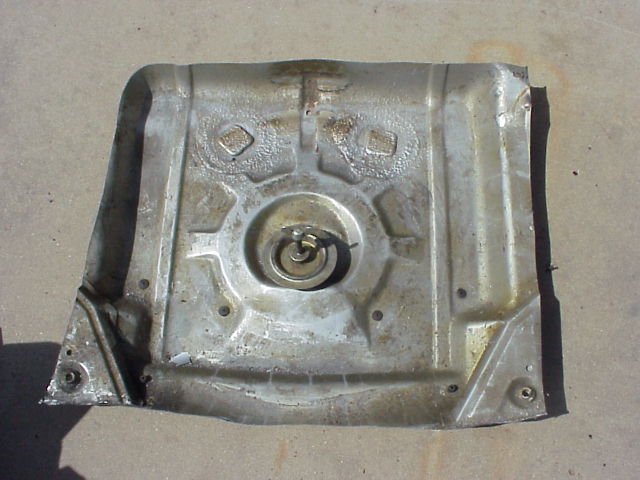

Gint   Right side floorpan exploratory today. This is ug...   Apr 19 2003, 06:11 PM
Gint   More...   Apr 19 2003, 06:12 PM
Gint   The pan isn't all bad though. Here's the ...   Apr 19 2003, 06:13 PM

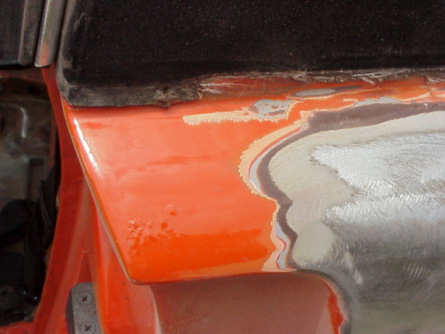

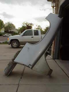

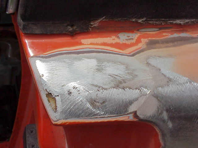

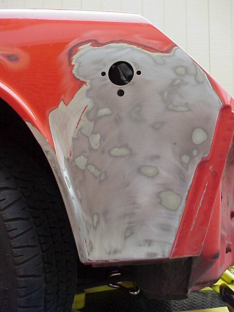

Gint   The damaged right rear quarter had some bondo in i...   Apr 19 2003, 06:14 PM

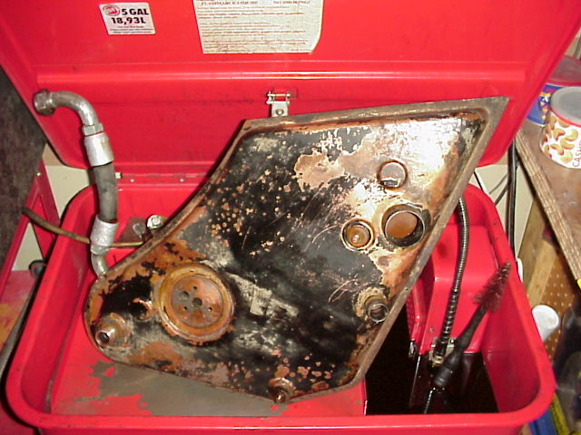

Gint   Got the engine on the stand today. 2 liters (2.2?...   Apr 19 2003, 10:49 PM
Gint   The $60 ebay engine stand bracket set I bough...   Apr 19 2003, 10:51 PM

Gint   This is the after pic. It's also a fine examp...   Apr 26 2003, 07:43 PM
Gint   OK, so I had a beer during the course of the work....   Apr 26 2003, 07:45 PM
