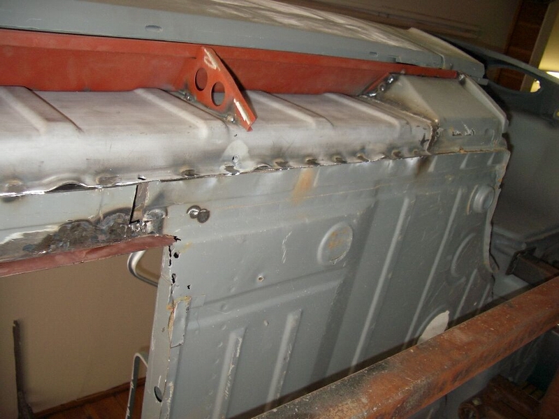

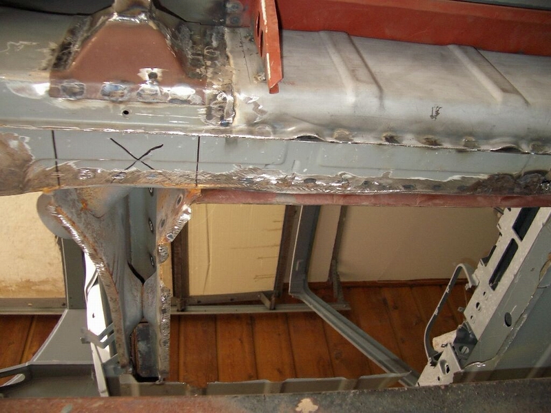

Sorry Levi! Been awhile, I know. Almost ready for paint.

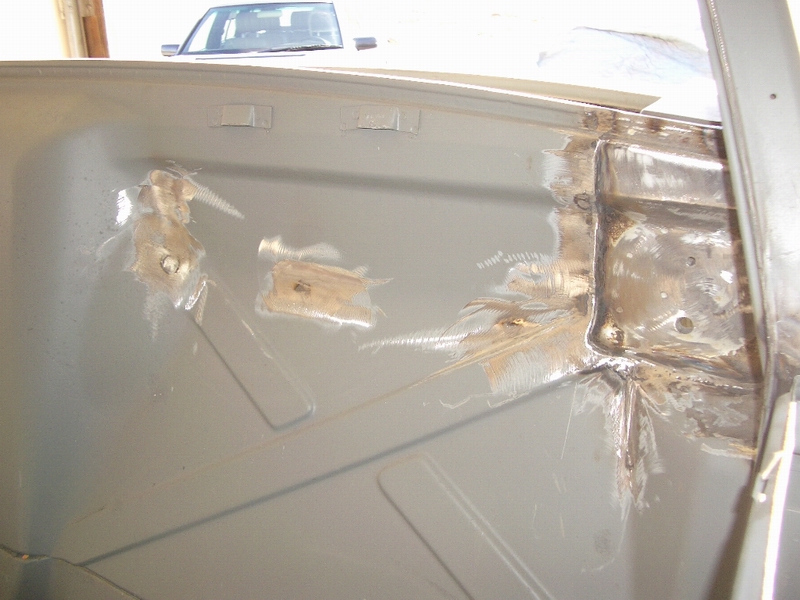

(IMG:http://www.914world.com/members/ginter/IMGP1176.JPG)
New rockers and sills.

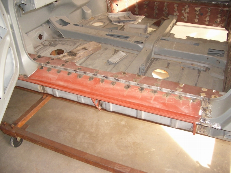

(IMG:http://www.914world.com/members/ginter/IMGP1178.JPG)
Engman's long stiffening kit installed.

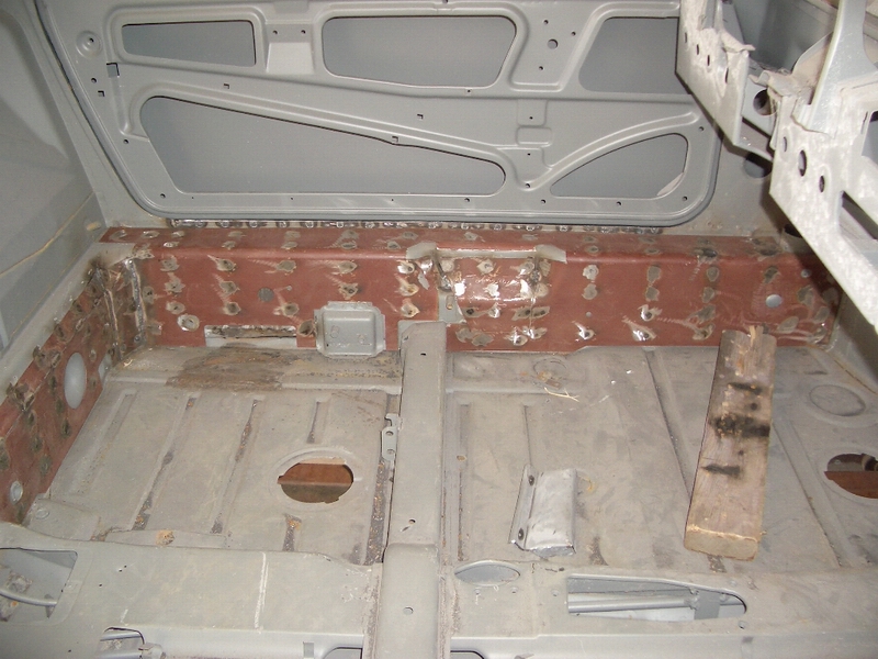

(IMG:http://www.914world.com/members/ginter/IMGP1179.JPG)
(IMG:http://www.914world.com/members/ginter/IMGP1180.JPG)
(IMG:http://www.914world.com/members/ginter/IMGP1184.JPG)
(IMG:http://www.914world.com/members/ginter/IMGP1185.JPG)
(IMG:http://www.914world.com/members/ginter/IMGP1188.JPG)

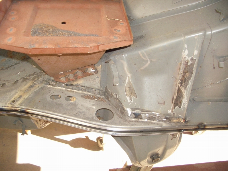

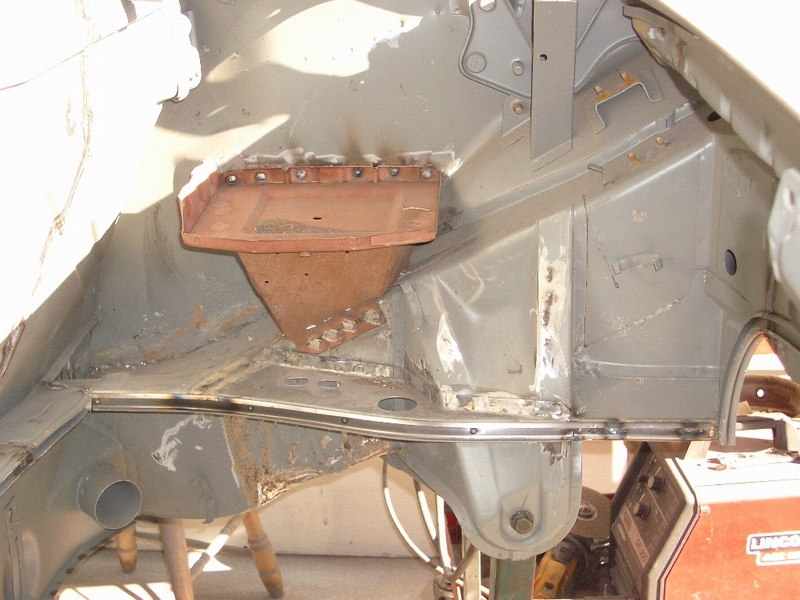

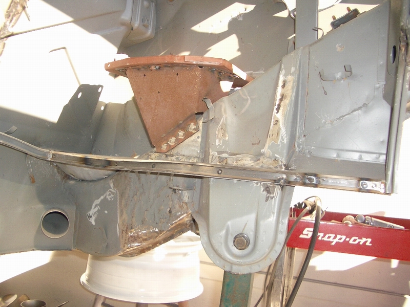

New battery tray, shelf and engine shelf.
(IMG:http://www.914world.com/members/ginter/IMGP1196.JPG)
(IMG:http://www.914world.com/members/ginter/IMGP1198.JPG)
(IMG:http://www.914world.com/members/ginter/IMGP1201.JPG)

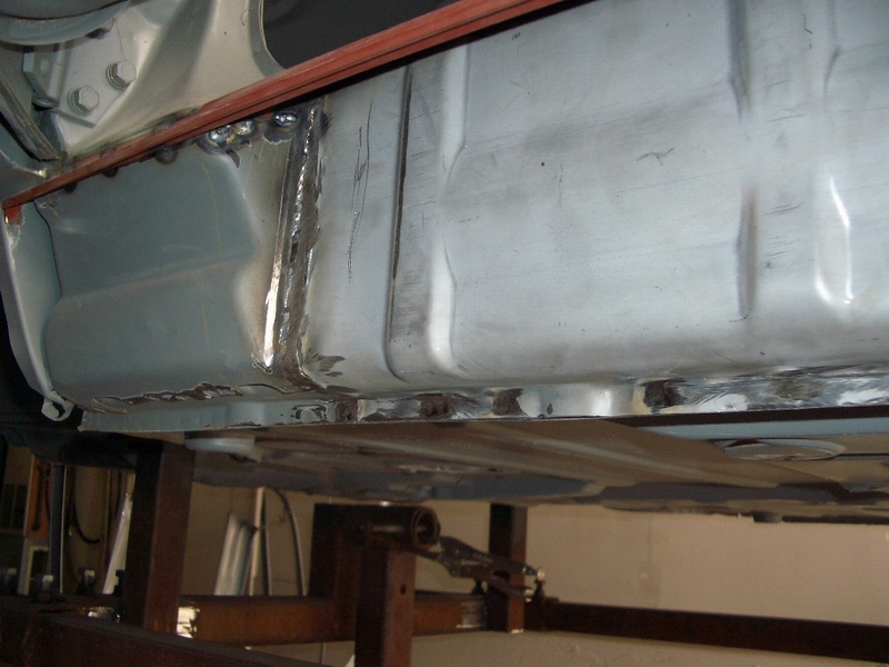

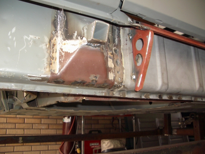

Partial jack post support replacement
(IMG:http://www.914world.com/members/ginter/IMGP1187.JPG)
Still need some pan work.
(IMG:http://www.914world.com/members/ginter/IMGP1186.JPG)
(IMG:http://www.914world.com/members/ginter/IMGP1189.JPG)
(IMG:http://www.914world.com/members/ginter/IMGP1190.JPG)

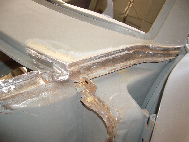

Getting a new front fender. The original was pretty warped.
(IMG:http://www.914world.com/members/ginter/IMGP1192.JPG)
(IMG:http://www.914world.com/members/ginter/IMGP1193.JPG)

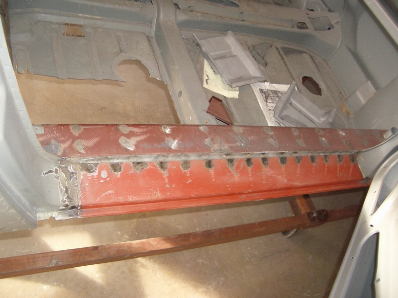

Added pockets and mounts for late model retractable belts
(IMG:http://www.914world.com/members/ginter/IMGP1200.JPG)
(IMG:http://www.914world.com/members/ginter/IMGP1203.JPG)

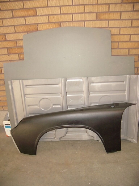

gint
Fender is on... looks great. I tried to take pics with a "real" camera but mine kept giving me a system error. I think it's just a low battery issue. Floor is out and the new one is going in today. Everything looks really clean.
I helped Troy upload that zip file so, the pics are from the same bad camera (just not great in low light) but they're 800 by 640 or something like that.
I'll try to get some shots nmaybe later today once the floor is in.
