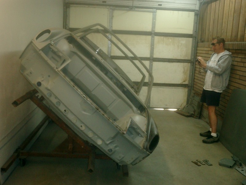

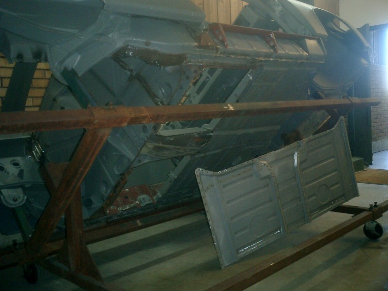

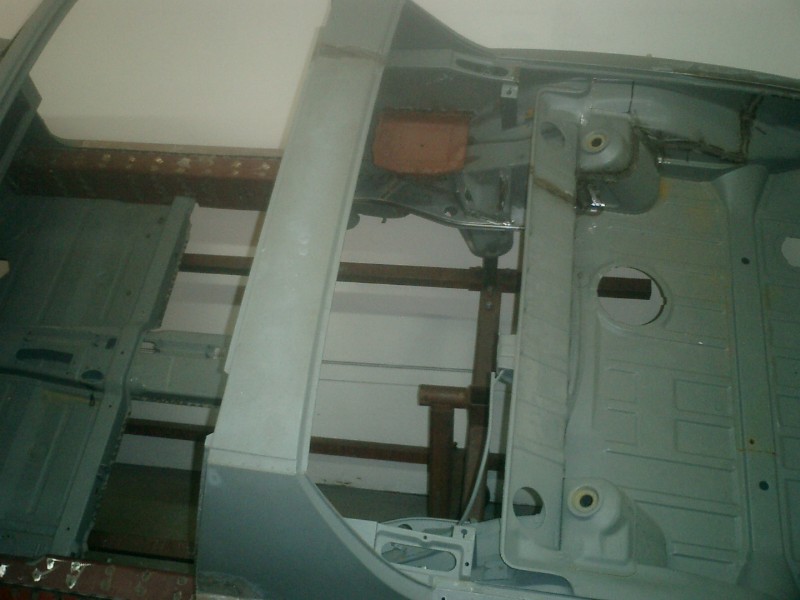

Today's pics. The replacement fender is installed.
Gint

Member No.: 20
reta
Gint
post Nov 10 2004, 06:15 PM
Post #365
Mike Ginter
Posts: 16,105
Joined: 26-December 02
From: Denver CO.
Member No.: 20
reta

Who's that handsome mother fucher in that first pic... the one trying to get his camera to work?
(IMG:style_emoticons/default/w00t.gif)
