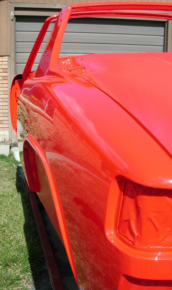

QUOTE (Lou W Posted: Mar 18 2005 @ 11:13 PM)
It looks great. What color red is that? :smilie_pokal:
That aint red! (IMG:http://www.914world.com/bbs2/html/emoticons/rolleyes.gif)
It's Tangerine. Or a really reasonable facsimile.

QUOTE (CptTripps Posted on Mar 19 2005 @ 05:36 AM)
You are my hero...
I'll get the last patch of old paint off today, and start at filling and :: hope :: by next weekend, I should be ready for my first stab at primer...
Looks fantastic...keep it up man.
I'm just paying the bills for the metal and paint work. You're actually doing yours yourself. Your the hero man...
Here's another pic for ya. This one looks more like what the color really looks like. Reds and oranges are so hard to get decent color pictures of.
I'll guarantee ya'll... that's as Tangerine as it gets. I followed the color match process. Troy is neurotic about that kinda stuff. (IMG:http://www.914world.com/bbs2/html/emoticons/wacko.gif)
My original "Canary Yellow" was found under the headlight cover. It took nearly a week to get it just right. Jim Chambers can weigh in on that being Canary Yellow...
Gint's paint "really" went on well (only 3-4 big runs). (IMG:http://www.914world.com/bbs2/html/emoticons/w00t.gif)
Seriously, Troy was really pleased with the way it laid out. I'll bet he's blocked it out by now. I'll try to stop by with the the Nikon today. This tub will be stunning.

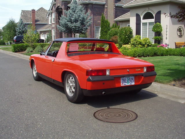

I think the camera lied somewhat in pics of the canary yellow six and Gint's tangerine. I agree that the recent tangerine pics don't look quite right. My yellow didn't look right in some of the pics either. It looks different and dead-on correct up close and personal. Eric and Troy do good work.
edit: just looked back, the posts on the 18th look a little too pink. The post on the 19th looks real tangerine to me.

You can't take pictures with two different cameras ('specially digi-cams) of an orange or red car and have them look the same. The same goes for viewing orange or red cars on two different computer monitors/video cards. That's just the way it is.
Talked to Troy today. The tub is basically for all intents and purposes - done. We have tentative plans for me to pick it up the weekend of 4/9-10. You gonna be around that weekend Eric?
