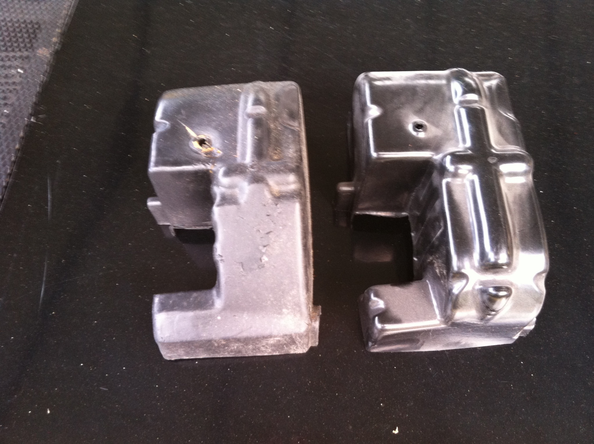

Has -70 914/4 and /6 same relay board cover?

Nope, they're different. I don't have a picture handy, though.

The catalog in PDF calls for one of those for all 914s, but I thought it only fit the 914-4 models? It may be that the -4 version supersedes the -6 version even if it isn't quite right.
I do know the relay board is different. I could be wrong about the cover, though.
--DD

The early covers have a hole for a hold down screw later do not

-4 and -6 covers are the same until Jan 72 when the reel type seat belts were installed. Jan 72 on the covers were slanted in the front to miss the seat belts anchor bracket on the rear wall. Dave is correct that the relay board are completely different.

(IMG:style_emoticons/default/agree.gif) evidently I was wrong after the slope style Porsche did away with the stud,

It will fit even if not tech. correct= superceded

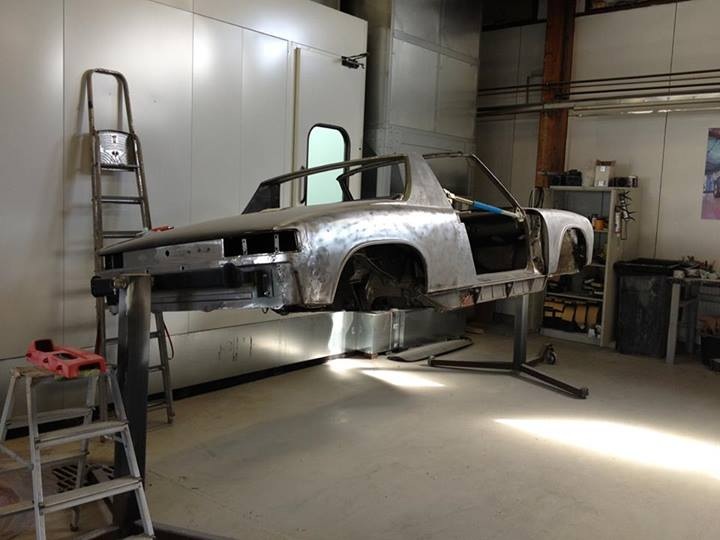

First picture in paint shop. Now I really need to decide the colour! Signal Orange, Tangerine or Metallic Silver... this is hard!
