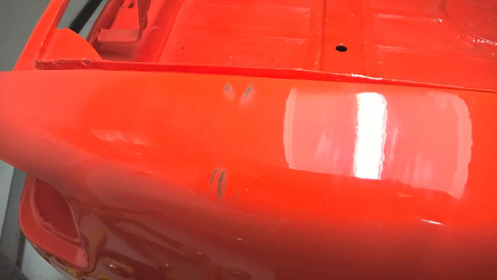

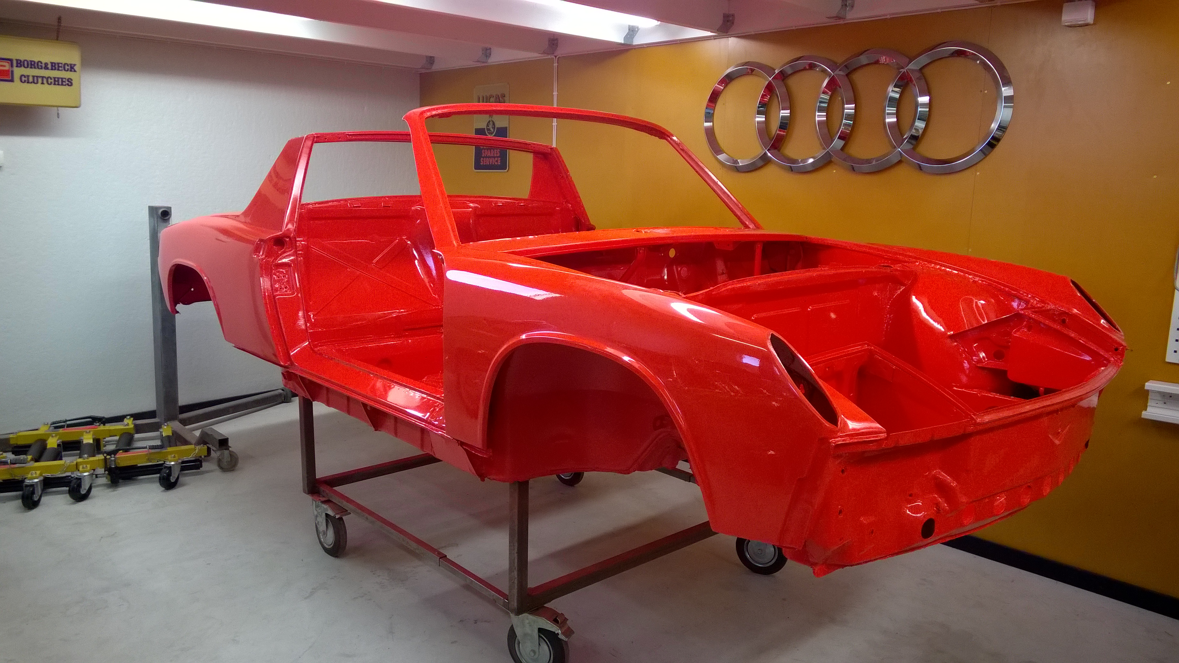

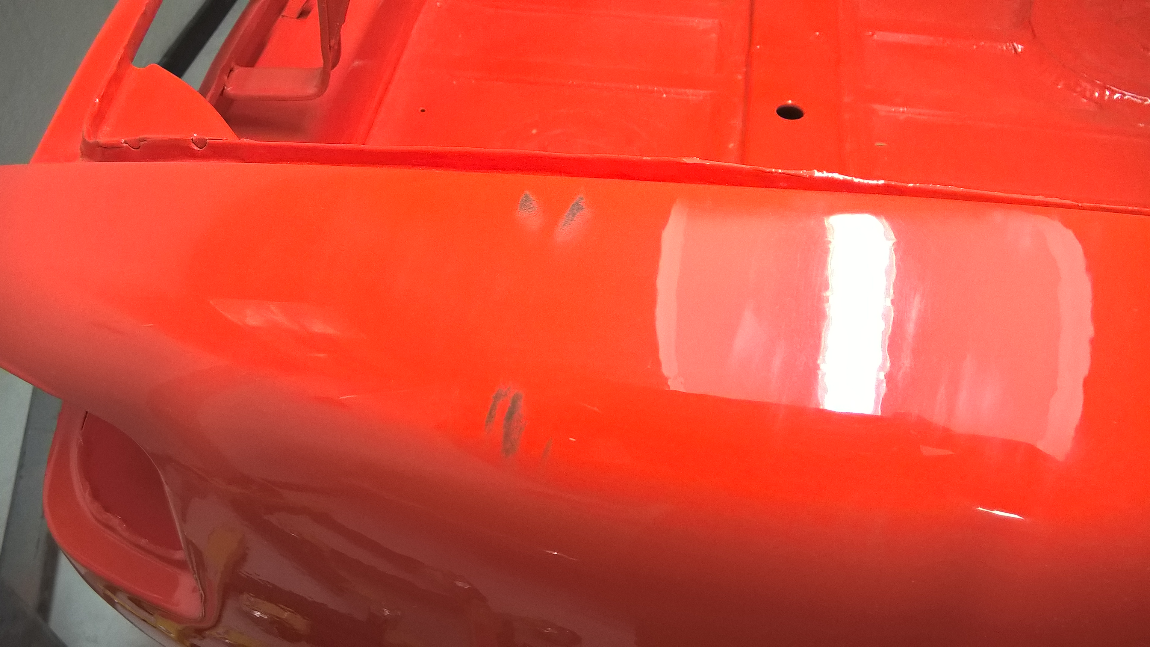

Tadaa again. Repainted shell arrives week ago (IMG:style_emoticons/default/smile.gif)
But....some transporting damages to paint work. This is not real!!! Transporter was an idiot.
As you see:
Several points around body shell.
OmaPossu
post Dec 7 2015, 06:28 AM
Post #152
Posts: 241
Joined: 4-October 09
From: Finland
Member No.: 10,886
Othervice I love the color (IMG:style_emoticons/default/wub.gif)
Paint surface polishing and then, at last, assembly starts! Where are all my parts...

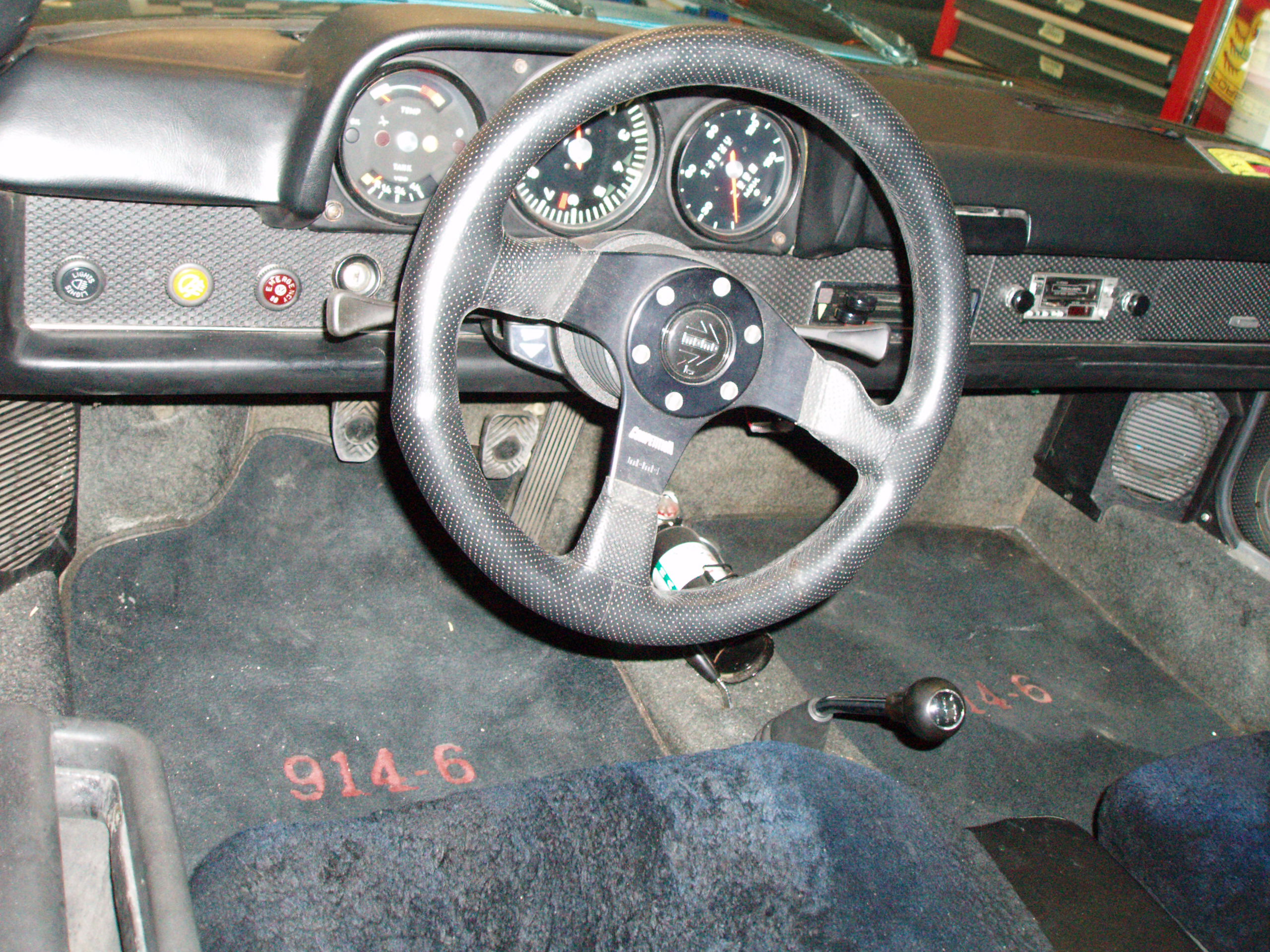

Question: from where I find pics of original sound proof carpets (whats the right term?). And where to purchase original or close to original material?

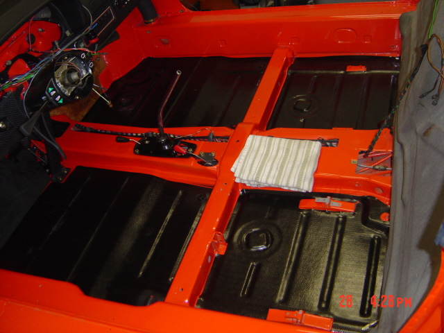

Here are the original photos of your interior. This is the original. If you want "original" sound proofing you would want to replace with the tar floor stuff. Here in the US you can get something similar in the roofing section at our local hardware store. I didn't want anything that would retain moisture so I went with Dynamat on the floors and back firewall and then put the original back pad and sound pad back in.

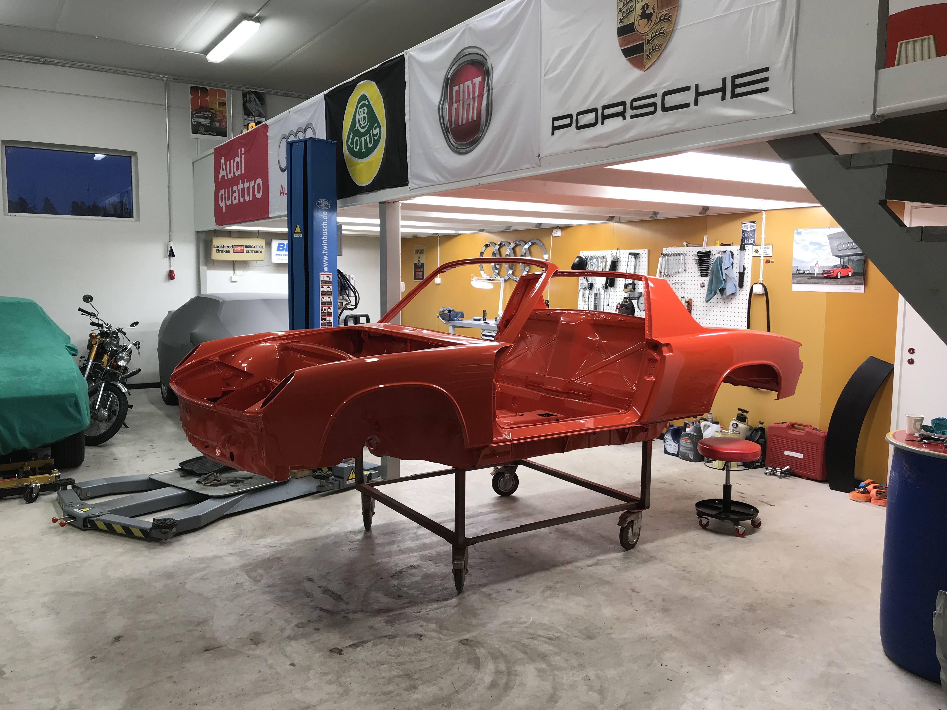

Hello again,
I drag my Porsche body to open floor an started to look what shall I do next. To put floor tar back or not? It’s a car with gf roof so quiet it will never be, what ifI don’t put any sound proofing at all? How noisy it can be? Have anyone tried?
jukka
post Dec 10 2017, 07:28 AM
Post #159
914-6 GT in waiting
Posts: 20,290
Joined: 19-September 09
Member No.: 10,825
The chassis looks great. The car will be louder without soundproofing but you could always add it later if you can’t bare to cover up the fresh paint just yet.
You don’t have to cover up all the paint. Just the large, flat sections that can vibrate. It can be made to look nice and neat.
