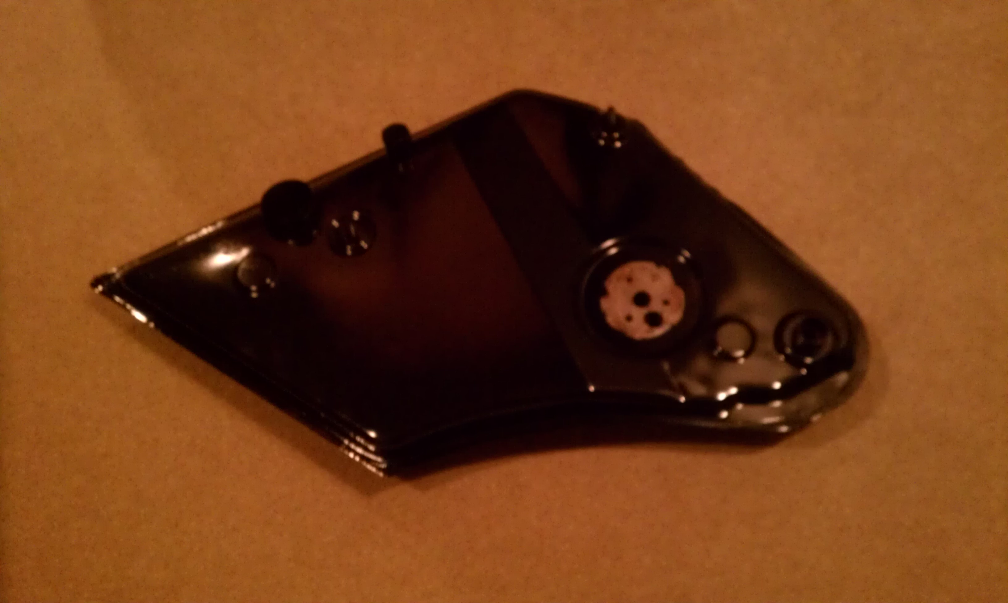

I had my oil tank specialty coated with a covering (gloss black) that helps PULL heat out or a distrubtion heat coating. It looked very good and in concept it can't hurt to help pull some degrees out from the oil.
I think the color came out nicely and I'm all for using new technology on these cars that was not around in 1970.
Here is a look (crappy cell pic):
Used these people: http://www.performancecoatings.com/index2.html
Good Luck!

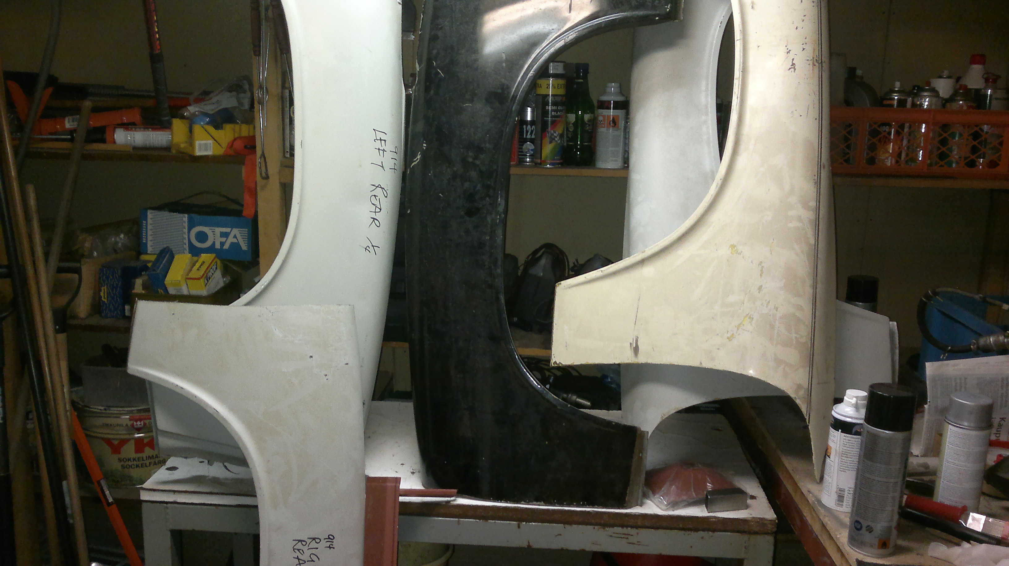

Enough fenders?
