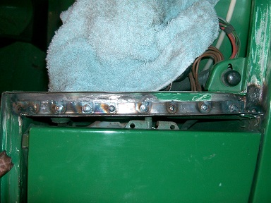

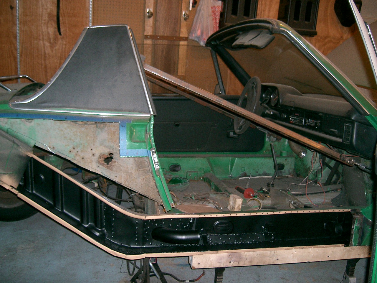

Finally got my new inner long welded in with doubler plates on all seams. Verified the incline of the new long with an incline gauge (with the car level) following Jeff Hails build thread. Door operates well! Entire inner long has been coated with rust encapsulator.
Still have a long way to go but I am hoping that this was the toughest part.

Some pics during the inner long repair:

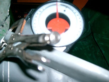

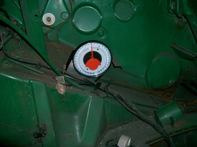

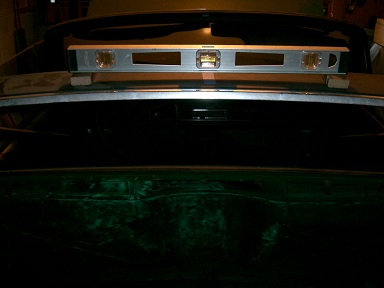

Leveling the car:
Checking incline factory side:

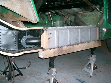

Incline - new long:
Jack in place to tweak angle of new long:

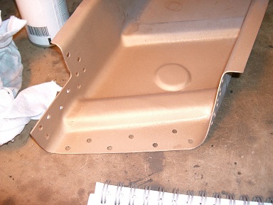

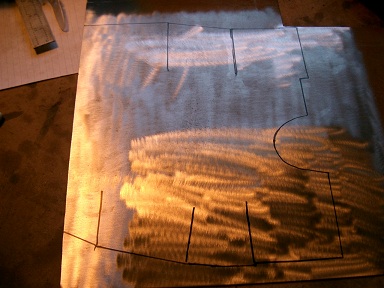

Inner plate pattern:
Plate layout:

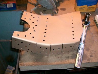

Finished reinforceing plate:

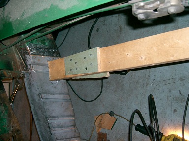

Needed some side pressure on the inside of the new long in the rear so it would fit flush, had to improvise with a wedged in 2 X 4:

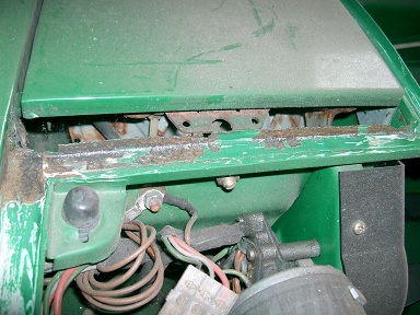

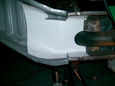

New channel formed and welded into front trunk channel....
Before:
After:

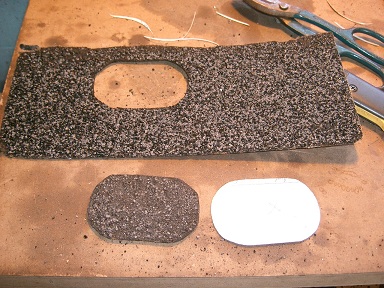

A shingle tab blew off the neighbors house, they werent looking for it, and I needed a new tar plug for the inner long, as I melted my old one while welding. Scraped most of the stones off of it...not show quality, but will work fine for me. (IMG:style_emoticons/default/biggrin.gif)

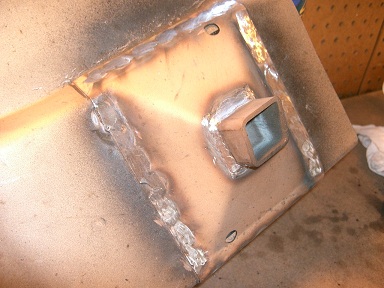

Jack post support welded on with advice from the world in another thread:

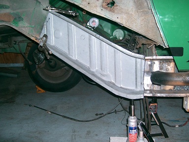

More weekend progress...outer clam shell welded on after coating inside with weld thru primer/rust encapsulator & seam sealing the heater tube. I still had part of the original clamshell in the front, so I was able to index proper fore/aft placement by taking measurements from the cheese head screws in the bottom of the still intact drivers side clam shell. A long straight edge along the bottom kept it true horizontally.
