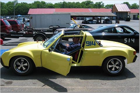

Brant,
My car is full track now, but i do not want to go coil over on the front just yet. Boge Struts and adjustables are swell for now! (IMG:style_emoticons/default/biggrin.gif)
My main concern is that the yellow sport valving in the rear and red konis up front will be a significant mismatch. Headed to Watkins Glen July 4th and dont want so much room underneath....

1973914
post May 28 2004, 03:30 PM
Posts: 353
Joined: 16-May 03
From: Washington, DC
Member No.: 703
First of all, nice avatar Brant (IMG:style_emoticons/default/cool.gif) i get a chuckle every time i see it.
Yeah the front is "ok" right now, and i do need to look into something better than spacing the rack (like a bump steer kit for example). Definitely looking like a 914 Cayenne at the moment compared to some of my fellow 914 track junkies, and with the rear lighter (fiberglass everything and the trunk cut out to boot) my CG is pretty bad. Im hoping that i can at least "get away" with the front reds and rear yellows with threaded perches for the DE in WG...
brant
post May 28 2004, 03:57 PM
Posts: 12,016
From: Colorado
Member No.: 47
I would definitely... definitely think you can get a way with it...
worst case senario, the car is a fraction less balanced, but this is pretty fine tuning and many other factors make a greater difference.....
thats a nice looking car.
