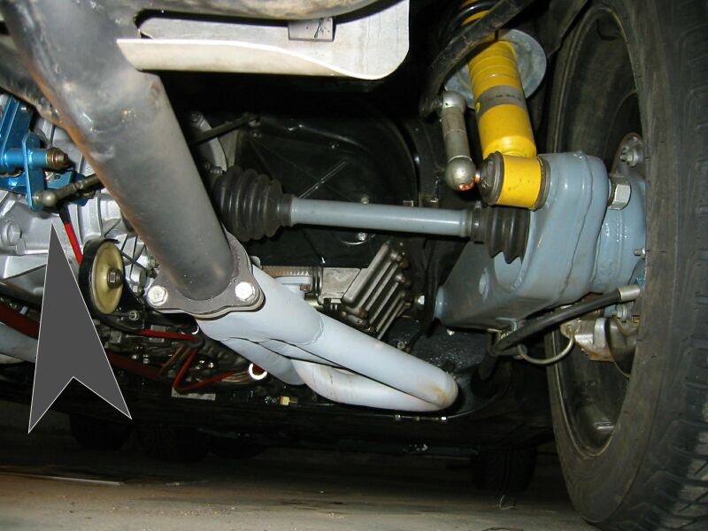

Steve, here is one photo of finished install with cables. Works great. No problems. Have worked already couple of years.
You need custom cables. Measure the lengths of the cables you will need, go to your local cable shop and let them make you new pair of cables. You can not use 911 or 914 cables. They are too short and the endings are wrong.When you put everything together you will see what kind of endings you will need. If you want more information about my e-brakes, just send me pm.

Timo, what is this on your gearbox? The bellcrank for the throttle?
Can you use the 914 cable outerguides or were these made too -prob too short?
Don't spose you remember the lengths you had made?
You are right. It is home made bellcrank for the throttle.
No, I think the 914-4 throttle cable was too short. I used some cable kit originally sold for VW Beetles with one 2-barrel carburator.
I am sorry I dont remember the lengths, but what would you like to know ?? If you can give me about one week I can measure the length of the outerguide and cable for you. Now I remember only that the diameter of the cable was 2mm.
