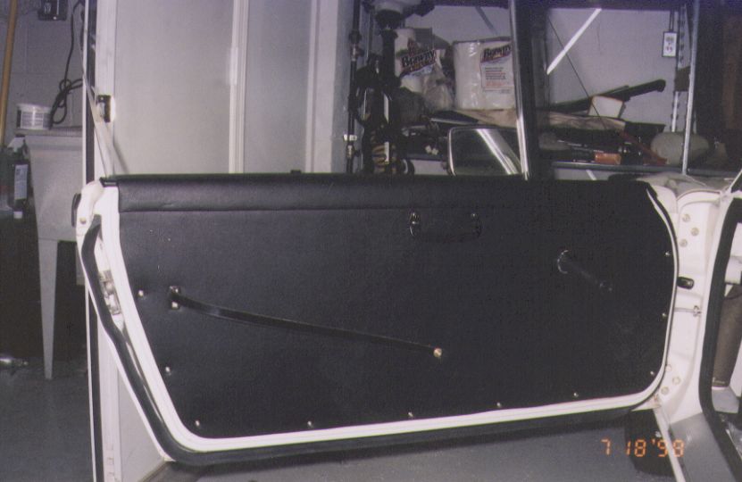

I have a very similar style, except the strap doesn't work the latch. The door bin had to be removed due to my roll cage and the resulting holes in the panel were ugly. so I reskinned the panel with the basket weave and attached the pull strap to the original bin holes. My lock and latch remained the same.

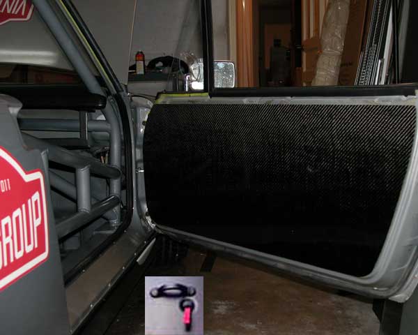

I fabricated these carbon fiber panels and bought a set of these late style RS door pulls but I never installed them.
Really don't need them on the race car.

where did you get the CF for the panels? THAT is a cool idea/look!

I bought a roll of CF 5oz twill and laid up the panel on a sheet of glass.
then just cut to fit.
got some air bubbles but looks good from afar.
want to do some more projects in the future with molding CF.

how did you cure it?

use epoxy resin, just like laying fiberglass, which i had done before.
for simple parts like this you don;t need to vaccum bag or dare i say autoclave.
you only need that equipment for structural parts or parts that really need to be perfect and void free.
for $50 you can buy a roll of CF on sale and some resin and have some fun. hard part about CF is that most people want to leave it clear so you really have to get the lay up perfect. you can;t bondo and fill if your not going to paint the part.

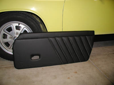

I bought these from Original Fit.
