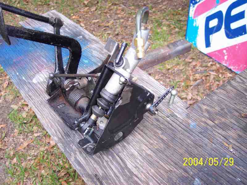

I've Been working my project for quite some time now,and this summer the 3.6l & 915 trans are finally just about ready for the install.
I have always wanted to have a hydraulic clutch setup when I get it together,so When I was up at the Hershey swap meet,I came across a 964 pedal cluster with a integrated hyd.clutch that when I looked at it I thought that I might could just make it work.
It was actually easier than expected.
Ron

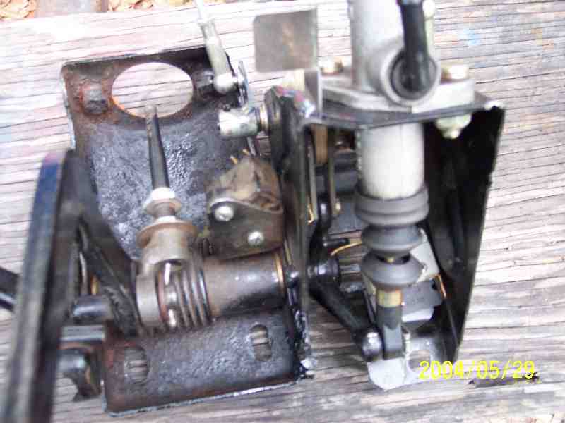

The entire master cylinder is mounted in a added on frame to the 964 pedal cluster.
Drill out a few spot welds,and it pops right off.
It is even shaped to weld on the end of the 914 pedal cluster bracket.

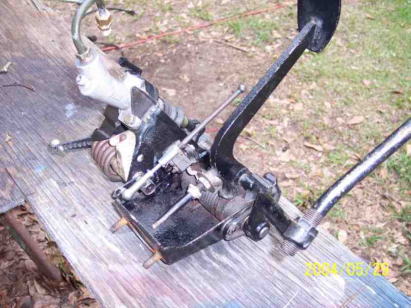

The only real work done after that was to cut down the length of the large sleeve that holds the brake pedal by about 3/8",and make a new clutch rod.
the clutch rod is 14mm in dia.I bought a pc. of 14mm drill rod from McMaster-Carr for about $8.00.
Ron

I had to re-locate the accelerator linkage,so I used the pivot hole on the added on clutch since it was hollow to begin with.

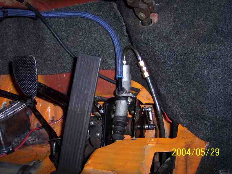

9140430841, FINALLY RUNNING
Posts: 1,216
Joined: 22-May 03
From: WALTERBORO,S.C.
Member No.: 724

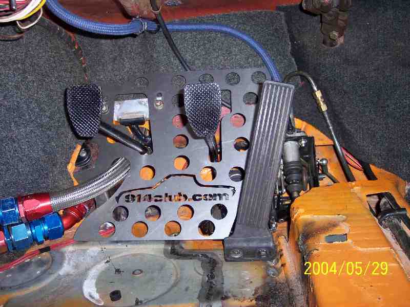

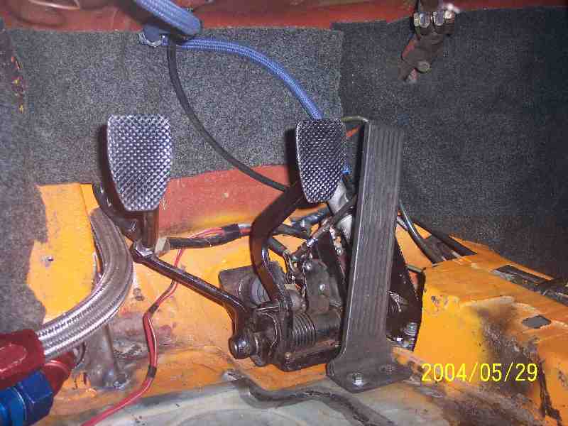

The install in the car was a snap,it has about a 1/2"clearance from the firewall.I did a notch in the trans tunnel,and added 1 stud for the extra mount hole.
It is a 5 minute job to install or remove the entire unit once the brake master cyl. nuts are removed.
I used 5/16"brake line out the back for the line.

Nother interior shot.

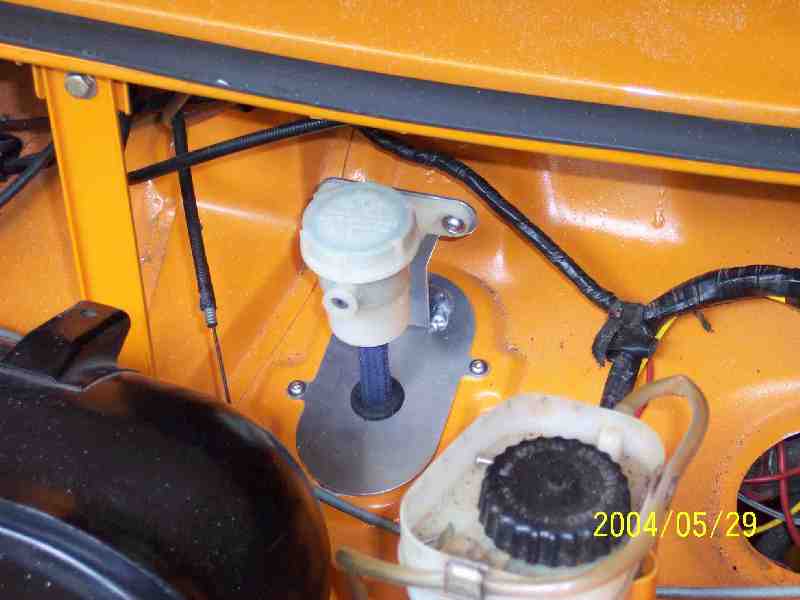

The reservoir is a Ford Ranger unit I took from a junkyard.It was free.
RON S.

the pedal board I saved for last.The original no longer can be used.So I've programmed my own version with a little twist.
Right now,It's cut from 20ga. steel to check for fit,but when I finalize the design I'm gonna buy 16ga.grade 2 Titanium.
Ron
