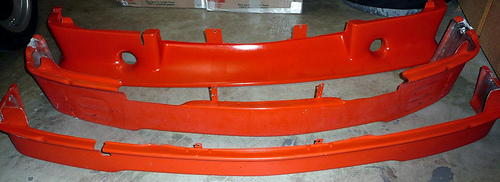

FWIW I made my front spoiler/dam removable for trailering, which is easy to do. I have 3 different ones. The smallest is an LE-type and the largest is a Sheridan.
(IMG:http://www.914world.com/bbs2/uploads_offsite/farm4.static.flickr.com-21-1306213484.1.jpg)
914 Front spoilers by cjcam, on Flickr

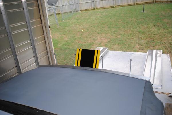

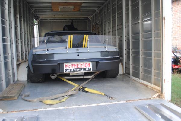

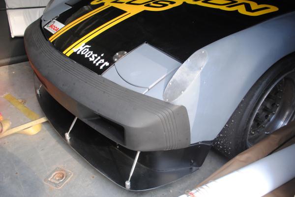

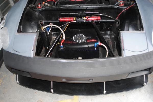

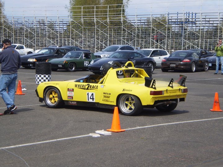

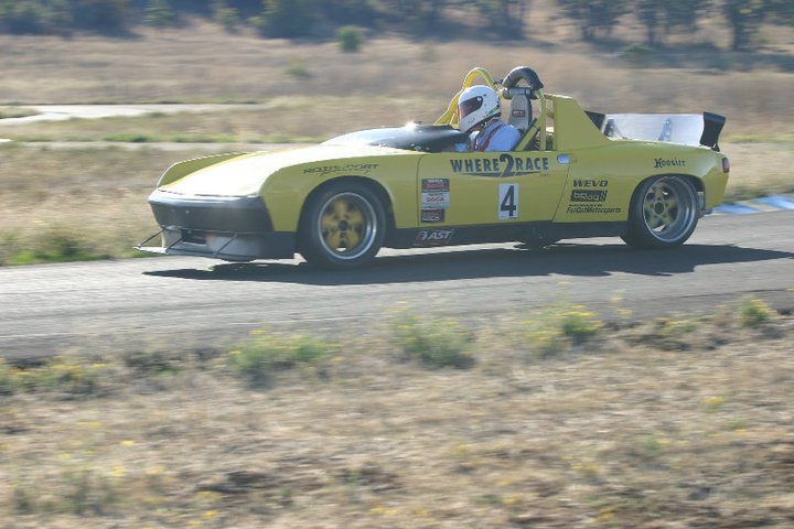

Attached ImageAttached ImageAttached Image[attachmentid=260
885
Pix of our setup.Took me a while to get resized.JJackson
jjackson
post May 25 2011, 05:56 AM
Post #33
Posts: 219
Joined: 5-October 10
From: maumelle, arkansas
Member No.: 12,246
893]
Forgive for pix in trailer.
Missed one.JJackson
Randal
post May 25 2011, 08:58 AM
Post #34
Posts: 4,446
Joined: 29-May 03
From: Los Altos, CA
Member No.: 750
QUOTE(jjackson @ May 25 2011, 04:56 AM) *
893]
Missed one.JJackson
Nice front and rear splitter / spoiler. That rear spoiler is big!
And it's great that you can load the car on the trailer without taking off the front splitter.
I've got to find someone with one of those long contour bars so that I can get the bottom bit right when I do mine.
Given that your using plastic, I guess you could glue on end plates or just bolt them on if you wanted.
End plates keeping the air on the spoiler surface have got to be helpful.

Can you give me details on the swirl fuel tank you got up there in the front? Do you have a smaller pump in the tank?
-Britain

QUOTE(Britain Smith @ May 25 2011, 01:03 PM) *
-Britain
Its just a vented catch tank-At less than five gallons in a 10 gallon cell-we were still sloshing fuel out of tank and starving for fuel in extreme grip situations.Tried different amounts of foam and changed lean on tank-still had problem.Not using two pumps-just using 944 pump -low-even with sump portion of fuel cell-return line is at drivers side front-vent at passenger front-feed middle back.Wish we were allowed endplates.Yours look great.JJackson
BTW-Catch tank has to be drained daily (qt) and we still are running less than 5 in tank.
