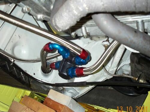

Oil lines for a front cooler.
You need metric to AN adaptors at the OEM tank
and at the scavenge side of the motor.
Here's a pic of the Troutman thermostat & line routing
