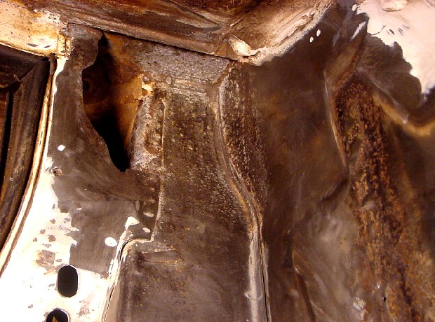

Engine bay is clean of grease but looks 30 years old. I would like to get it looking like a newer area. How do I go about dressing it up? The pad between engine and drive seat is falling off the wall. Any and all tips appreciate. Thanks,

get rid of the padding in the engine bay.
it's a water trap and usually the firewall is rusted through at the bottom of the pad.
then, remove the engine, get the engine-comp sandblasted and respay it with the original paint.
voila!

A couple of cases of Berryman's brake cleaner will leave your engine bay ready for paint without the "aftermath" of mediablasting. Just do it in a well ventilated area and preferably with a chemical filtering mask.

No, not really. Get a 3M bristle stripper for and angle grinder.

just prepp it thoroughly and take care of all rust first,
then repaint ...
(IMG:style_emoticons/default/agree.gif) Stripped mine and it actually went pretty easy.

Engine bay clean up tips:
Remove motor
Degrease all surrounding metal
Clean - prep - repair the newly found rust

I had mine "Line_xed" it looks awesome, and kills the sound alot too.. It also kills the battery box rust issues, as it seals the engine bay for good.. I also did both trunks and the passenger compartment.
