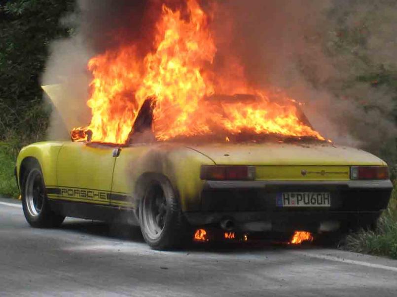

Seeing the picture on the right in another thread prompted this question...I think I'd have a very hard time seeing my 914 burn, I've known her longer than my wife and kids, for under $200 it's a "must"...
