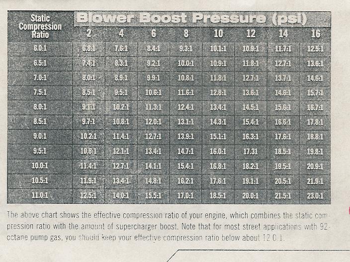

Attached Image..and then add in some un-natural aspiration (boost) and compression can go to nirvana (IMG:style_emoticons/default/evilgrin.gif)
Marty
