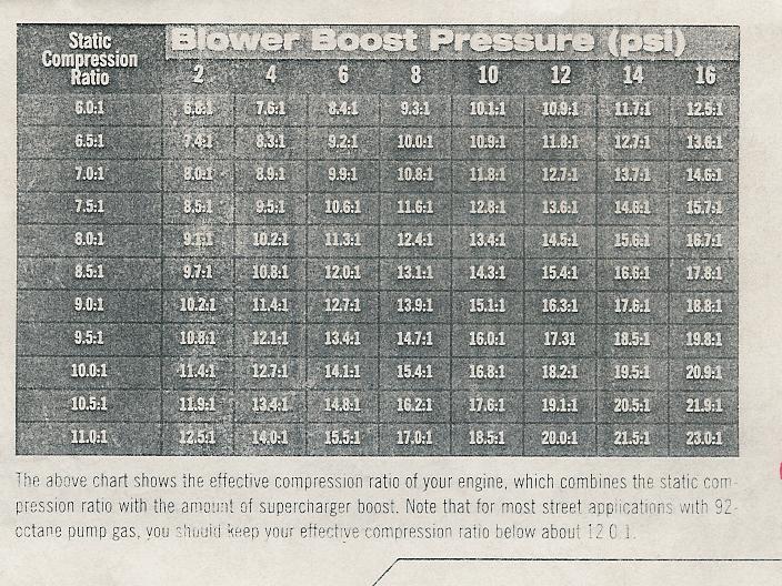

Click to view attachment..and then add in some un-natural aspiration (boost) and compression can go to nirvana evilgrin.gif
